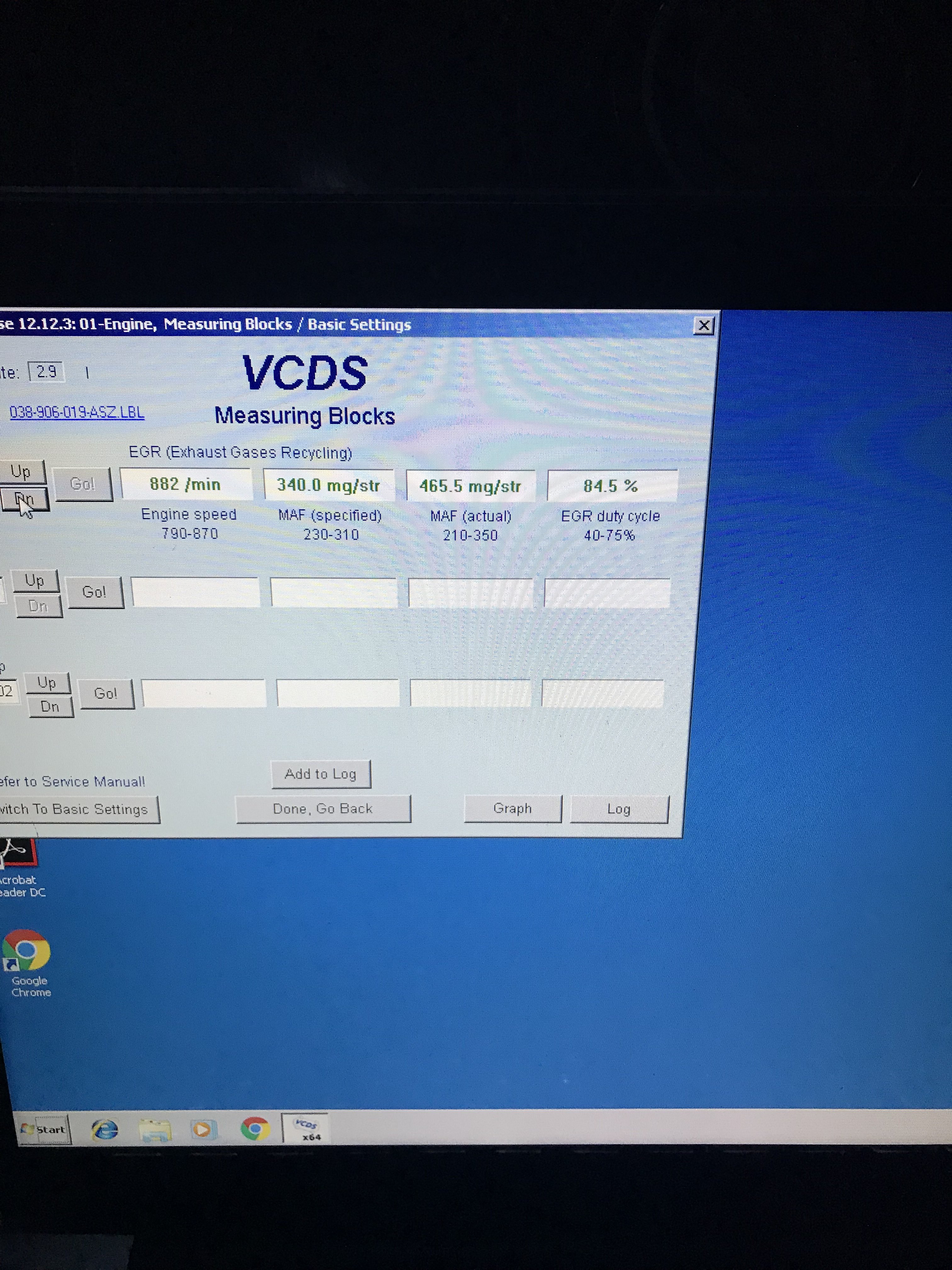

Ive scanned the car  with VCDS which returns no fault codes. I did notice that the MAF readings aren’t synced and are both out of the ‘range’.
MAF specified: 340mg
range: 230-310
MAF actual: 465mg
range: 210-350
These values are at idle.

I'm a bit surprised that you're not getting some sort of "MAF - implausible value" reports.
Your MAF may well be knackered, try disco'ing it and see if it still runs the same, failing that have a look at the fuel temperature sensor in the fuel filter housing, they commonly fail as they age and are rarely replaced.

Unplugging the MAF strangely makes no difference to how the car drives?
It drives perfectly apartly from the issues I mentioned in the first post!
