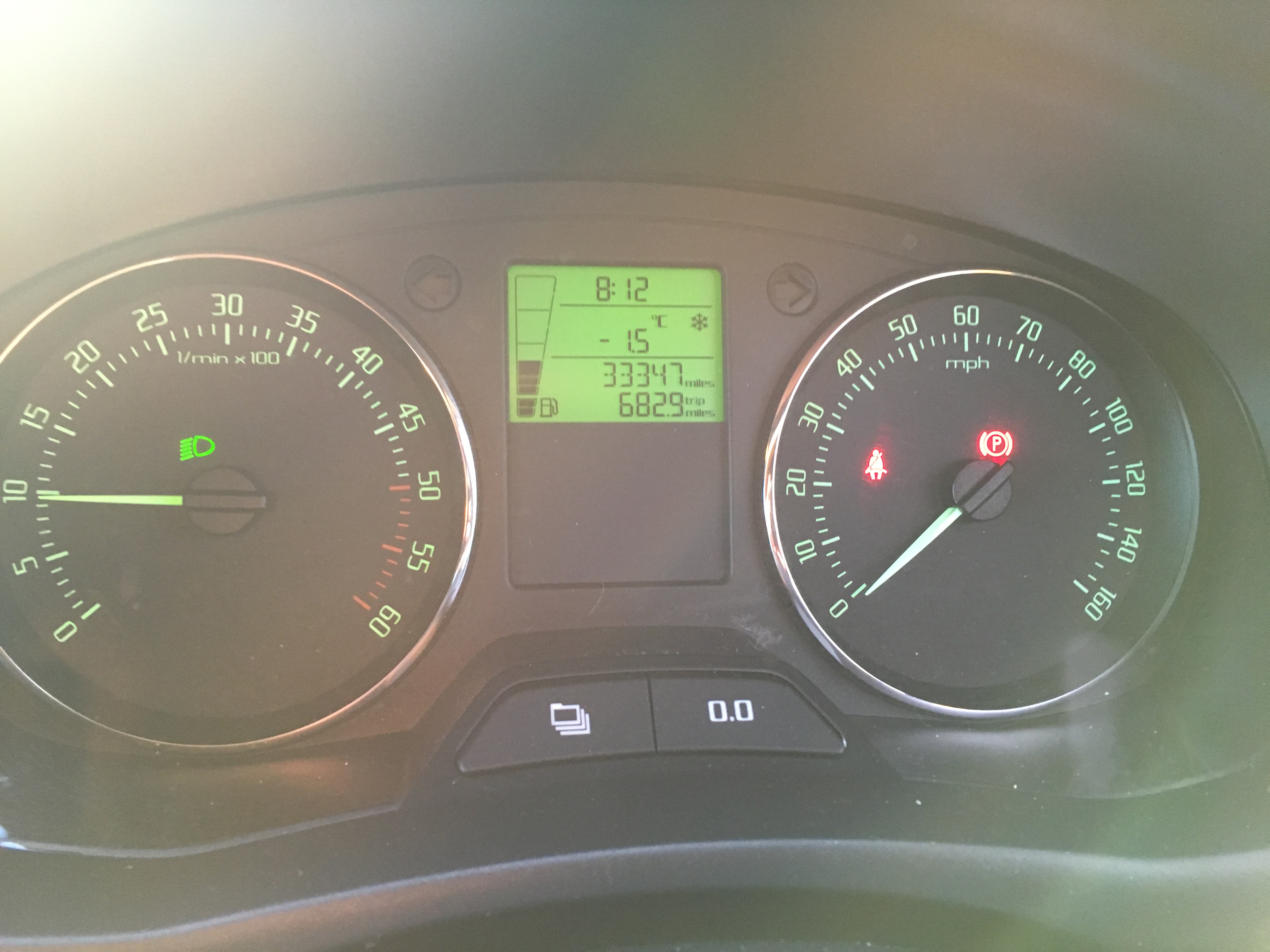

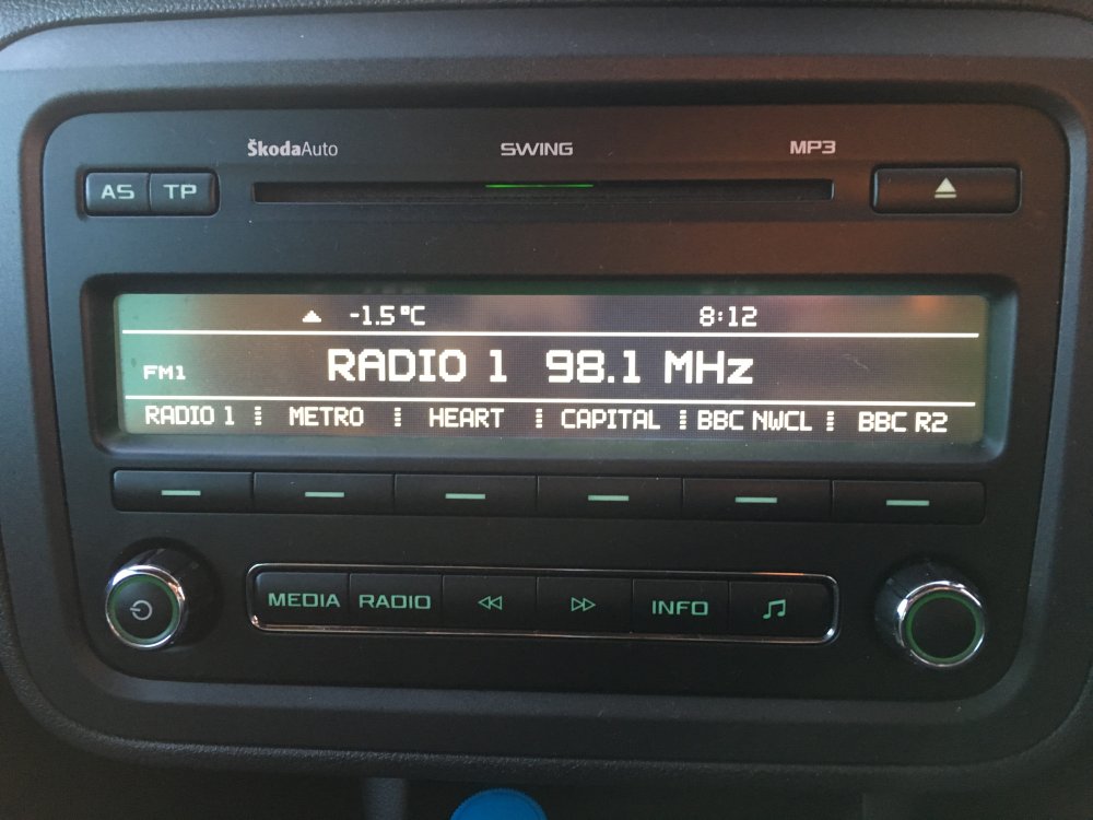

Here is a picture of my clocks and head unit if it helps.
Fitting either of the above units won't be a problem, it should just be a plug and play.
