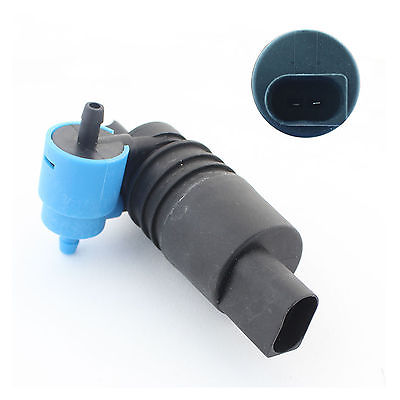

I'll be needing one of these should said pump have given up the ghost?
Something like that, I say that as mine is similar on a 2006 model but definitely not the item pictured.
If you want to pull the pump you'll see the part number embossed on it somewhere.
Expect to pay a fiver from a scrappy, most VAG donors should be good for a replacement so don't stress if you can't find an Octavia. I don't know what a new item costs, >£30?

I've checked all fuses but they seem fine so I've ordered a new pump 1T0955651A for £7 on eBay, worth a try for that much.
