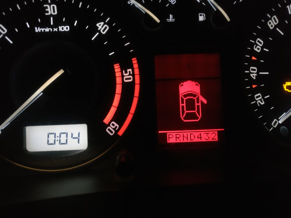

Car was not moving all modes at a selection

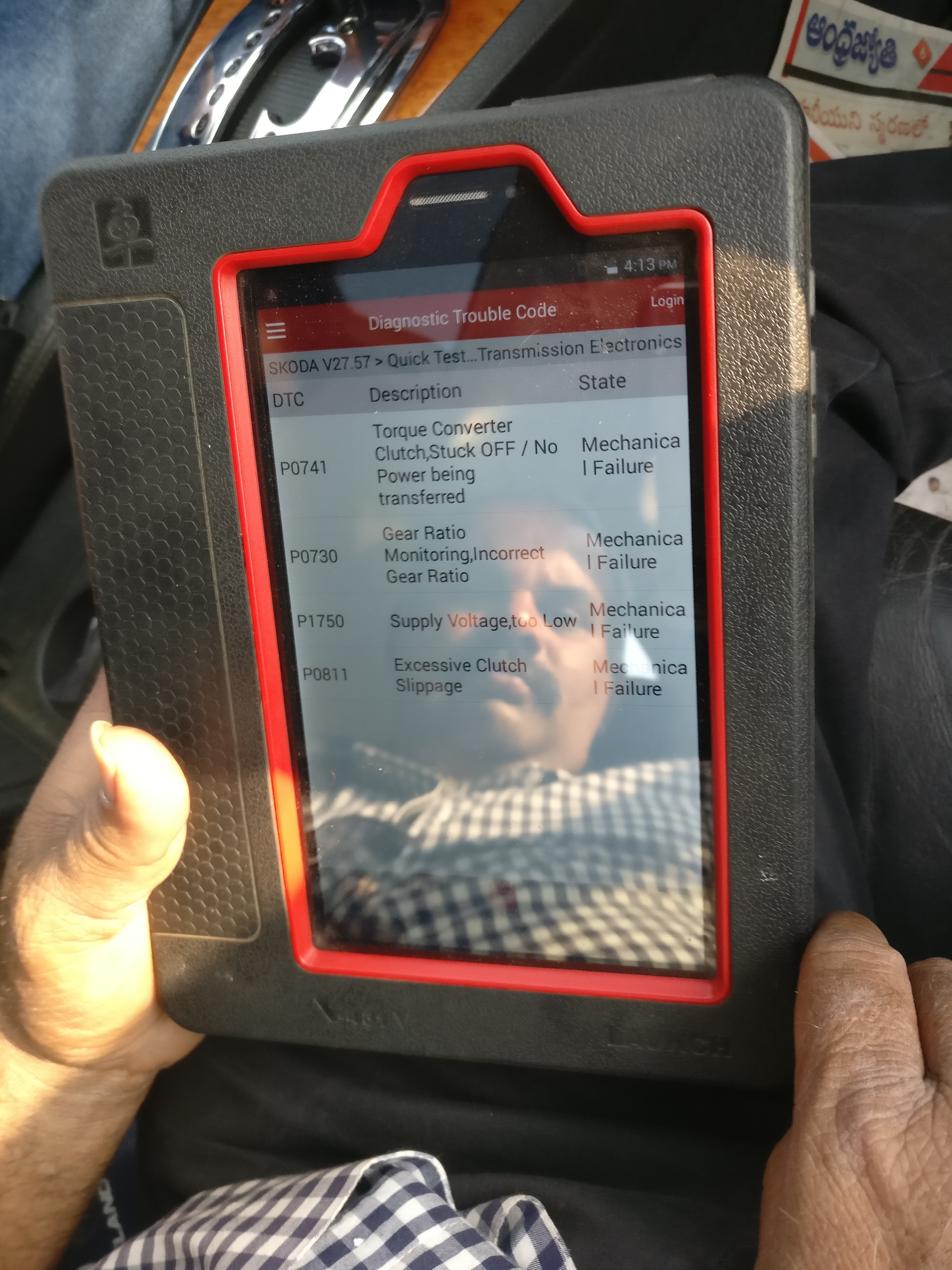

Get it scanned.  Note that no Superb MK1 has DSG gearbox - they are all traditional torque-converter automatics made by ZF.
Just scanned bro
Oh sorry bro ...i don't know...iam new ... Kk it was not dsg
Looks like a lot of faults for one box.  Maybe you have an electrical problem instead of a mechanical one.
Check right hand footwell under carpet (UK driver side, EU passenger side).  The TCM module (gearbox computer) is in a plastic tub in the footwell. The footwell often floods due to the many design faults in this vehicle, corroding electrical connections and damaging modules.
Failing that, check fluid level is correct and if that doesn't help, prepare for a big bill :(
