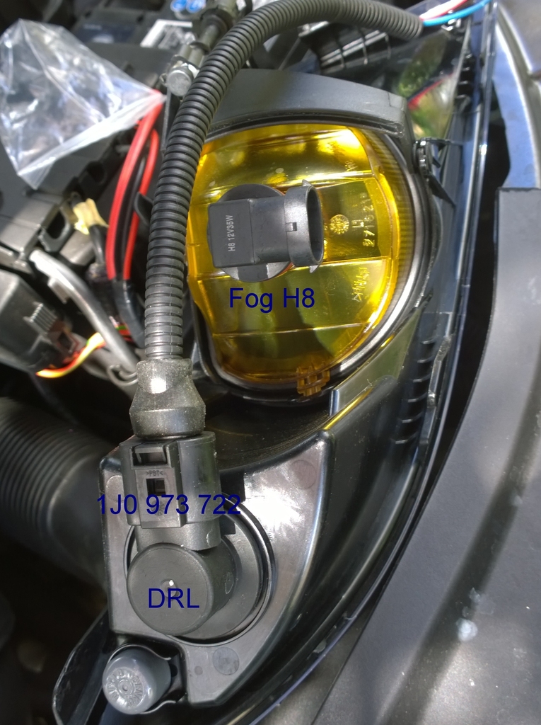

Can anyone show me how to seperate 1J0 973 722 from the DRL as my bulb has melted the inside of the DRL and the bulb is welded to the housing.
Push the plug on as if your refitting and push the locking tab back at the same time and pull it off.
Thank you hutchysrs50 will try tomorrow. do you know if you can buy the DRL housing onits own.
