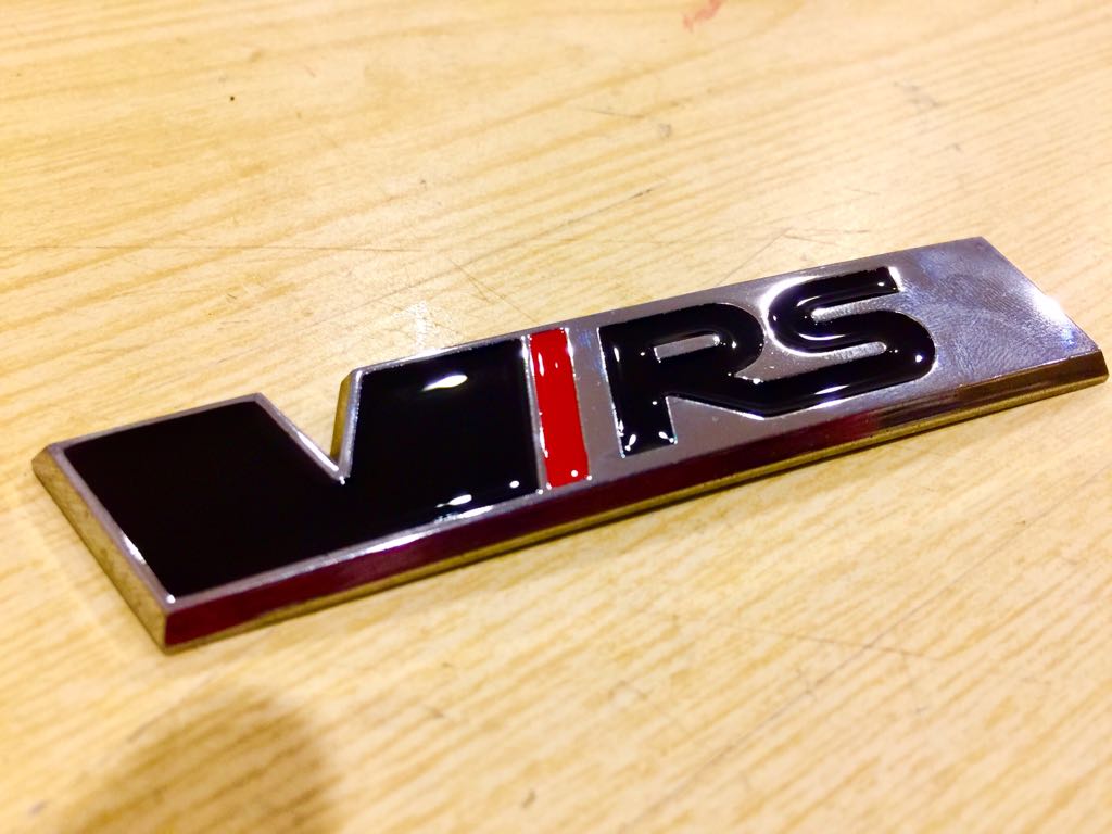

I have started by debadging the back of the car, which looks great. I have taken the badge from back, recoloured it and am now gonna place it on the front grill.
I am next looking to make a same coloured grill and remove the front badge and dip. I have also thought of colouring the outer grill as VRS green or bright red, haven't decided yet.

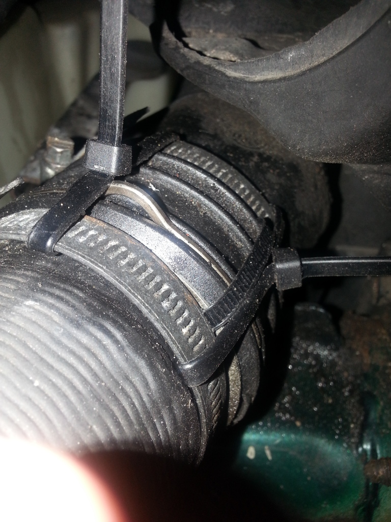

So this morning on the way to work I had heard a wonderful bang and then loss of power...
After quickly pulling over and opening the hood up saw the boost pipes had popped off. Put them back together and basically the C clips are just there for decoration at the minute, got no strength left in them.
I was planning on going for the solution in the uploaded image for now, anyone had any experience with this solution?

Think self tapper through pipe more common.
Either one will work fine.  :)

Ah yes, I had also heard of this one. Thank you very much, I will keep this in my mind in case I have the issue again aha.
Cheers!
Fitted the fix in the picture above and blasted it for a few miles, no issues whatsoever! Gonna complete this fix on the rest of the pipes and hopefully remove all boost leaks! :D
