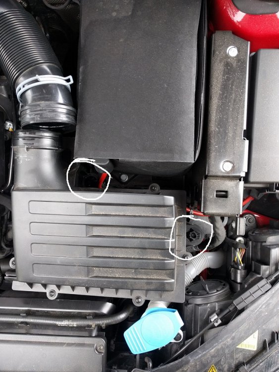

to remove airbox disconnect the flexipipe, pull out vacuum hose from bottom left corner of airbox then pull the airbox up on the rubber grommets (circled) there is a third one of these underneath. some tugging required!!

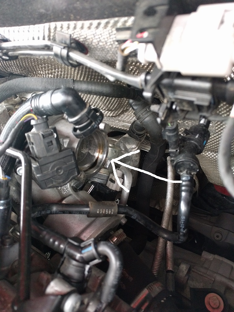

this gives you a good view of the clutch delay valve (dotted arrow) and also the boomba racing shortshifter i had already fitted before (black arrow)

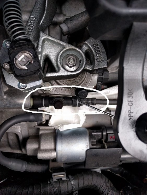

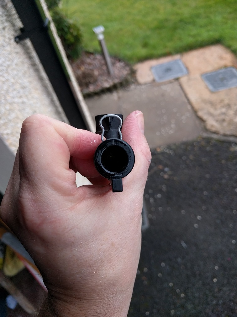

I put some kitchen roll and levered up the 2 clips using a thin screwdriver (make sure you elevate them completely - 2 clicks, but dont pull them off!) Then panic a little as DOT4 brake fluid goes everywhere.cdv.jpg

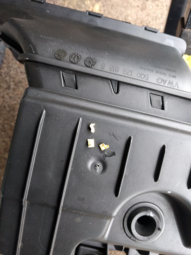

this pulls out easily, remove the bleed nut at the top and then you can poke out the yellow valve inside (i couldn't get it out in 1 piece so broke it up)
replace the cdv assembly and push down on the clips you levered up earlier with the screwdriver. make sure they go all the way down. Panic a bit more at the amount of fluid that leaked out!

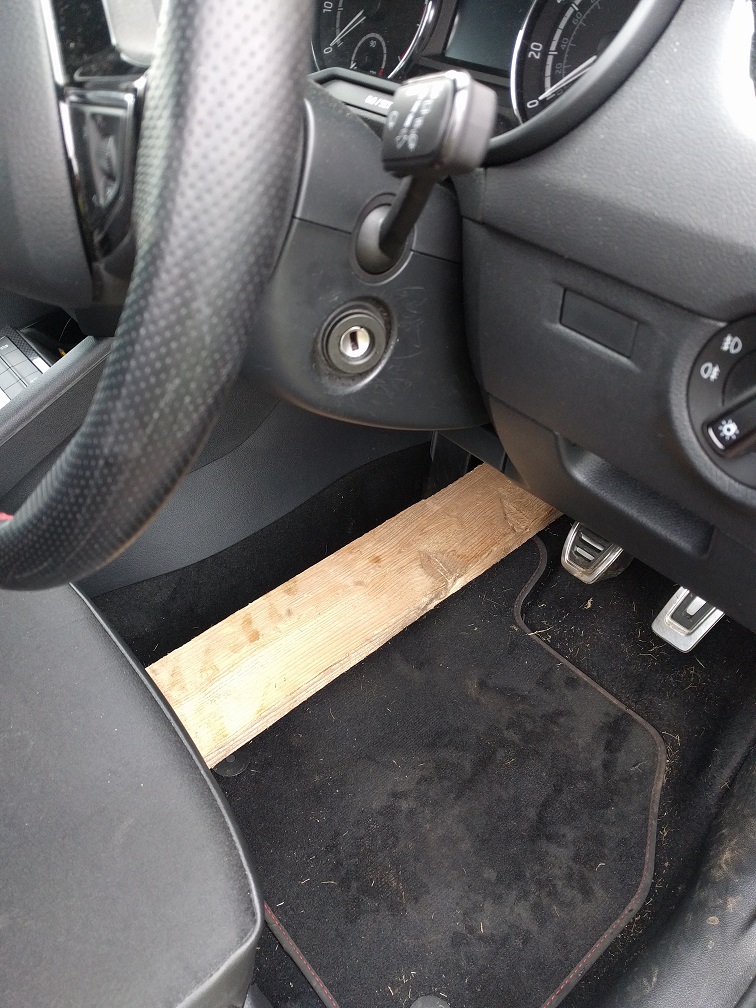

then you can bleed the system using a block of wood or if you have a speedbleeder use it (M8x1.25mm is the size needed). I topped the brake fluid reservoir up with some DOT4 (3 quid from local autoparts). you don't want the reservoir to empty as this entrains air and will result in the system needing rebled again
when wood is positioned as so, uncrack the bleed valve slightly and airbubbles should come out. be careful as it splashed into my face. tighten bleed screw again, remove wood, pull up clutch then repeat a couple more times until no more air out

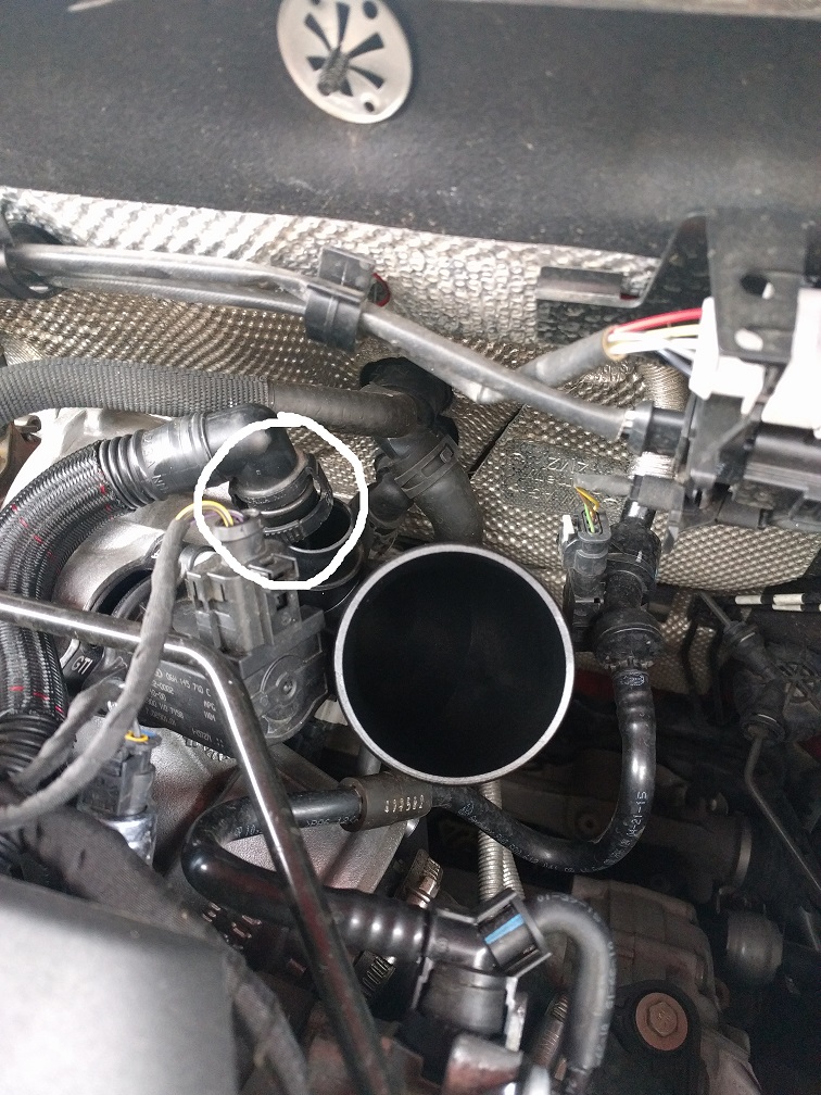

Remove the flexi pipe by undoing the jubilee clip and pulling it off the turbo elbow intake. squeeze and pull the hose (white circle) off the assembly - it just pops off

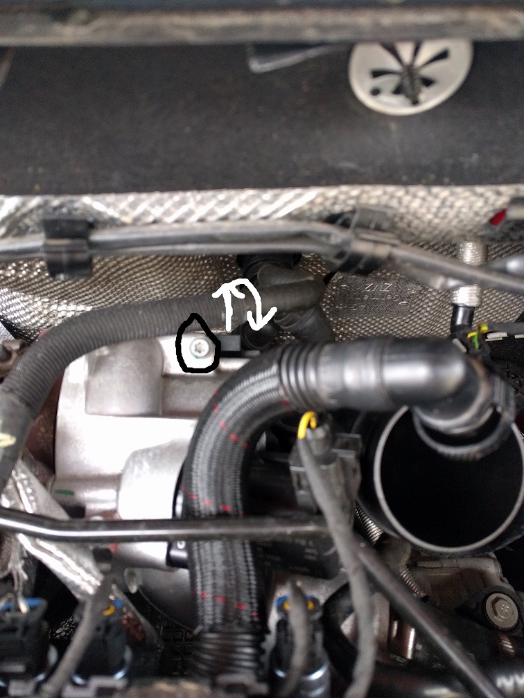

Undo the single silver torx screw (black circle) that holds the turbo intake pipe in place. to the right of it push the black tab shaped bit down and away from you (white arrows) it only rotates about 1/8 of a turn. this unlocks the turbo intake and you can pull it sideways to the right to remove it
this leaves you with the stock intake completely removed (white arrow)

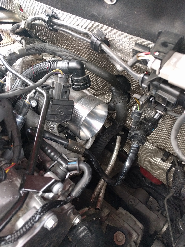

Fit the TT metal venturi intake piece into the turbo - push in to fully seat it then rotate it to lock it in place. this took a bit of effort

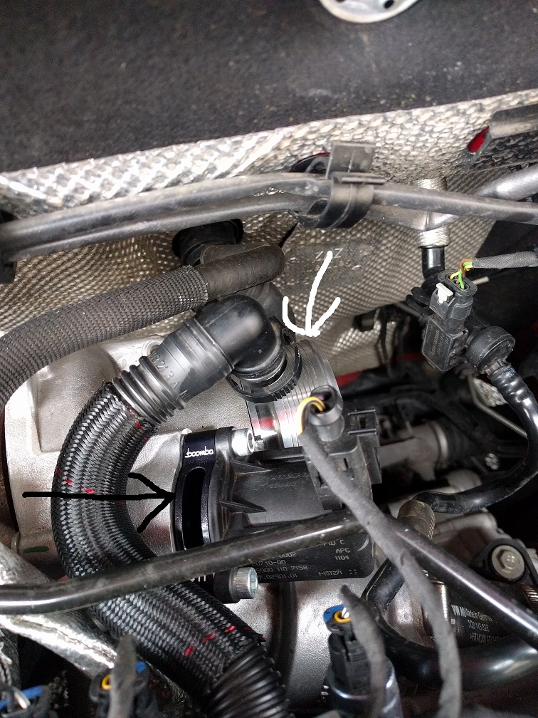

I had been worried that the intake pipe (white arrow)  wouldn't fit beside the turbo muffler delete valve (black arrow) that i had already fitted, but there weren't any issues

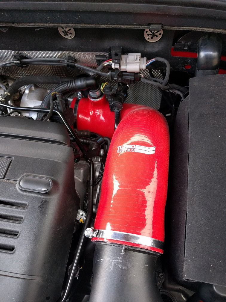

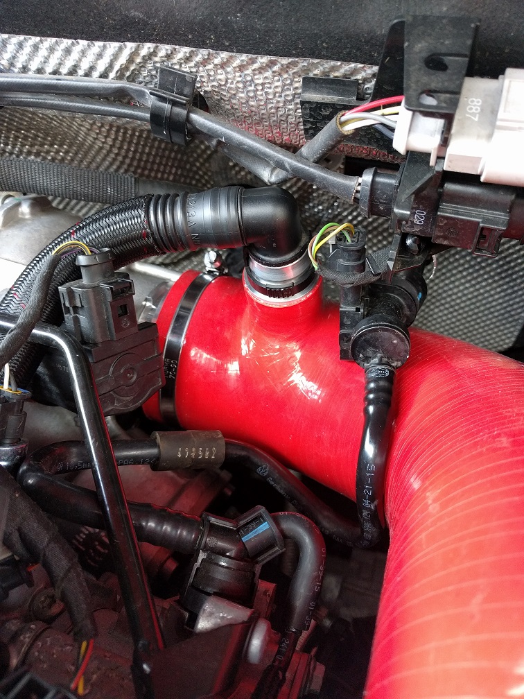

top tip#2 - remember to thread the jubilee clip onto the intake hose BEFORE mating it with the new venturi metal bit of the intake. reconnect the hose on the top (just pushes on) it is a bit of a stretch but not too tight. it took some manoeuvring to position the  wires/black assembly thing at the elbow of the intake pipe (not sure if they could go below the red pipe or not, but this seems to have worked for me)

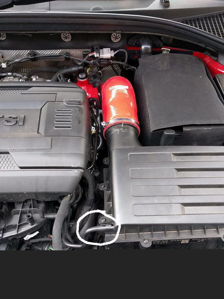

reattach the airbox onto the 3 rubber grommets (i used a little silicone spray on these which made it easier) feed the jubilee clip onto the airbox end of the red intake pipe, mate them together and tighten the jubilee clip
remember to re-attach the vacuum pipe to the lower left corner of the airbox (circled) and enjoy!
