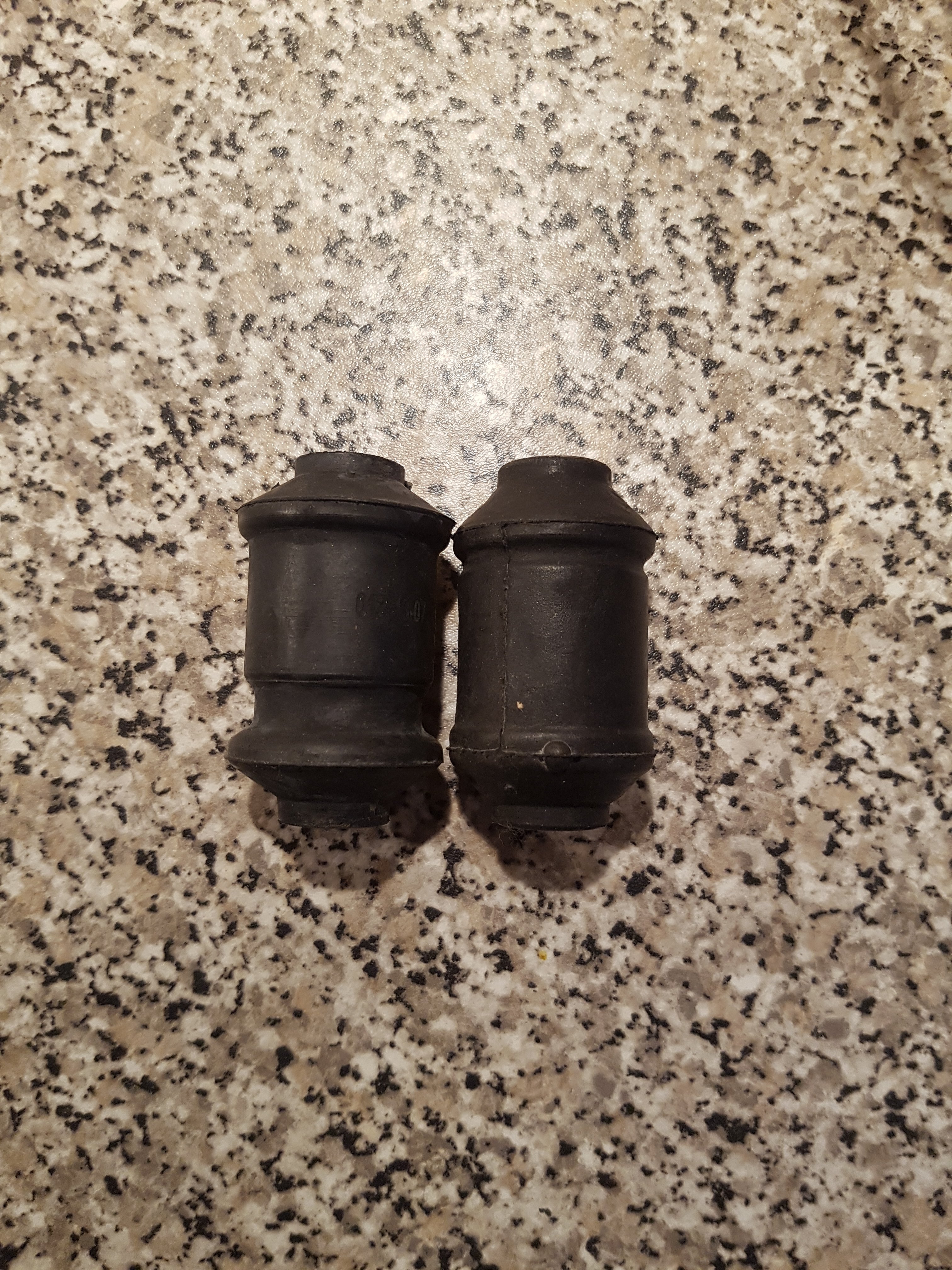

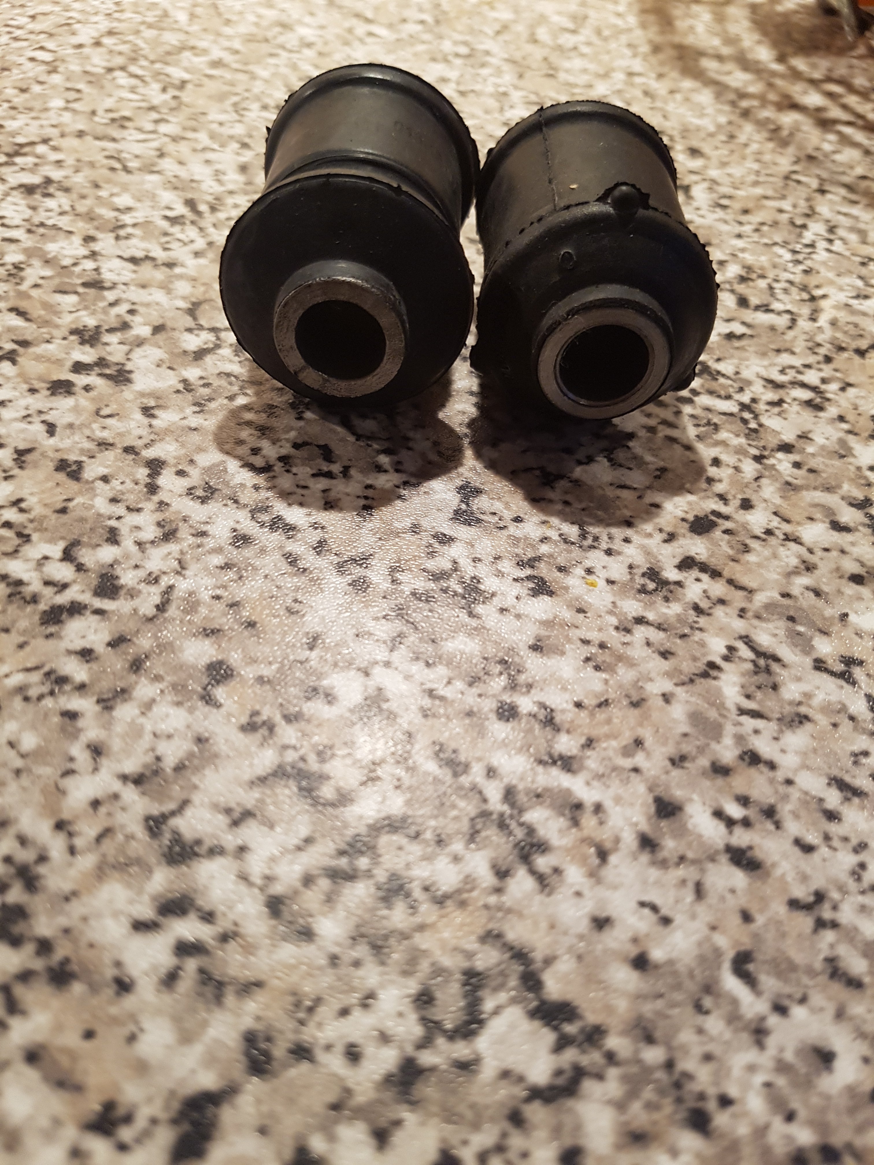

Ok been thinking i'd like to upgrade to some poly bushes but can't really find anything. So i looked into Mk1 Golf front bushes and they are very similar to the Felicia ones.
Felicia on the left Mk1 Golf on the right.
I think that's close enough for my liking so i will get some Mk1 Golf poly bushes in the near future and try them.
