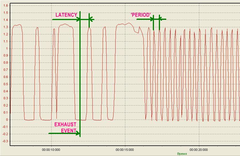

  13. I am blown away 😅 by the fact that for you P stands for 'professional' and it has "pin protection", whatever you think that means. In fact it has a few extended features. What can I say? Throw a party. Put a sticker on your bumper. Whatever makes you happy. By the way, it is Mono-Motronic, not Monotronic. You are making a common mistake. In the context of our discussion about the possibility of 'measuring each cylinder', when you say 'period of lambda signal' in fact you are referring to the LATENCY of the lambda probe (see photo). Moreover, you are making the assumption that the lambda probe can not keep up with the speed of cylinder exhaust cycles. That is obviously wrong. Why? Because it would defy the entire purpose of a lambda sensor. The lambda sensor was created to measure the oxygen content for any engine speed. You can see in the attached photo how the signal can have also a shorter time of variation. At higher engine speeds the signal goes full high (~0.9V) or full low (!0.1V). That happens because the ECU has an integrator circuit followed by an operational amplifier connected as a comparator at the input port for the lambda sensor, not because the lambda sensor is slow. Slightly delayed with an average value of 0.25 s, yes. Not keeping up with the engine speed, not. We can go further into this discussion if you want and talk about the rate of signal acquisition of the ECU, but that is not the point. In conclusion, we can debate for days the theory behind closed loop emissions measurement, but to me it is enough you agreed to disagree that TP-6 has not an almost perfect precision. Are there better solutions? Of course, but none of them is almost perfect. I have mentioned the differential flow meter because the sensor is inserted in the fuel stream, thus measuring directly quantities of fuel in a certain amount of time. We don't have to guess anymore if the injector is acting properly or not. We just subtract fuel out from fuel in. By the way, I appreciate that you bring a more informed feedback from the home country of Felicia.
