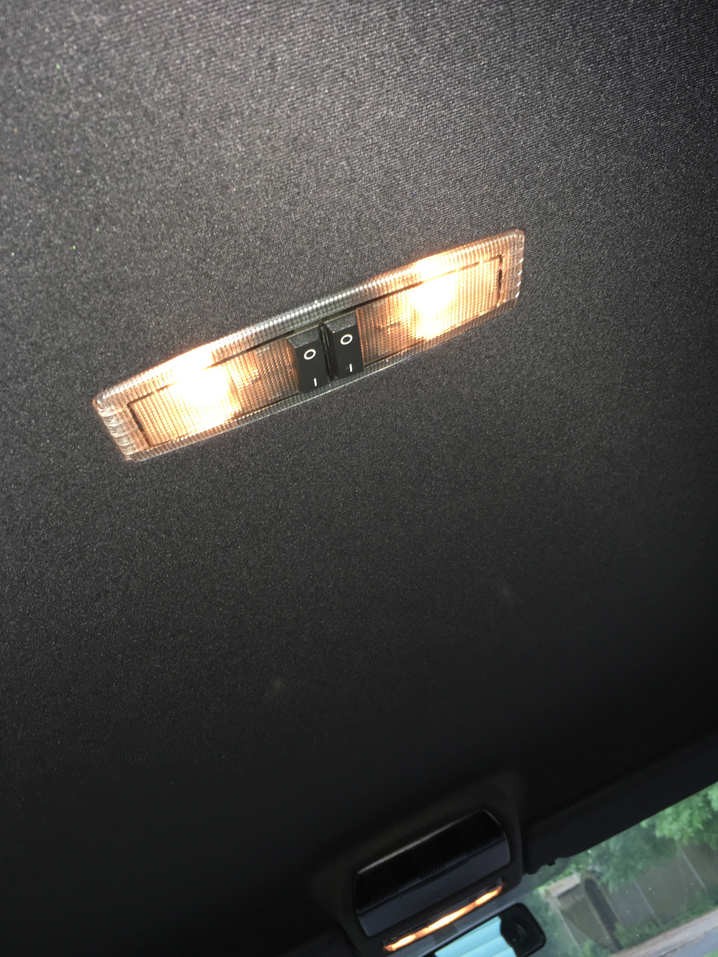

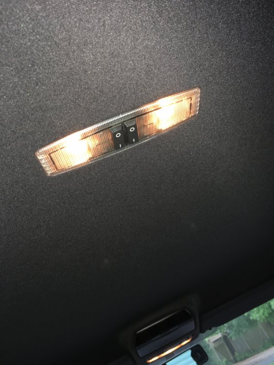

I did a rear head lining light, took the power from the front lamp, soldered to it so as to avoid cutting the loom.
i bought a Vauxhall light I think it was on eBay, cut out with the old headlining still attached, to be sure of getting the steel surround.
have you got any links for these?
eBay item 201940060982 looks the same but with white buttons. The key is to get the steel clip to which it mounts that goes into the headlining. Also be prepared to do some soldering at both ends because every car part has crazy custom plugs on it.
check the depth available with a pin at the desired location before cutting! Also make a template with some card before cutting the headlining.

Thats what ive seen done before!
Looks spot on
