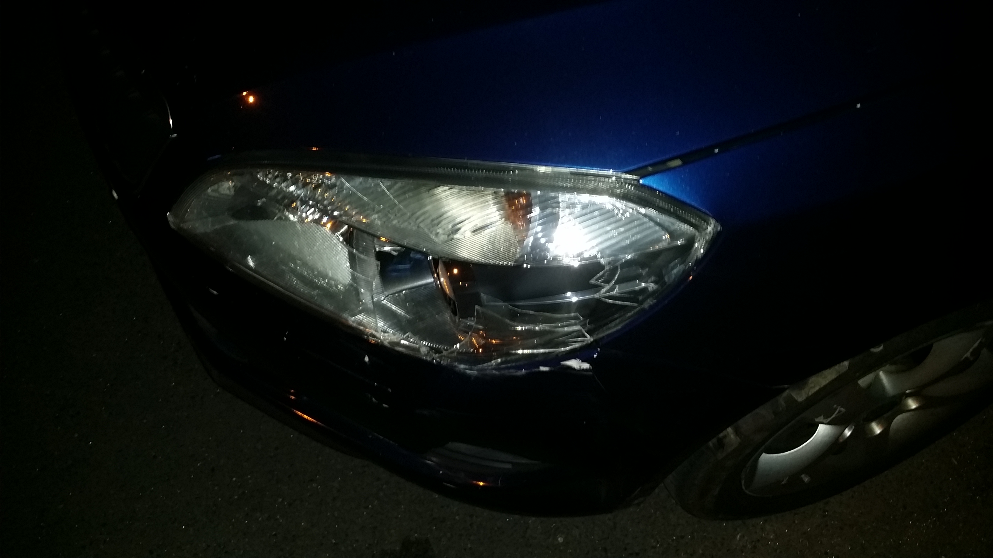

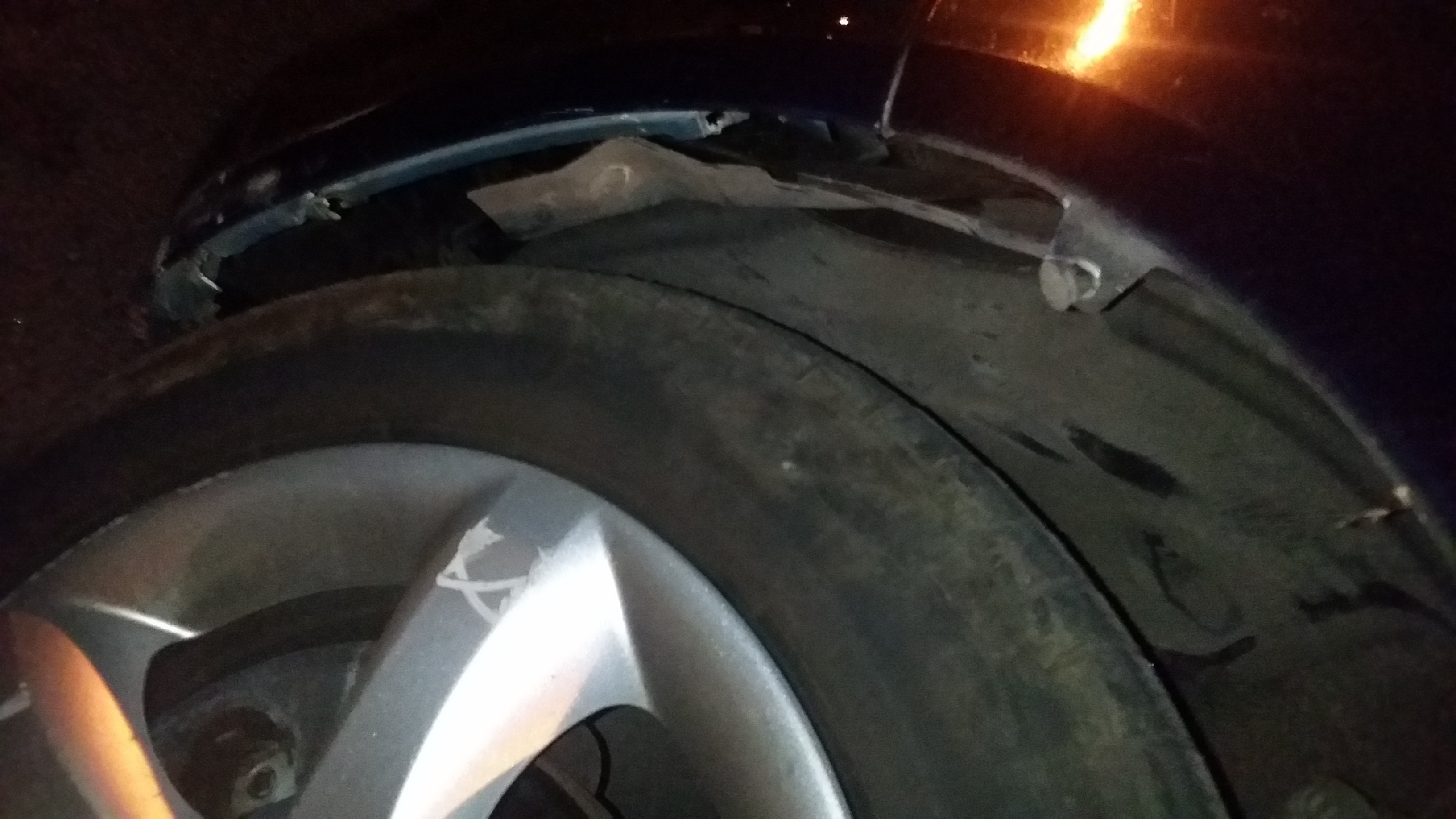

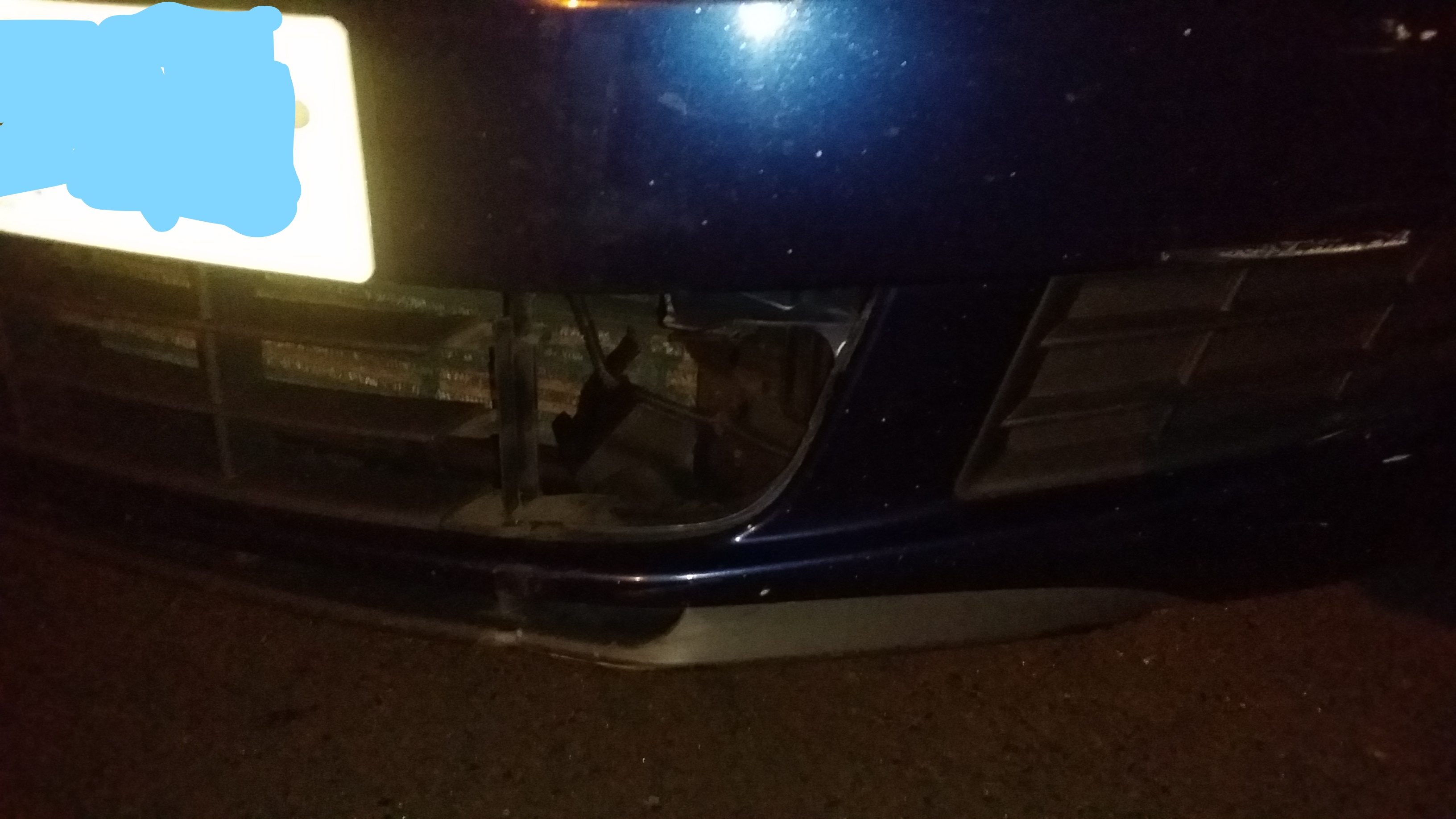

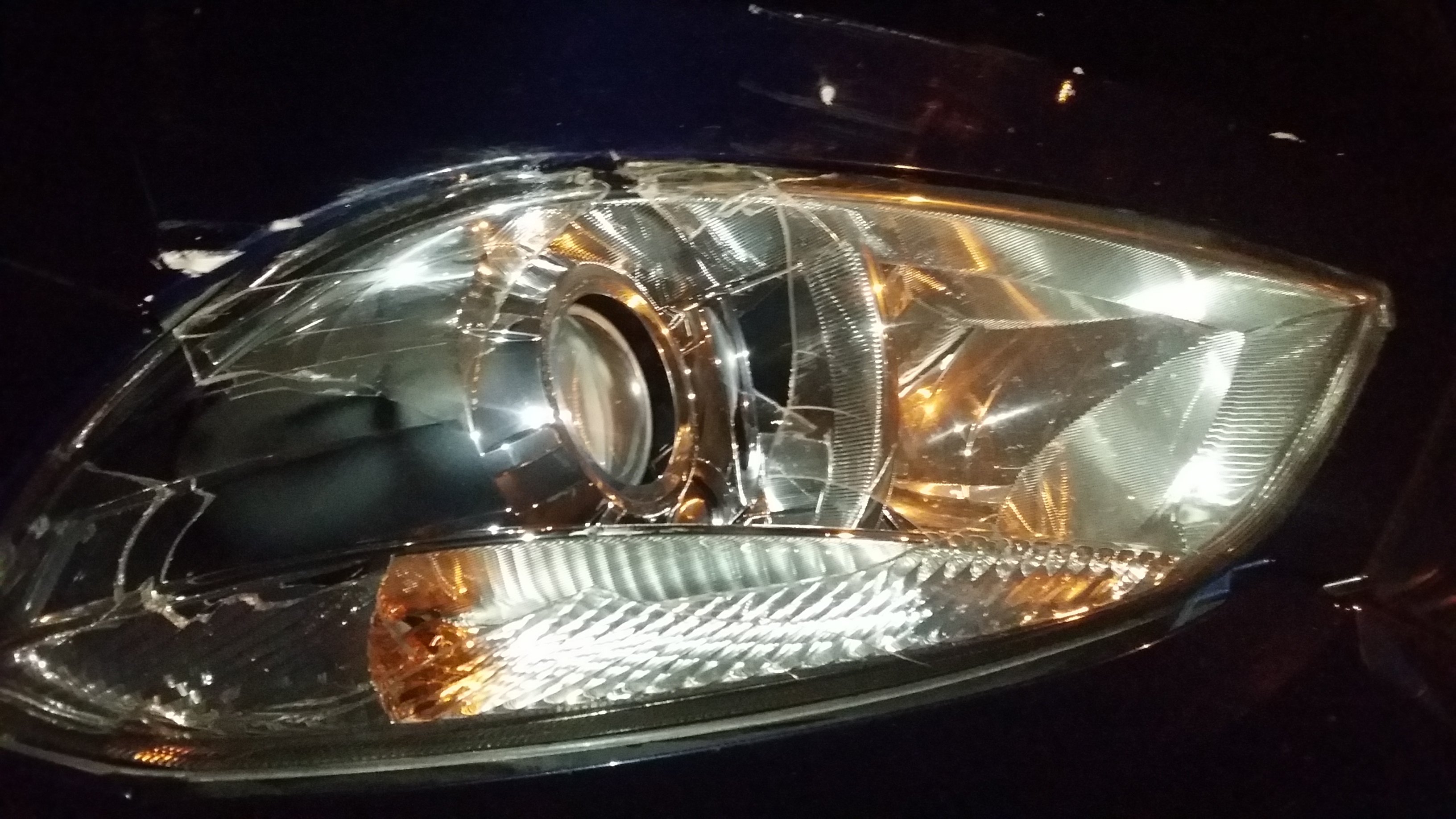

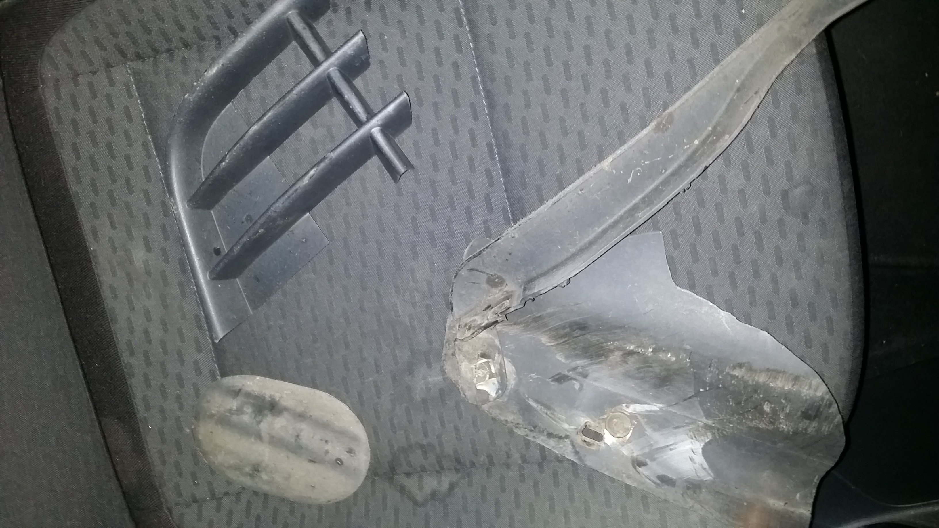

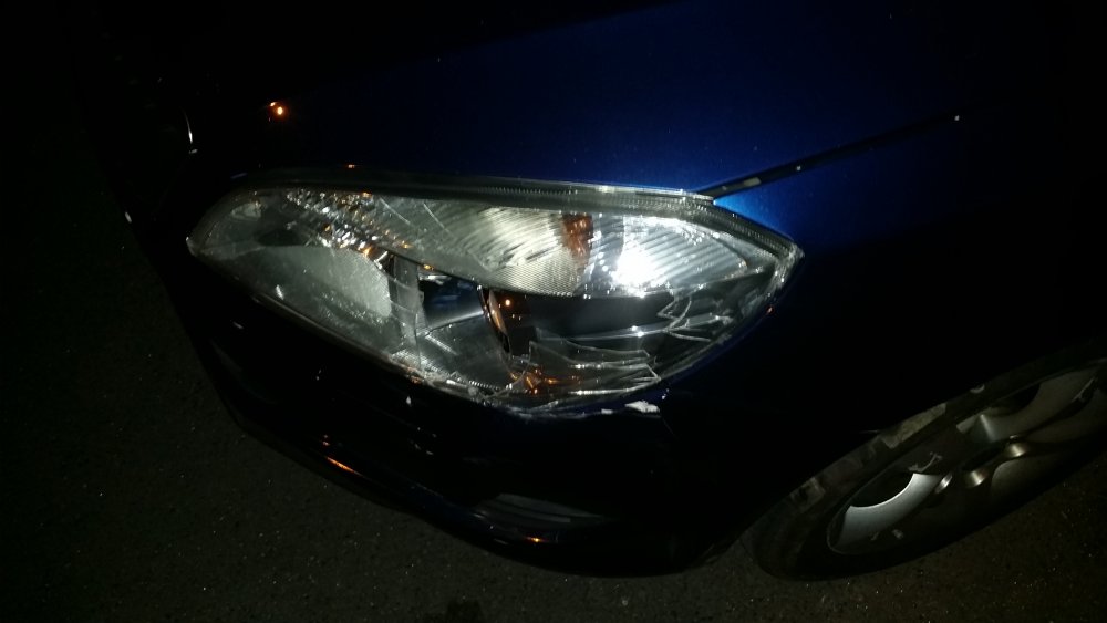

Main damage appears to be (1) headlight cover (lights work), (2) mud-guard for the tyre, not sure what proper name is, (3) some bumper damage, (4) plastic damage - bits came off but not sure what exactly.
I've been searching online and still I have no idea how much this is going to cost me - I've heard about car breaking, and just general car parts places. Then I can find someone to do the fitting I guess. And perhaps someone with a good eye to have a look and see what I even need first of all. I just want the car to be safe to drive and look decent - a few grazes and a small dent I can live with in a car that's done me well at 160k.
I guess what I'm asking is for advice on how to proceed. I can see near-side headlights on ebay and will call and ask tomorrow if they have that grill too. Any thoughts would be appreciated.

Make sure the wing/front panel are not bent or deflected from alignment as that will start the bill racking up! The wheel liner or inner wing is fiddly but should be easy to source second hand. Headlight too but be sure. Sometimes, new from places like eurocarparts or carparts4less can be better prices then breakers yards AND the deliver for free. (Look out for discount codes, too). Looks like the bumper grill insert is damaged too. Quite a cheap item from the main dealer.
Did you do that wheel scuff at the same time? Might have knocked out the tracking or damaged suspension. Uncorrected tracking will very quickly kill your tyres so worth getting straightened, straight away!
To be honest, a low speed crunch can potentially cause quite a few grands worth of damage and without an inspection, its just guesswork as to how much you may have done. You might be "Lucky" and have superficial damage.
