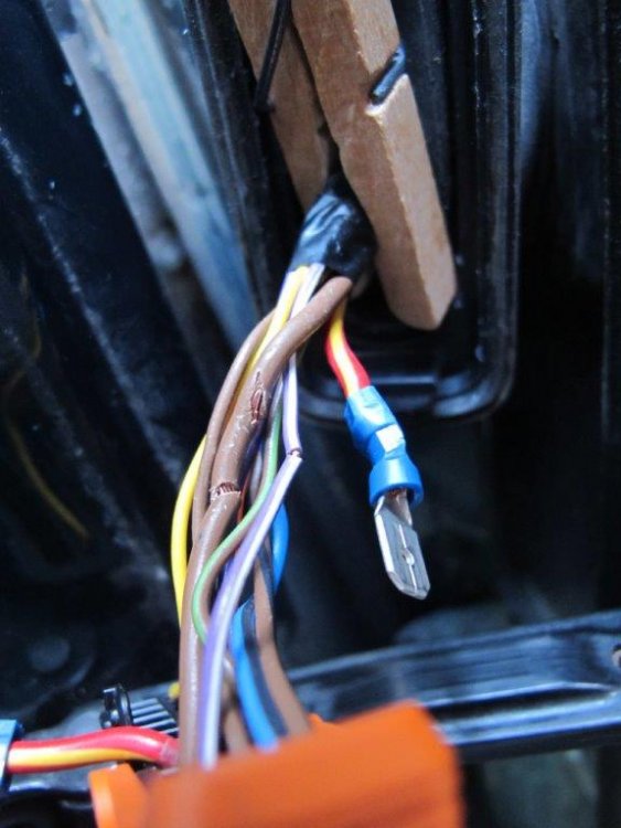

Well done spot on, wiring in the door harness to the main plug on the door frame.

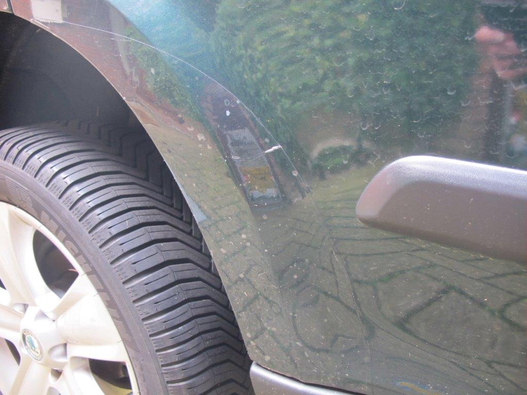

The wife had the Yeti repaired by an insurance repair company close to Dereham Norfolk after a lovely chappy drove out of a little car park lane straight into her drivers door denting it badly.
After the repair she said sometimes the windows will not go up or down but it was very intermittent and the red light at the bottom going off when the door is fully opened.

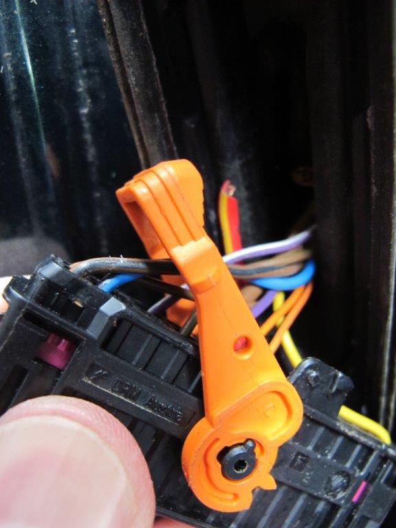

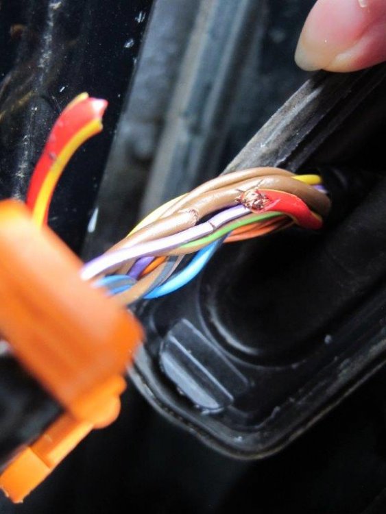

Took the boot of the main body of the car and unplugged the harness only to find two cables partially cut and the main thick brown yellow cable cut in two? The repair company had just twisted the two wires together and hidden it with black insulation tape leaving the others just ready for a short to the door frame?
Had decided to use a tight fitting spade terminal to repair the cut wire as there was no excess to make good. Taped carefully the other two then bound the complete harness up with tape. VCDS put back on and all errors have now gone.

These were the photos taken off the insurance repair job. Would never go back there but of course the insurance company force you to use their recommended repair agents.
Just about three inches of black insulation tape was used to cover over the broken cable which had just been twisted together by the chap in the repair shop.
Never thought to check on the wire harness once we came back home.
