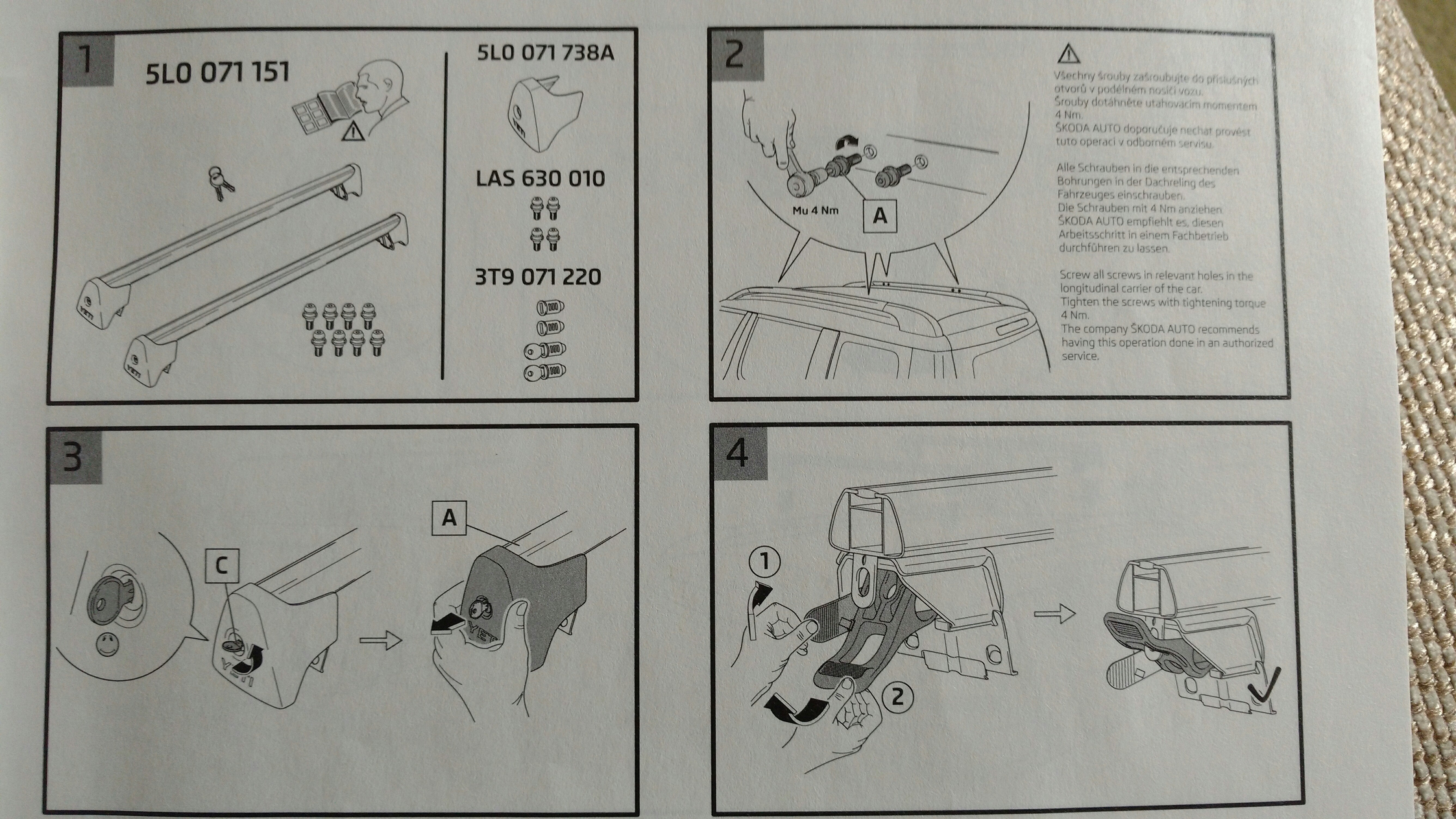

I am awaiting the garage to get back to me after Skoda Technical can confirm which size allen key is required (not supplies with kit) to be used on bolts supplied to mount and dismount the Bars,
However I am not yet convinced it is an allen key
I did get a manual with the bars however the instructions were in my opinion very poor and for a tool not to be included is penny pinching considering the asking price.

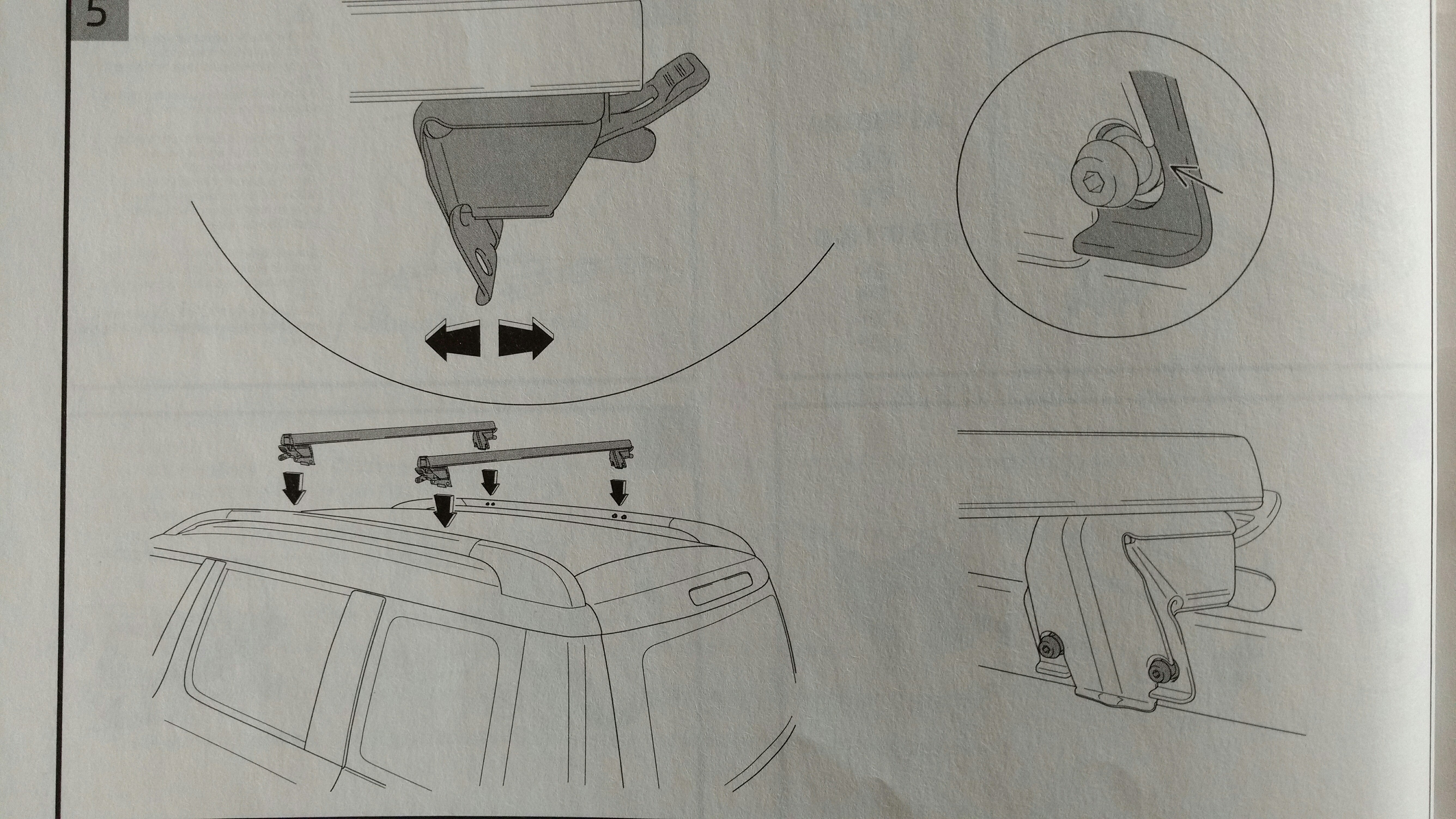

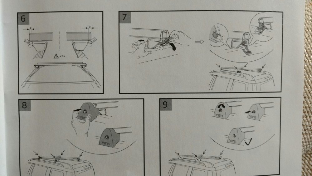

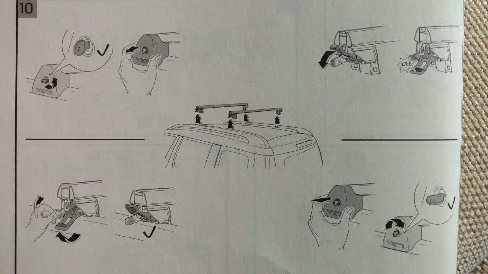

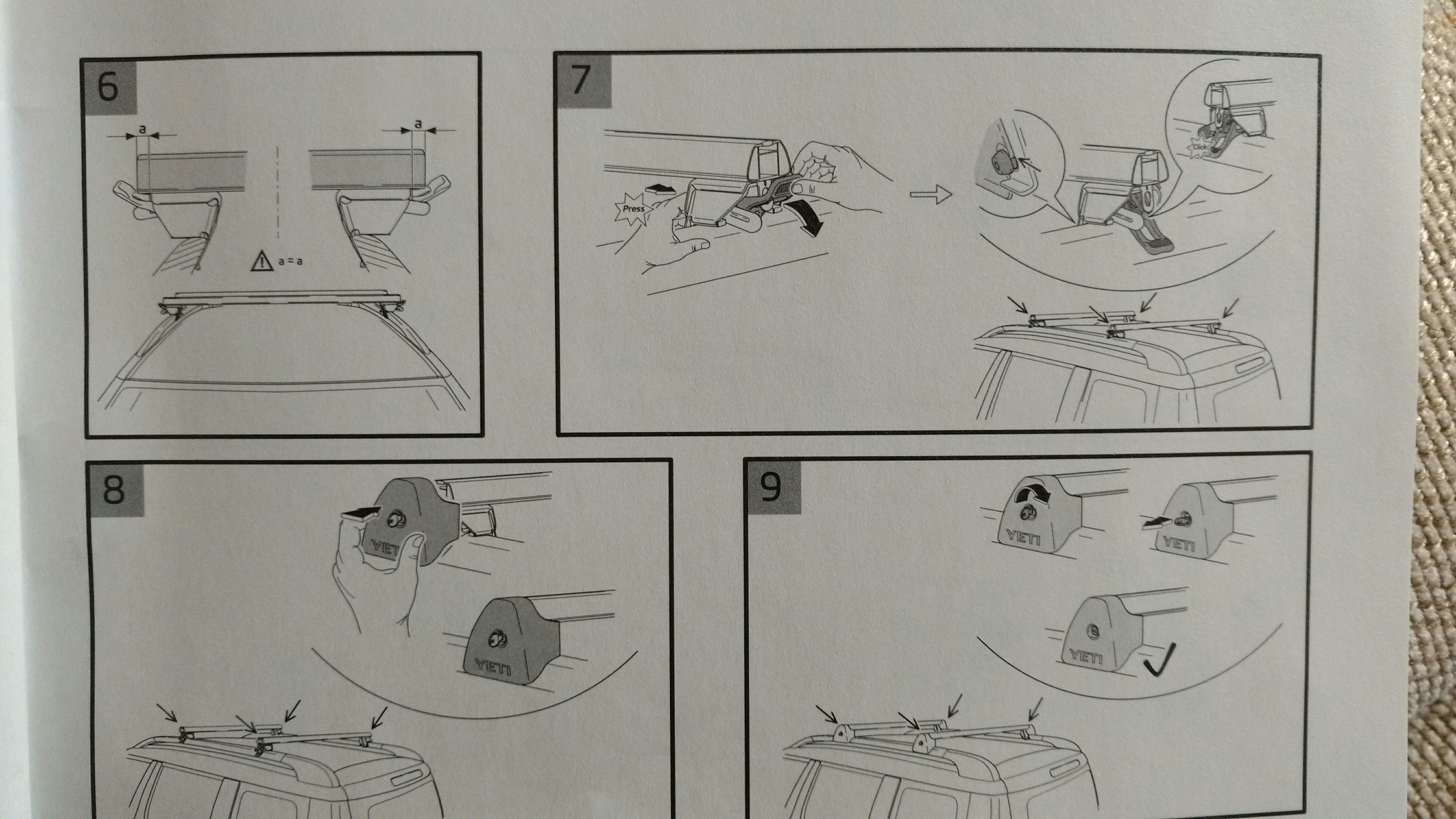

Yes I have the instructions, 2 more files to follow
Not 2 files, here is the last,
I've had a set of these for several years now - just need to ensure you slide forward the bit which engages with the silver retaining bolts (when removing)
As previously stated these bolts are single use and not designed to be removed / re-fitted.
