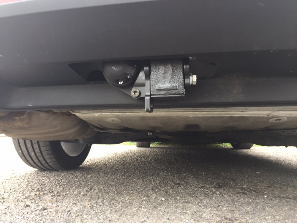

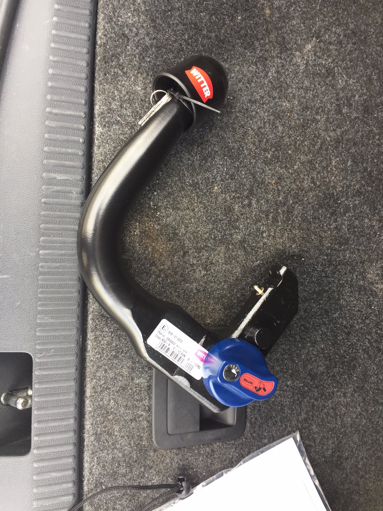

I have now fitted the above tow bar and it fits perfectly.
I hooked the trailer up today, everything works as it it should but I have a trailer rh side lamp warning.
i also don't have a trailer displayed anywhere on the dash, just a green 1 with arrows above it when the indicator is active.
What exactly should happen in the display when the trailer is attached?
it was coded using the adaptions thread on here.
It didn't have tow bar prep so I fitted the genuine skoda wiring.
many thanks
