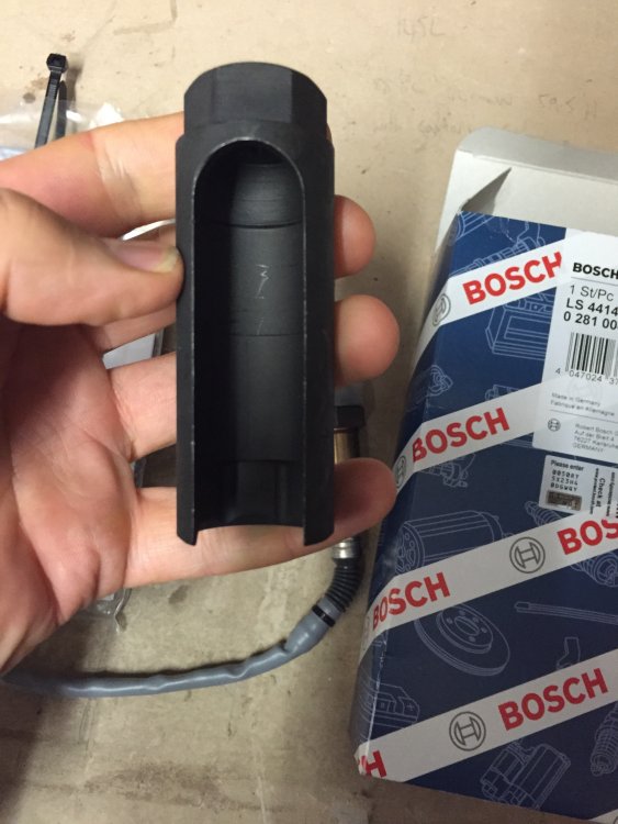

Bought the correct sensor off eBay for £69 (Bosch) and changed earlier today. I had to buy a lambda sensor removal socket which was £6, also off eBay. There were some second hand sensors on eBay ranging from £25-45, with new only £69 I opted for this.
Pretty straight forward. Hardest part wash undoing the electrical connector from the old sensor and threading the new one through the back of the engine bay in the clips.
The old sensor was a little stubborn coming out but nothing too hard. Came out fairly quickly with nice firm controlled use of a 3/8" ratchet and short extension bar to give a bit more clearance.
Took a few pics that could help somebody down the line. I'm no mechanic but always willing to have a go myself. If it helps somebody else save time and money I will be happy.
The socket enables you to get it over the lambda sensor with the wire connectors attached. Simply un clip the heat sheild from around the wires near the sensor and you are ready to remove the sensor.

Thanks mine is saying sensor 1 bank 1 so I'll try that one first. Thanks for the pics too they was very helpful.
