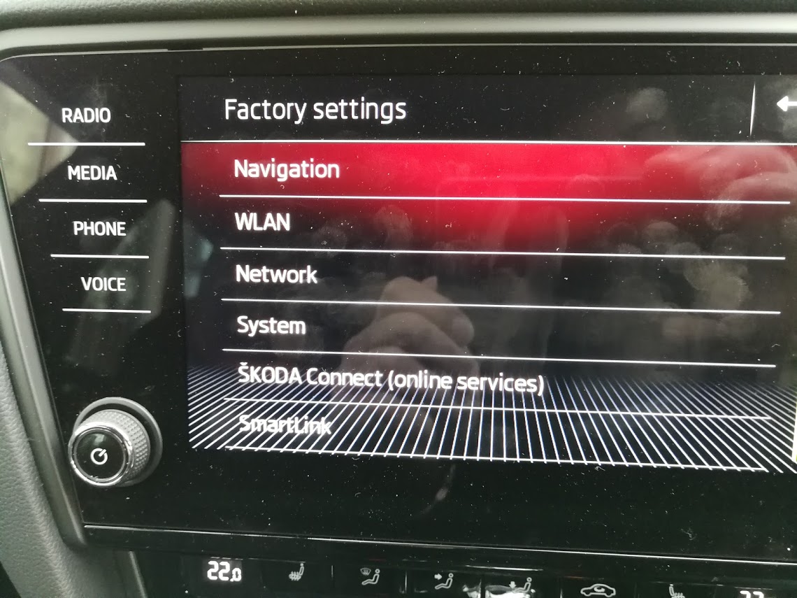

I hope this will help anyone else with this Issue: I have a 2017 Octavia Combi 230VRS with Amundsen media player and Infotainment online. I set up my Skoda Connect account online and followed the instructions and received my pin by email. Followed the wizard and Hey Presto, Map updates , road work alerts, fuel prices, news all working flawlessly.
Unfortunately after one week of picking up the vehicle the media screen on the Amundsen went blank as I was driving to the airport for a family holiday ( could faintly hear the radio but unable to get the touch screen to work. So totally locked out. Parked up and thought I will book this in when I get home.
After arriving back ( 1 week ) I started up the car and everything seemed to be working again. ( I had carried out the obvious ignition off/ on before I parked the car up ). So all ok until 2 days later when the message No Data Connection and or No Internet connection appeared every time I tried to access Skoda connect and the wlan symbol next to the white globe had disappeared from the display.
Could not get it to connect at all but could access the internet through my phone and laptop. I have a 3 WiFi dongle plugged into the cigarette lighter I do not use my phones hotspot. To cut a long story short Skoda Rochdale carried out a full factory reset of the car ( I could of done that ! ) asked me to delete my online account from the skoda connect portal, wait 24hrs until confirmation email from Skoda that the account had been deactivated and then set up again receiving a new pin and using my previous email address and password etc.
Set up car again with wizard and worked straight away. One week later No Internet. Carried out the above myself this time. Worked for 8 weeks ish and then No Internet.  As you can imagine this is like getting a new phone and setting it up again every couple of weeks and TBH getting a bit ****ed off with it.

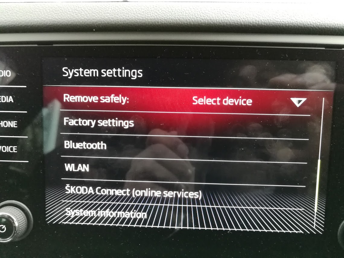

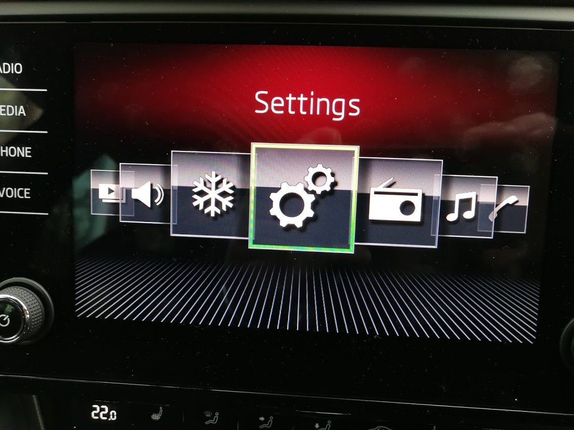

Anyway its gone off again this morning so joined this forum to pass on my experience. I have found a quicker way to get it to connect. Settings Menu-System Settings-Skoda Connect ( on line services )- Factory settings Skoda Connect ( on line services ) Not the whole car reset !!!!!!!  which Skoda Rochdale told me to do. Just entered my lastest of 4 or 5 pins that had been reissued in the past and it worked straight away took all of 1 min to do and no more resetting radios, Bluetooth, time, internet account and so on !
It appears to me that Skoda dealers are charging Skoda 1 1/2 hours labour on warranty for a 1 min reset job. :(

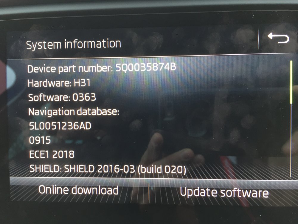

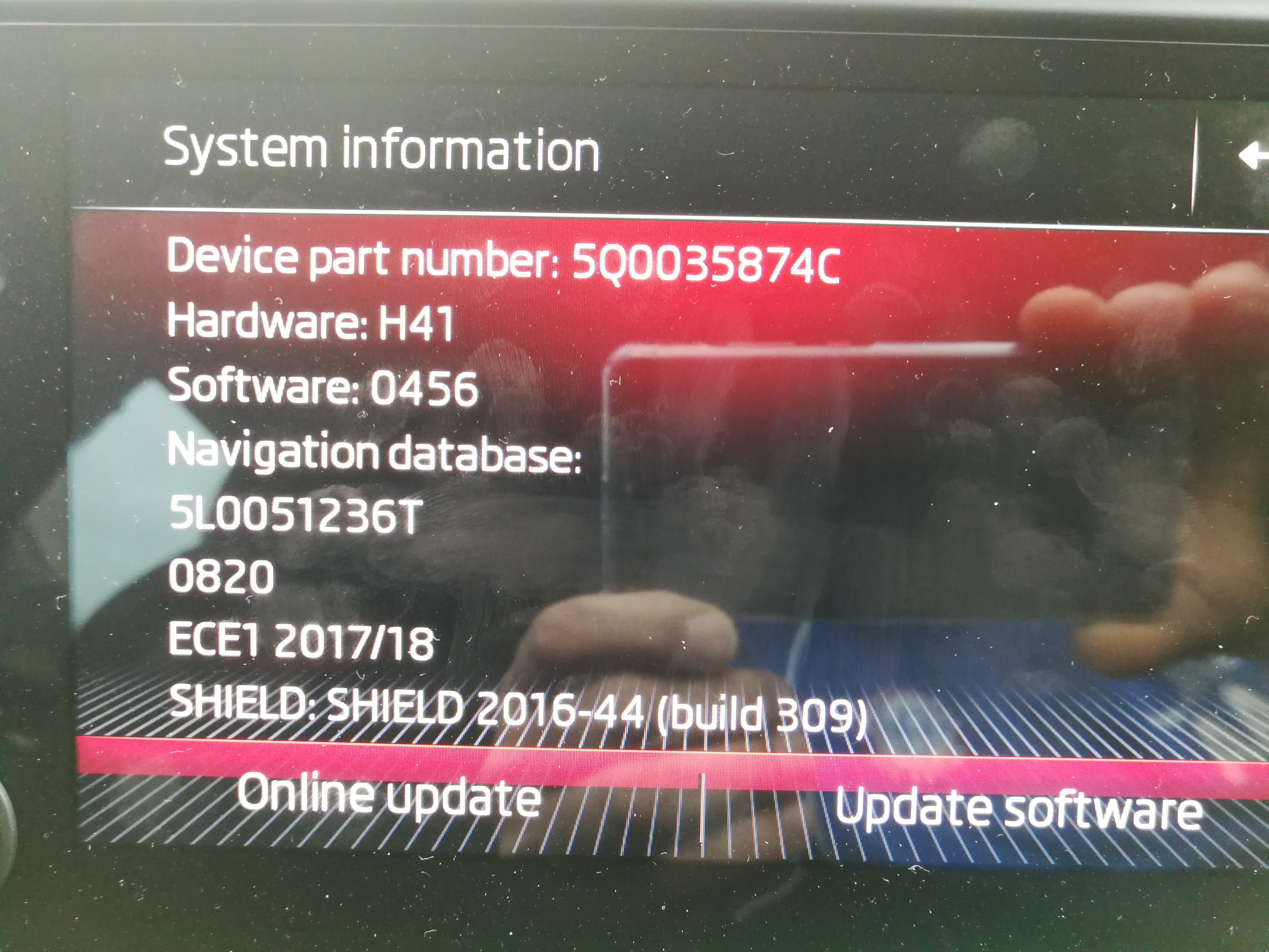

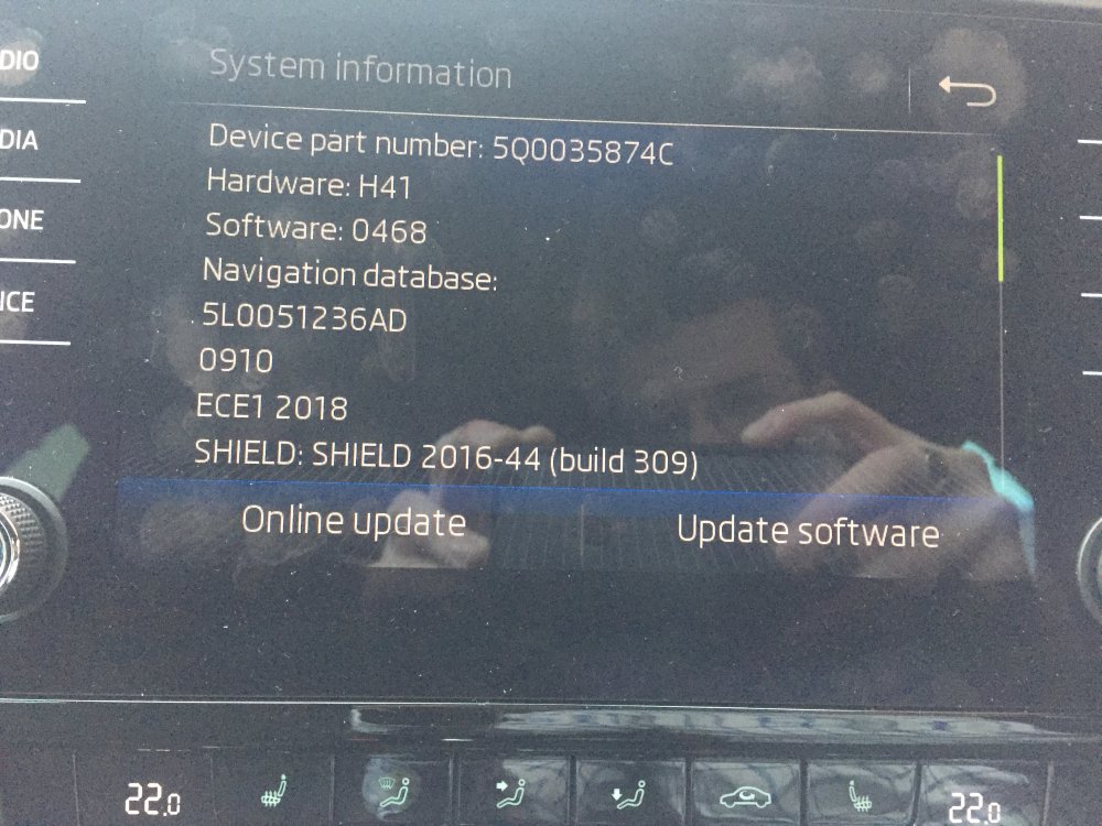

What hardware version have you got on your Amundsen? Mine only shows the wifi fan type signal strength symbol, not the globe with the word WLAN next to it.

So I connected it to my home wifi and still wouldn't connectto skodaconnect....
I did a reset as described in the car and deleted my account online, got the email to say account deleted, but now it won't let me recreate my account? Anyone any ideas? (other than give up and just drive it, because "it's a car, not a computer" as my grandad would've said...)
You have to wait 24hours until you can set up again
hahaha. They don't make it easy do they!?

I just had an email from connect saying it takes up to 10 DAYS before I can reuse my email address!
So, I manged to create a new account with an old email address that goes to the same mailbox. I'll try changing it back in a couple of weeks once the system has forgetten me properly.
Any way I think i've managed to get it working, so thought i'd post to share with anyone else on EE.
I've got a tiny amount of experience with networking so i was getting frustrated at it not working. Now, it doesn't seem any worse than than any other iPhone hotspot experience, which i've always foudn a bit hit and miss. Firstly, if you have an iPhone on iOS11 you need to make sure personal hotspot is on on and dicoverable (it hides itself and stays on after a while as i found out when i came back to the car after 10 mins in Tesco and it wouldn't reconnect. The next part I'm still experimenting with, but i've not gone out this afternoon and if i sit on the drive playing my wife just calls me a loser...
Either a connection via wifi hotspot take a reasonable amount of time to connect, but if you leave it and then open Skodaconnect, it will work.
OR
You can tether it when you plug it in to the USB port (with hotspot on and discoverable) and it will connect and continue working after you unplug. I think tethering via cable will also work as at some point yesterday, the globe was white but it didn't say WLAN next to it, and it still worked (this was with hotspotting turned off, because I was also using car play to try and get the OneSkoda app working, but more of that on a different thread...).
I'm driving the vRS to work tomorrow so I'll carry on experimenting to try and confirm these methods.

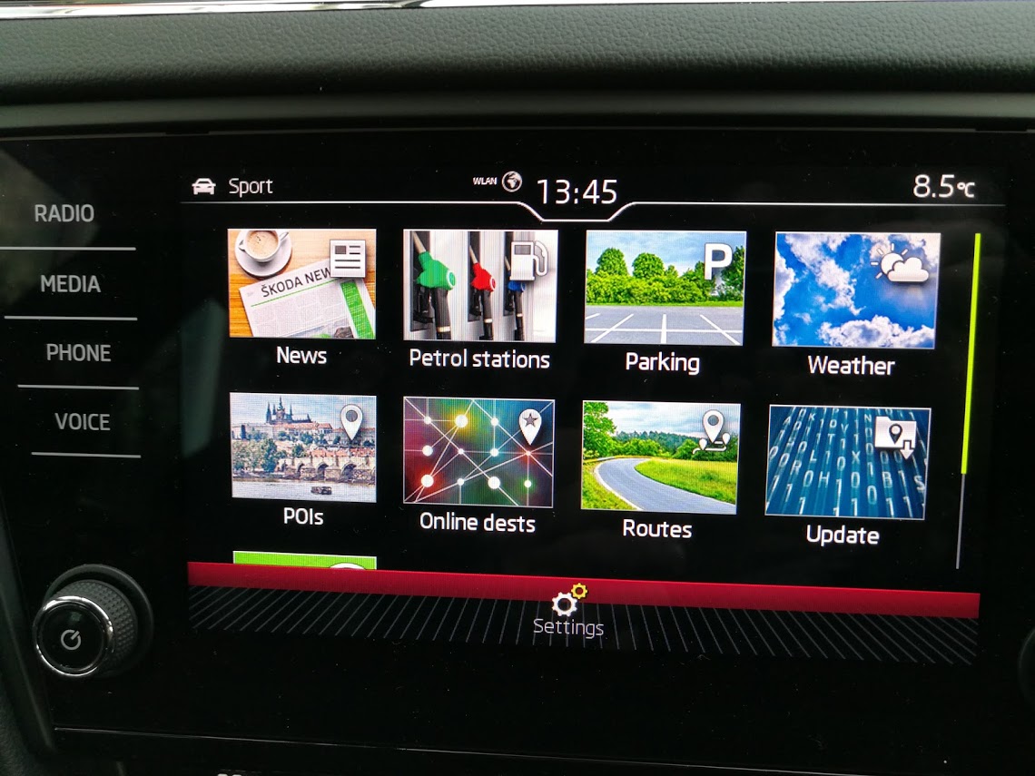

Amudsen on a FL Octavia. The globe and WLAN text are centre left of the clock at the top of the screen. What I'm saying at the moment is I'm not sure if:
  • Connecting to an EE iPhone over wifi hotspot is particularly slow (I've found it unreliable on everything, regualrly having to turn the hotspot on/off/on to make a connection actually access the interent).
  • Plugging it in with hotspot enabled then forces it to connect and it continues to work after unplugging.
As a side note I mentioned that when i disabled hot spot on the phone while it was connect via CarPlay I retained a white globe icon (its red when i have no connction) and had access to Skodaconnect. so I guess carplay also tethers it?
Intend to test it more on commute tomorrow when i have time to check different factors. Sorry if I wasn;t clear earlier. I'm at least happier that i can get it working without buying another accesspoint as I have 20GB on my phone that I never use
