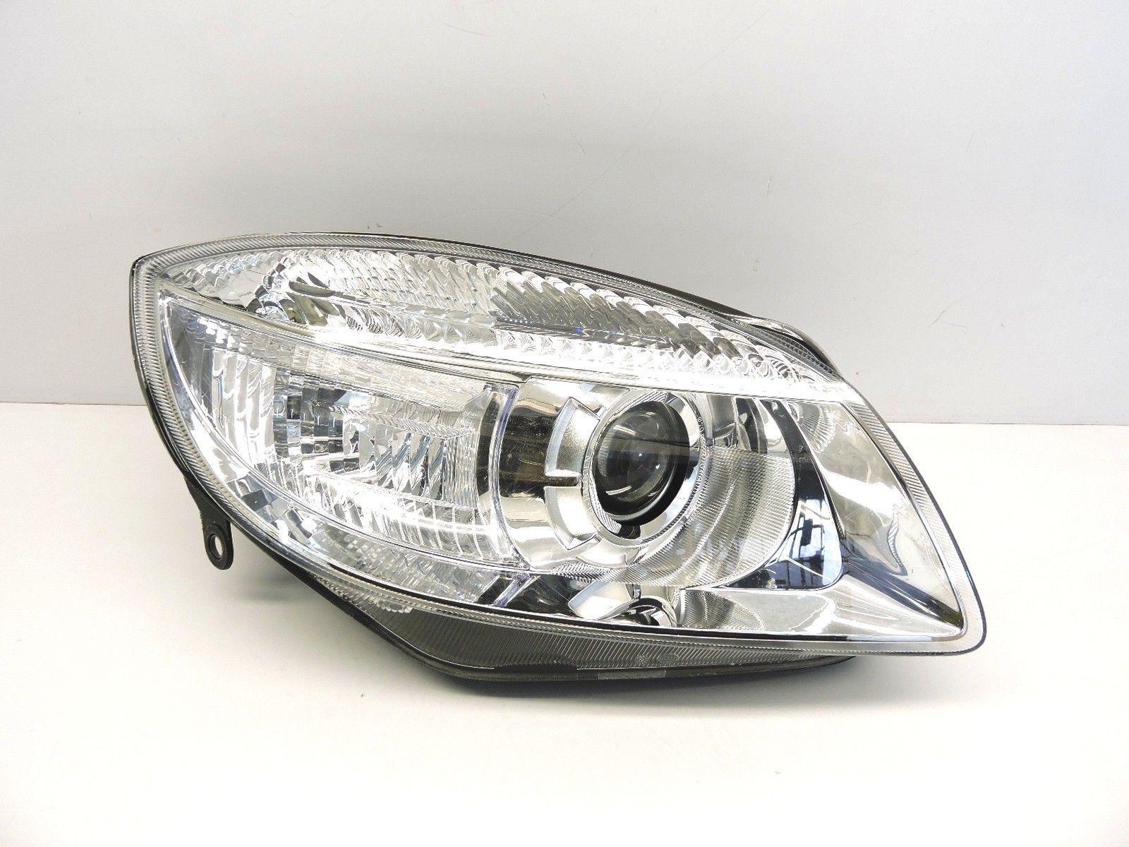

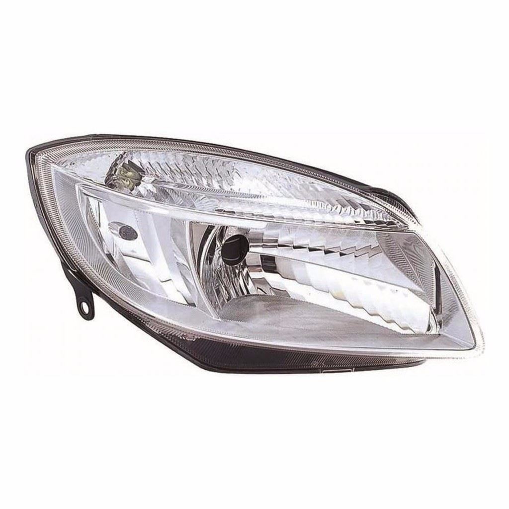

2008 Headlights, currently projectors can I change to basic H4 type ???
As per title, can I change the current projector headlights (which we all know are terrible) to standard NON projector type, any mods to do or a simple plug and play type set up ???  Thanks any advice gratefully received.... NEXT question anyone got any 08 mk2 H4 lights sat in their garage ??
I've just managed to buy a set of headlights H4 single lamp type headlights which should hopefully be a straight swap ??? Not sure about the wiring connectors at the rear though anyone ??
If the projectors are two H7 bulbs, one for dip and one for full you will need to change the wiring loom to support the multifunction H4 which does both dip and full beam in one unit. Did you get pre-facelift headlights as facelift wont fit the pre facelift nose!
Thank you for your input, much appreciated.
Both lights are from / for an 08 the same yr vehicle and look to be the same shape, the ones fitted are projectors and the replacements are SINGLE H4 lamps as can be seen in the images below.   Its more a case of hoping the power plugs fit straight into the rear of the replacements.

projector light.jpg5a1eb50d63039_H4shape.thumb.jpg.cecc4836822c463f0c0429bb49b6cf3a.jpg
