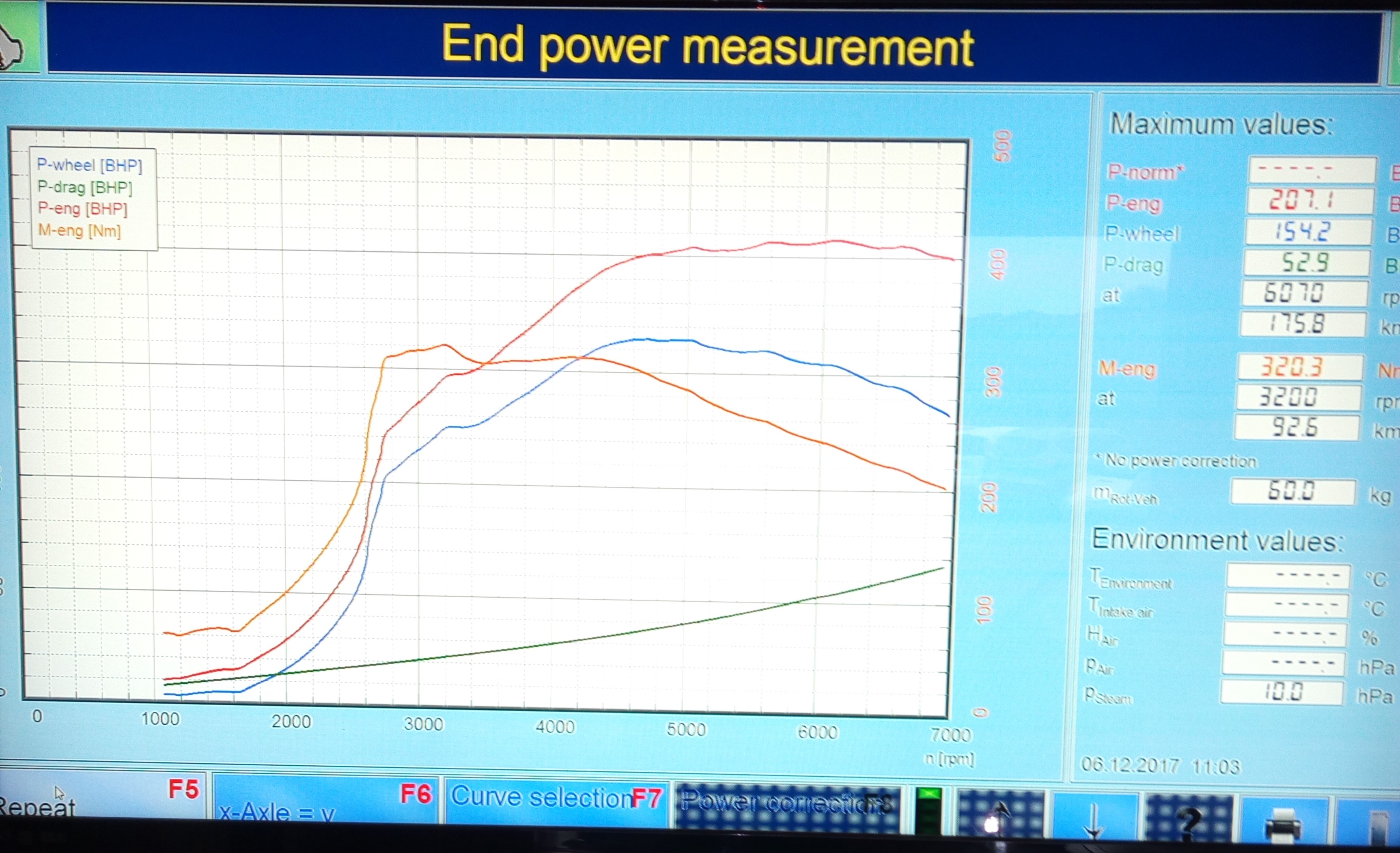

The icing on the cake was that Pendle had a local agent called 'Collins of Probus Ltd' based near Truro in Cornwall, 01872 520654 http://collinsofprobus.com/content/is which is about 6 miles from my home. I called into their garage in September 2017 and met Gary and Neil Collins. Gary is the man for the ECU remapping. He spoke to me at length with all the pros and cons on remapping my particular/specific car (DSG box etc). Coincidentally Gary's Mum runs a 2010 Fabia 1.4VRS and he said he would remap his Mum's car as a test before my car. (What a great offer for me as a cautious owner) Anyway Gary called me a week later saying he had given his Mums car a good run on their Maha LPS 3000 Dyno and felt that the 'After print outs' results should/could  be better. He asked if I could delay until end November whilst he work with Pendle to improve the software. My thoughts were, this is a truly bespoke remap that I am getting here and was very pleased to wait.

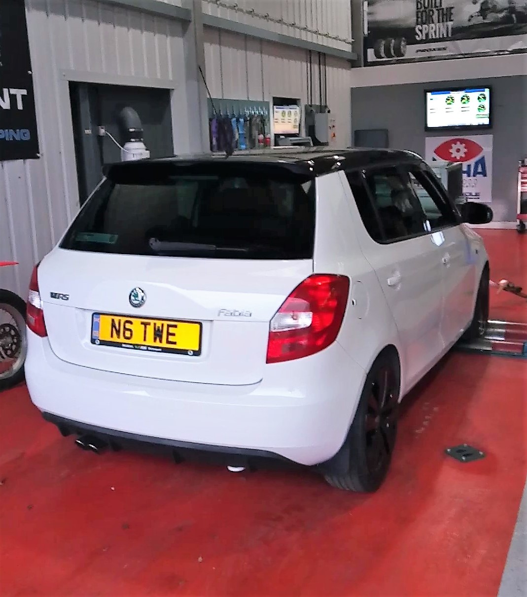

I took my car in on the 6th December with everything spot on with the car. Gary was happy to allow me to hang around watching with camera - the entire process.
Suffice to say the professionalism was tremendous - before and after test drives, before and after printouts, everything you could imagine to ensure I was completely happy. I even mentioned my annoyance with the double click to open all doors whilst chatting. Gary deactivated this in the ECU leaving just one click to open all doors.

207.1 BHP
320.3 Nm

For your info my pre map power data 191.7 BHP - 271.6 Nm

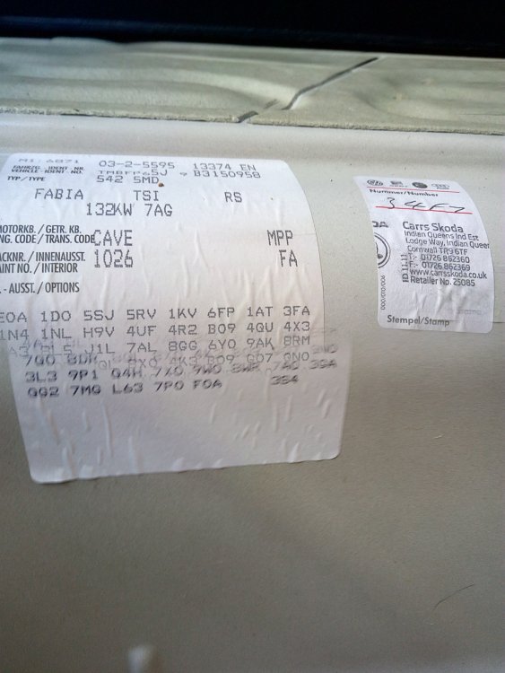

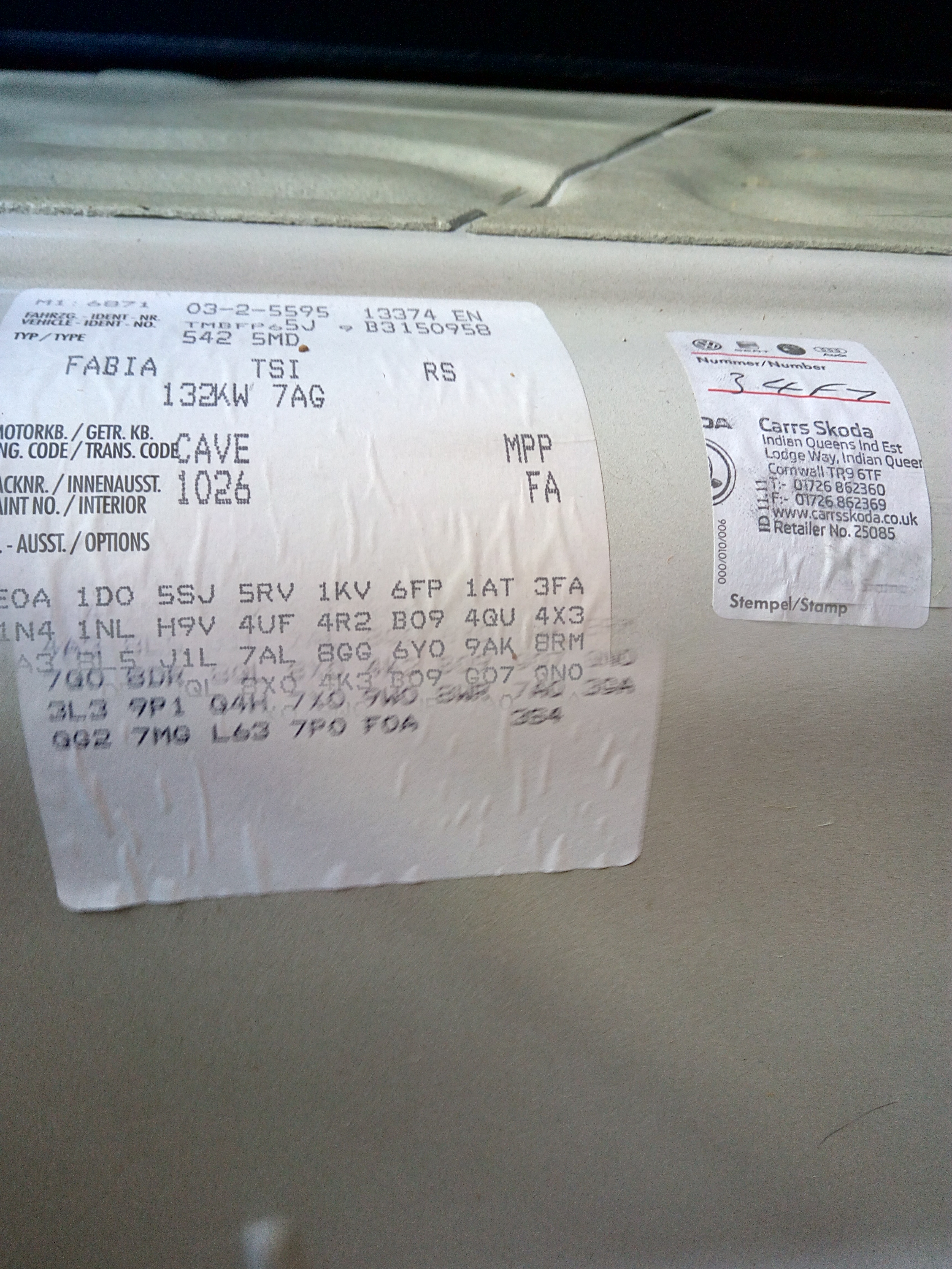

Awaoffski
I have waited a long time to do this. Yonks ago I decided to put some sound deadening  in the boot under the spare wheel etc, - as I hated the horrible drumming sound.
The labels there would be covered up for ever!!! so I took some photos. After all this time they are useful - I hope - thank you.
