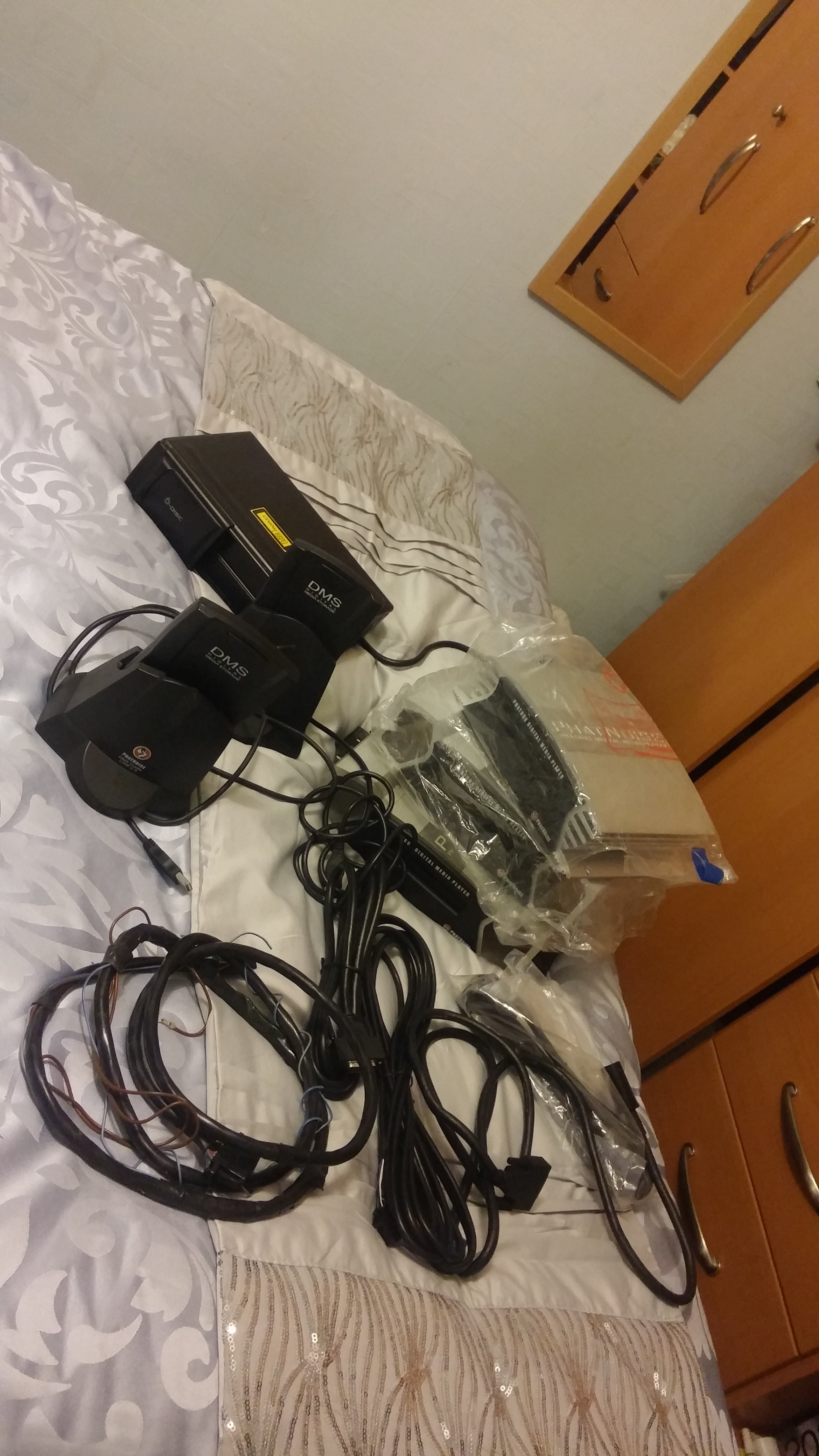

Milanm, if we can get postage sorted I have a spare system for you from all these bits. One was in dads superb, hence so much of the stuff as I ripped it out before he traded it in. YOU would  need  get a power  for the docking station.
