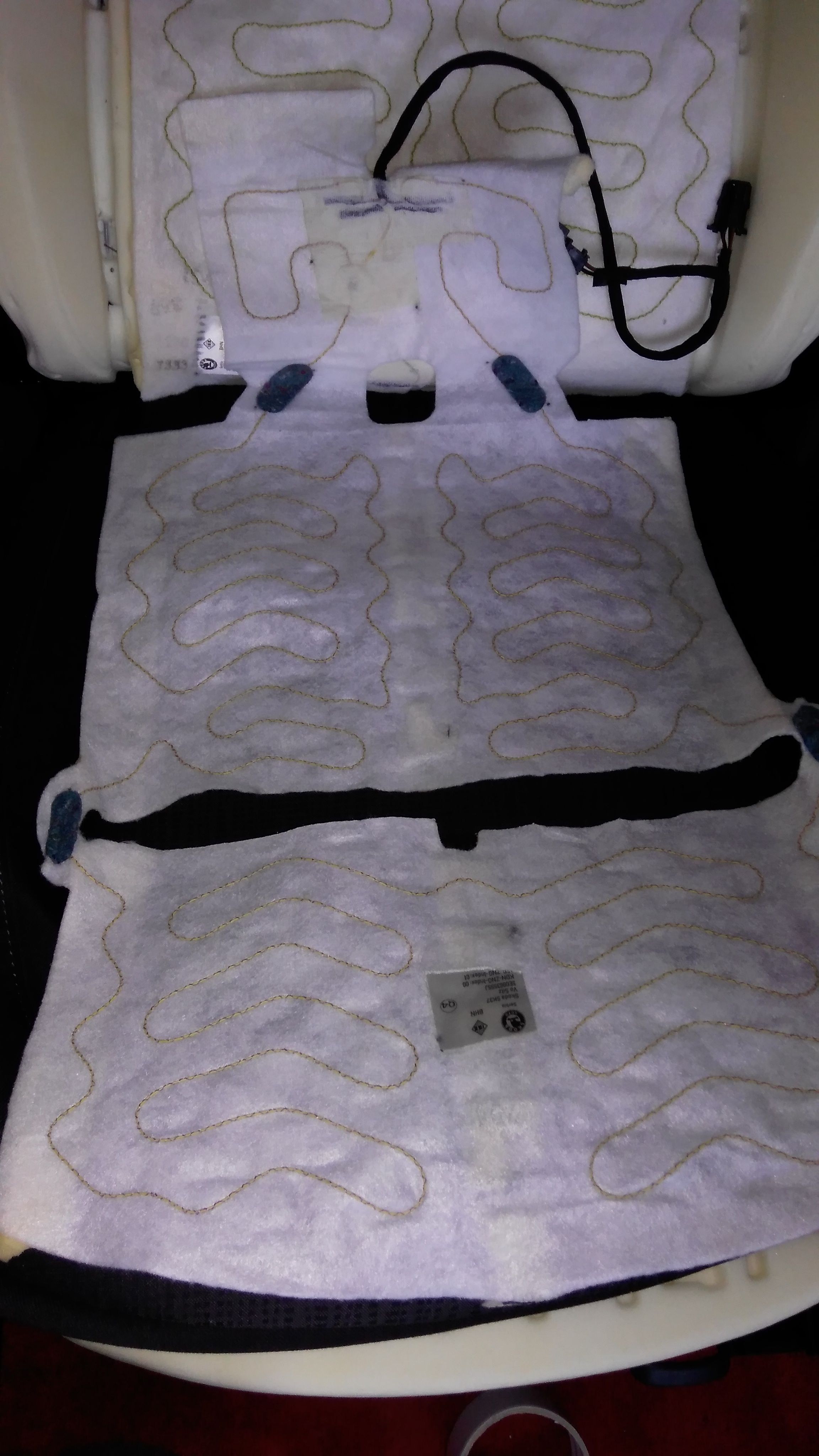

I did not write anything on the forum - no time - we managed to assemble the heated mats.
Full of success !!
If you have any questions - ask

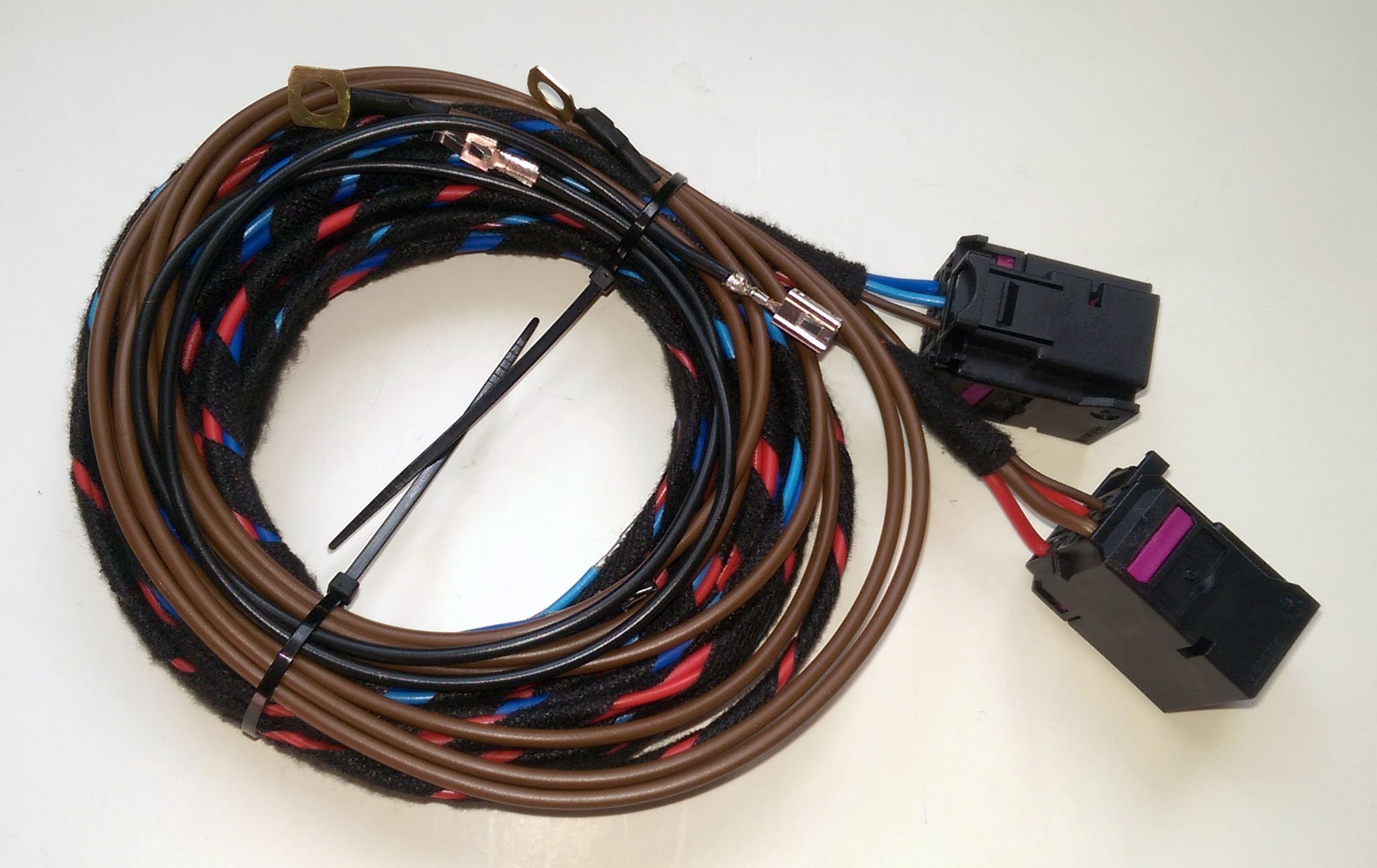

You need to buy or make a bundle (2 bundles on the left and right side), for example, you attach such bundle to the computer and the fuse box.
At the end, an  electrical diagram from O3
I bought such bundles:

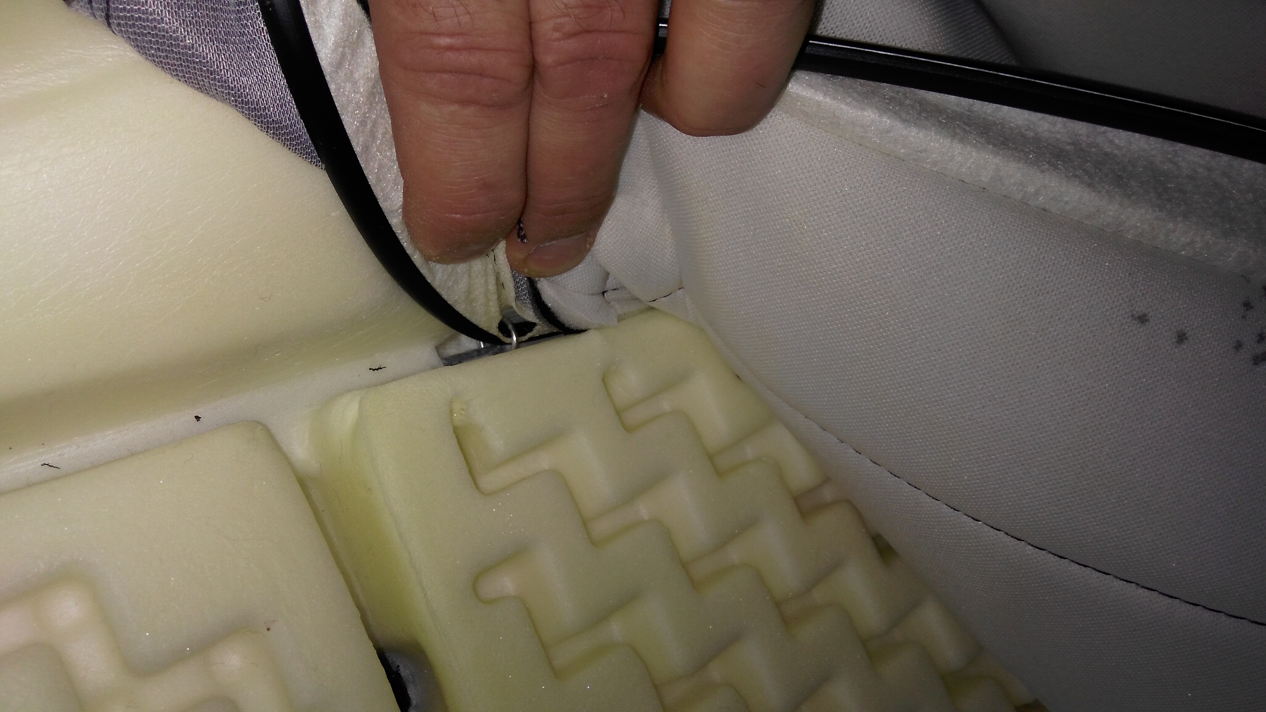

If you have all this, you take out and "wash" the armchairs, mats on the adhesive tape to the sponge (so that it does not drive), the back
of the armchairs is tied back with the so-called tricks (the easiest). Originally for wire clips that you need to cut when you dismount

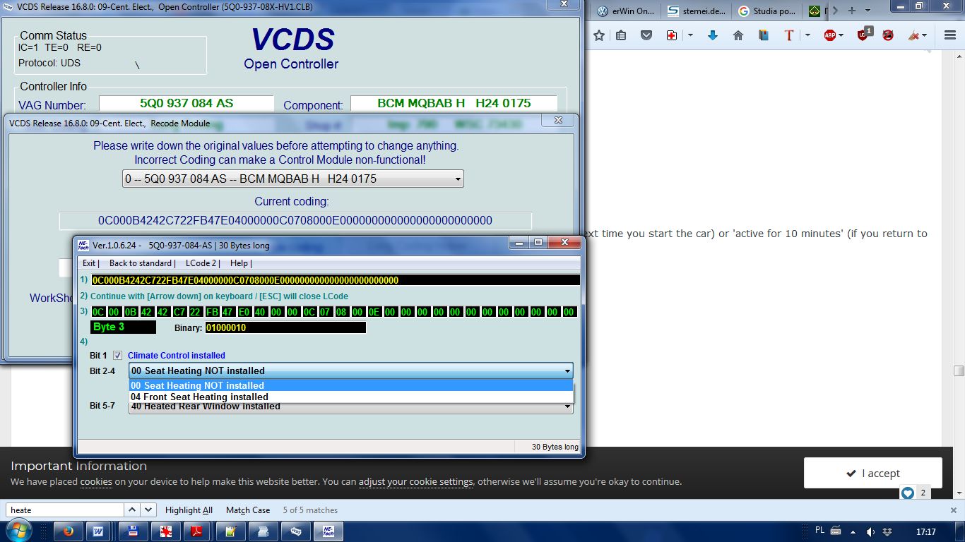

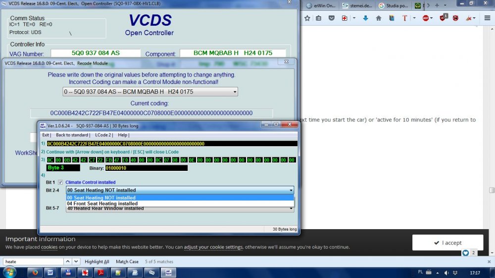

the material Coding (is on the internet) from what I remember is module 09 -> Instaled
And ready. As below

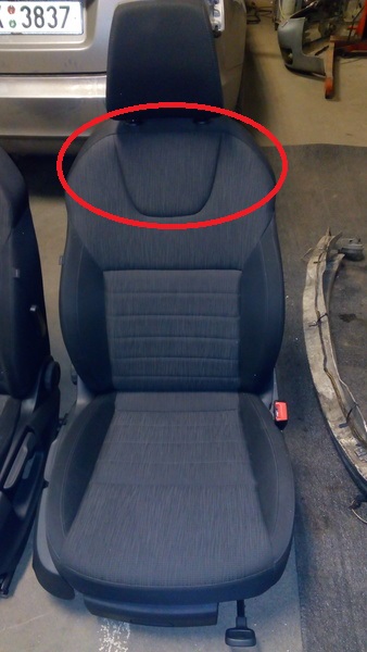

Armchairs. In my version (Style not RS) You have to cut the material from the backrest heating mat a little, and slightly fold the very p
art of the mat on the backrest, because in the original seat (not provided for heating) on the backrest of the backrest at the top of the
headrest (this part is marked on drawing) enters the wires from the heating system and could break the beam, break the wire
But maybe I'm wrong and you can somehow push it and bind the material to the sponge.

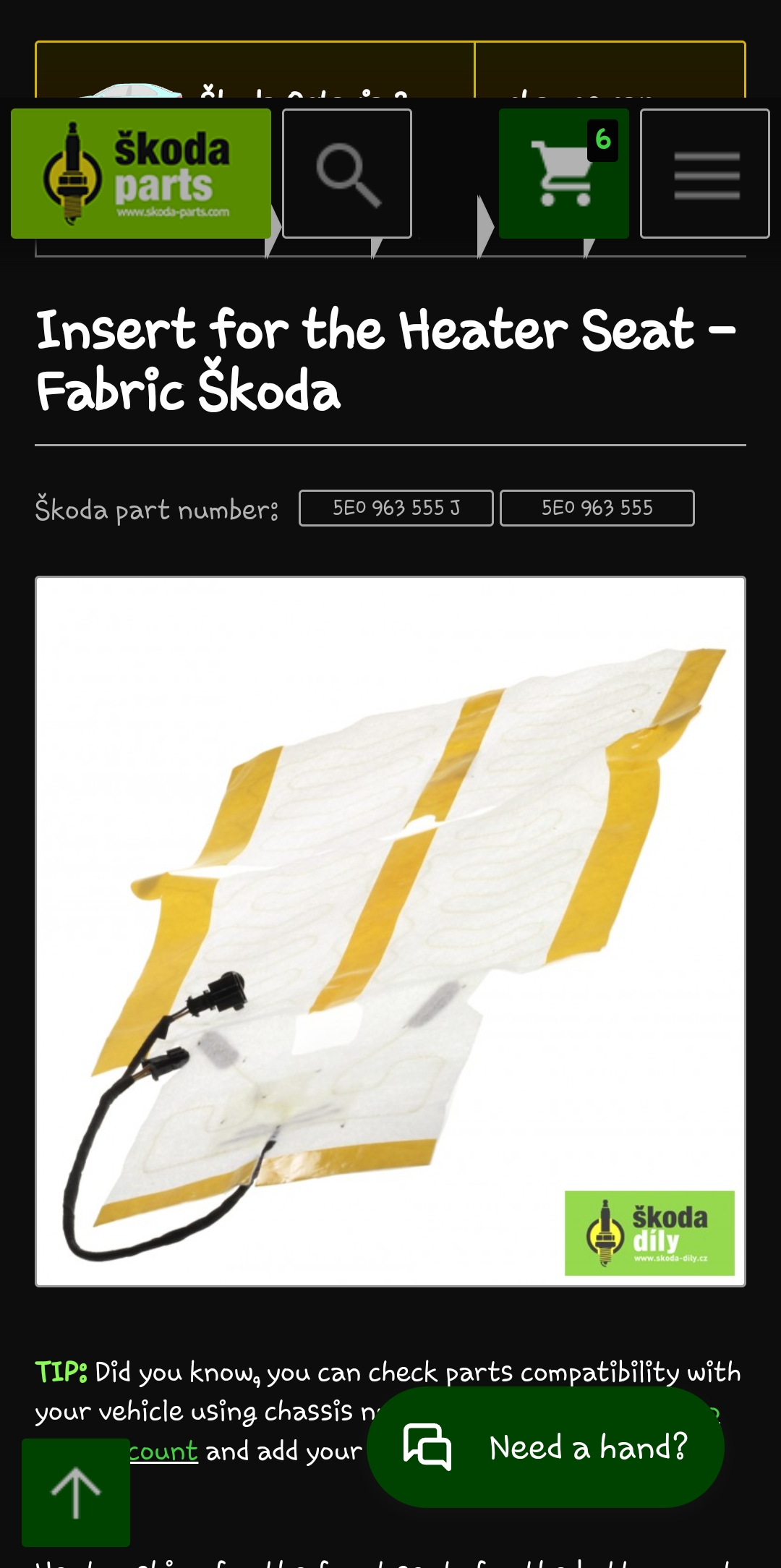

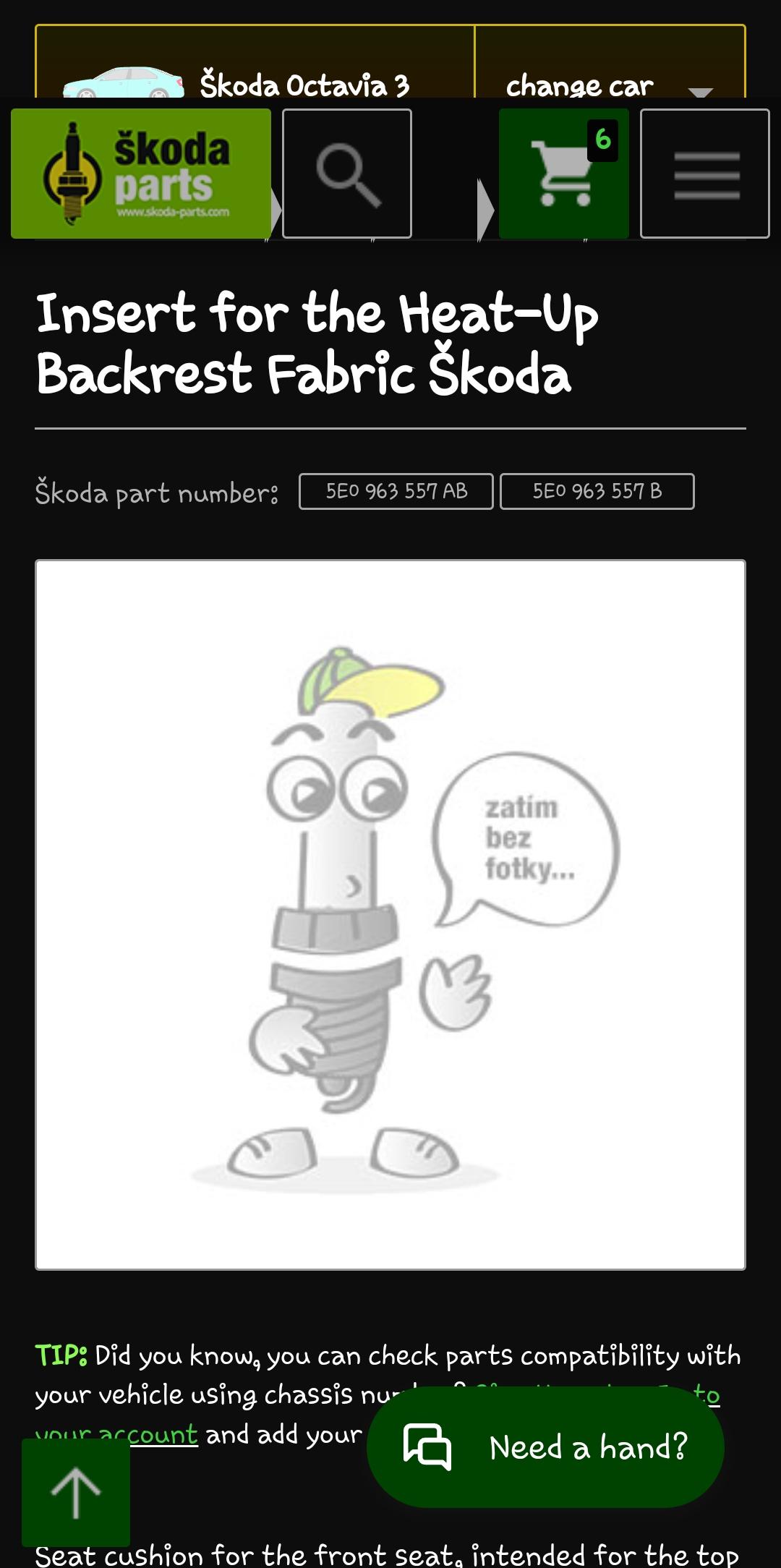

I have been looking on Skoda parts and believe I need the following heated seat pads (I have fabric vrs seats)
5E0 963 555J X 2 - SEAT BASE
40590699_Screenshot_20240124_192057_SamsungInternet.thumb.jpg.002cf32ffd483f2f750cf4907e9bca3d.jpg
5E0 963 557AB - BACKREST
92436743_Screenshot_20240124_192355_SamsungInternet.thumb.jpg.c699cfc61434581ebb6af2a65c7adcbb.jpg
The issue I have is the website shows these fit an Octavia 3, however when I enter my vin it says doesn't fit. I am not sure if that is just because they were not a selected option on my actual vehicle when new.

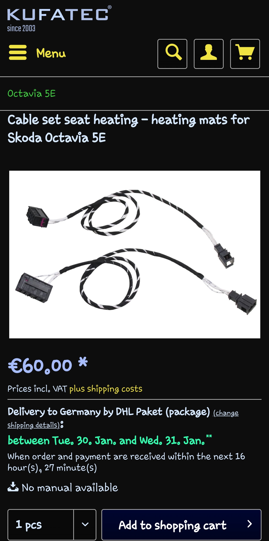

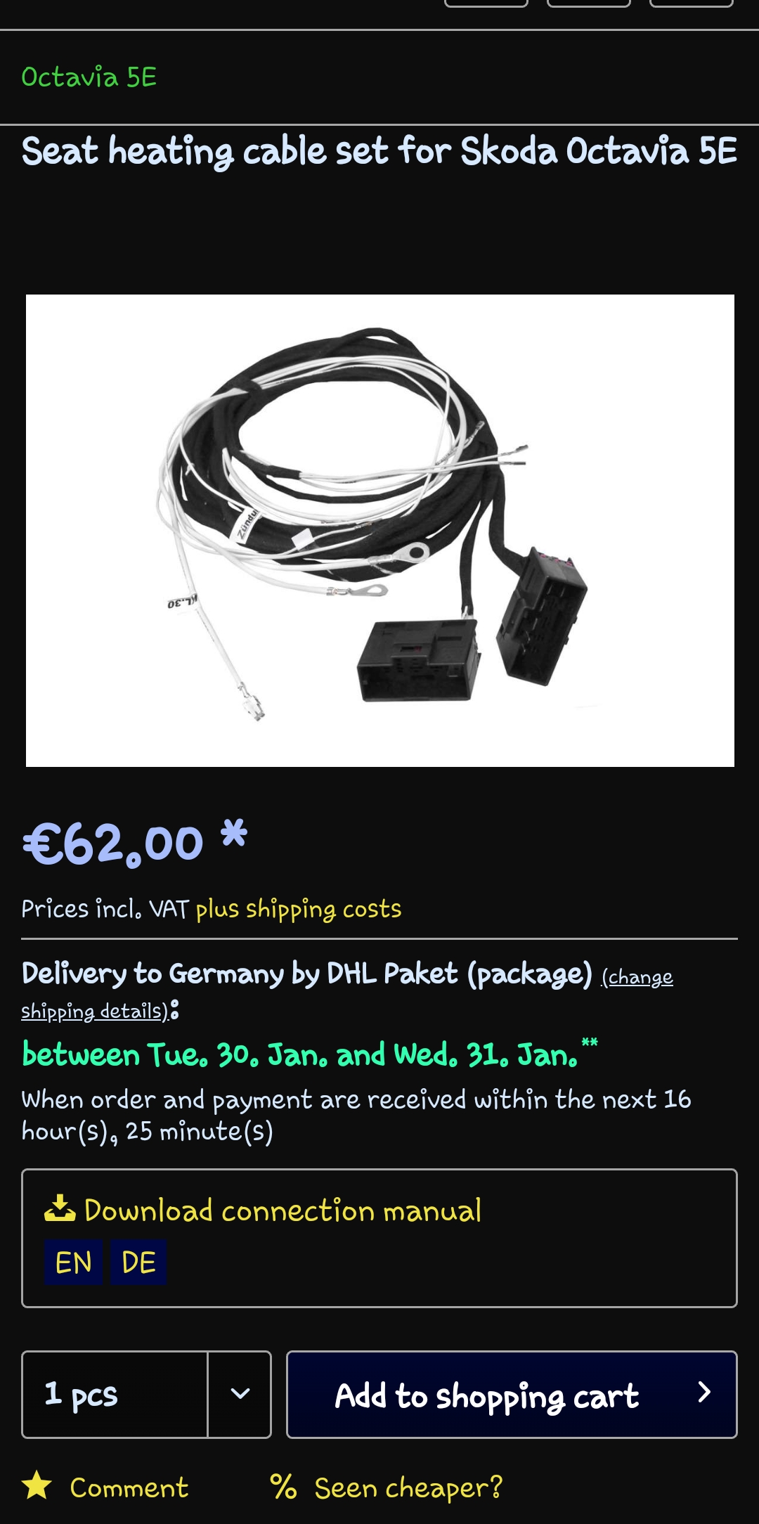

The main question I have, is what exact Kufatec loom(s) do I need. Is it the ones shown below?
2029767364_Screenshot_20240124_193243_SamsungInternet.thumb.jpg.5a0e4ba3c0d2b73c8e1f0f624e1ebb3d.jpg1358479650_Screenshot_20240124_193440_SamsungInternet.thumb.jpg.6c0b041f30099276734a49cf20820c09.jpg
Any help or instructions will be much appreciated, especially with connecting it all. I have read all the threads I can find but they are not detailed enough or have adaptions like the old vw look etc.
