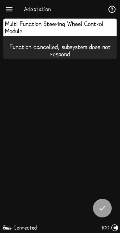

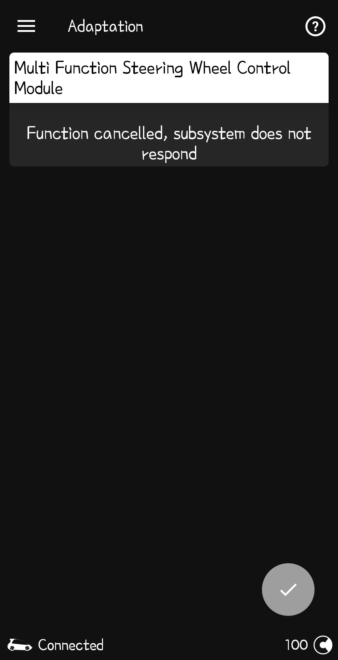

To confirm. You are correct, I can access the module with lin convertor out, but not with it in.

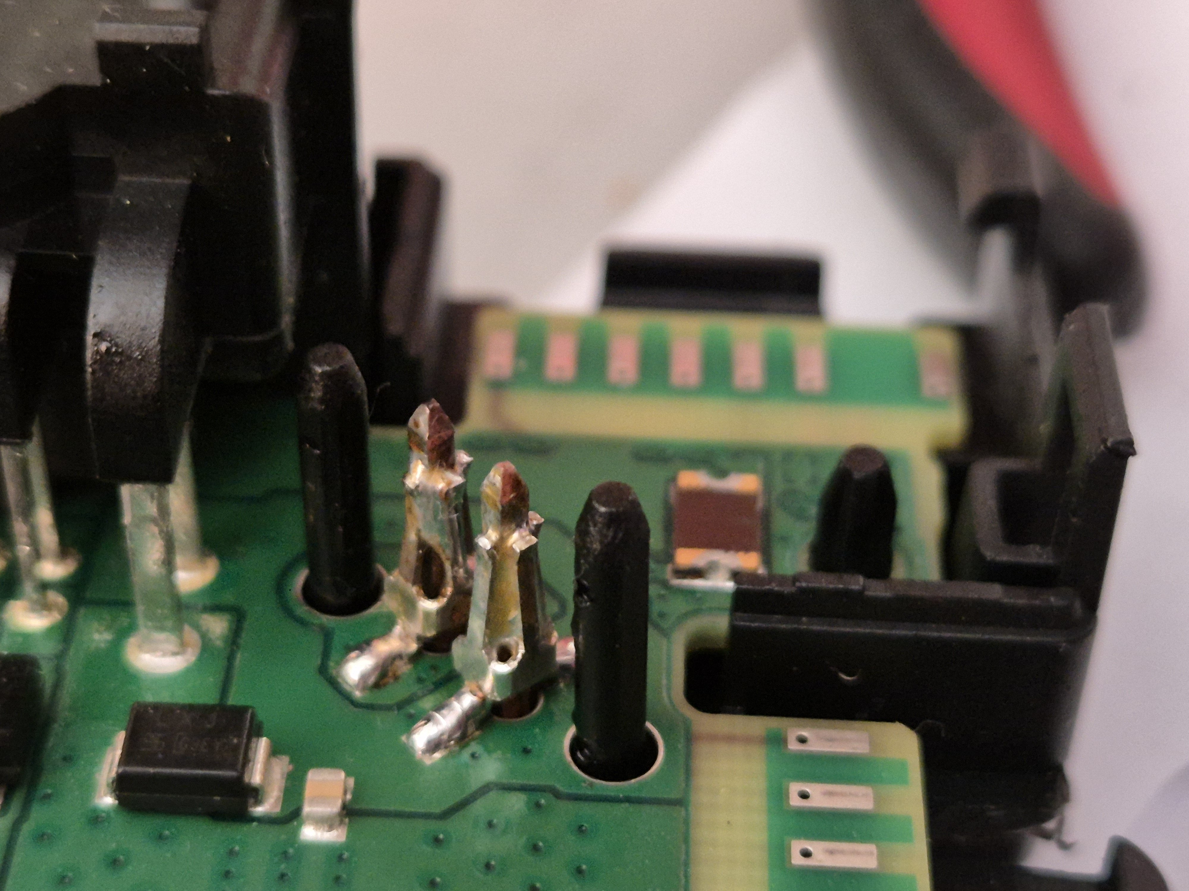

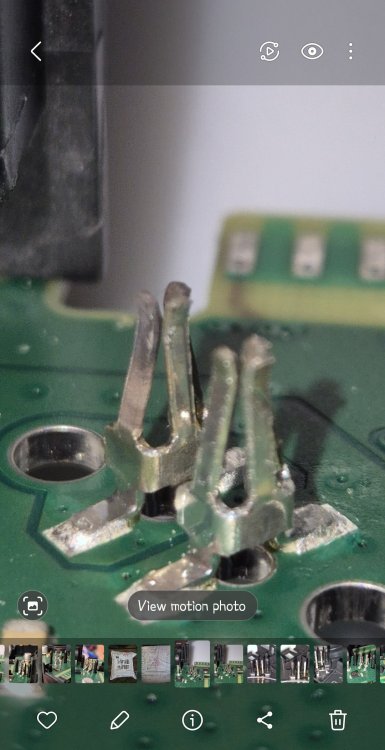

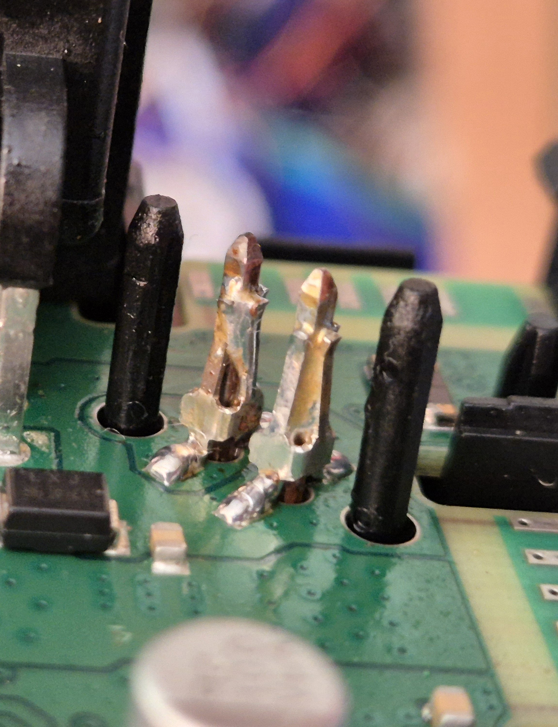

So now checked my clock spring. As you can see the terminals are not even touching properly which has resulted in the others getting got and being burnt. it is these that grab the pins for the heater. As the Russian forum suggests my mate has now soldered them and the problem is solved. Heated wheel is back to normal and fully operational. No fault codes. Not pretty but has done the job. @Purpletom Take yours apart and solder it and pretry sure it will solve the issue. Then you can send your febi one back or sell it.

https://www.drive2.ru/l/668838421808044836/ Its Russian so needs translating, but it is the most likely issue. Seems tk be lots of people of the drive forum reporting the same. Once soldered seems to fix it. Worth considering. Not done anything myself yet, will be taking a look tomorrow

Just a random thought. Can you go back into your coding turn the heated wheel button off and see that makes any difference. For some reason I can't seem to access it anymore. Pretty Sure thats where I turned off my flappy paddles too and haven't got back into it since. Dont know if that's related as the wheel worked while it was like this. Given that you are having the same issue, would be good to know if you can access it or not? Anyone have any ideas why I can't access this any more

Will check when I can, on nights tonight so had to put it back together for now to get ready. Engine running or not?

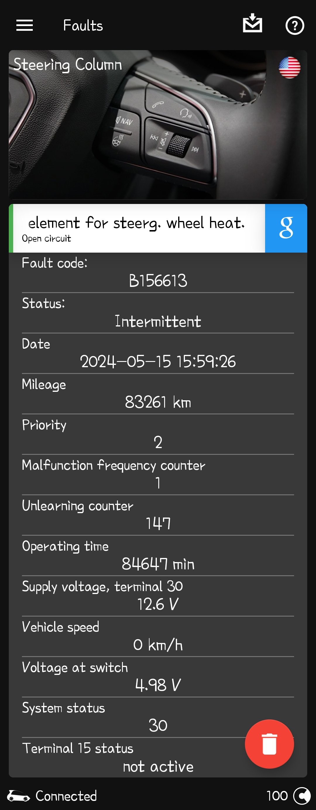

Hi guys Sadly i am back and in desperate need of help. My heated wheel had been working perfectly until a couple of weeks ago when it suddenly stopped. I plugged in the obd11 and got a fault code B156613 Heat element for steering wheel heater open circuit : I can clear the code and it only returns when I try and turn on the heated wheel again. I have tried to do some research but not had much success. It advised to measure the heat element in the wheel which should read about 1.5ohm. It measured 1.6 so should be all good. If this is ok it says its most likely to be the clock spring/steering module. I have therefore ordered one from Ali which sadly this gives the same error. I have fitted another heated wheel to test and that is the same. (The element on that was tested at 1.5ohm too). Basically I can press the button on the wheel and it does nothing. If i turn it on by the media screen it pops up and then goes straight off as if tying to turn it on but can't. Any help would be greatly appreciated. As I am lost.
