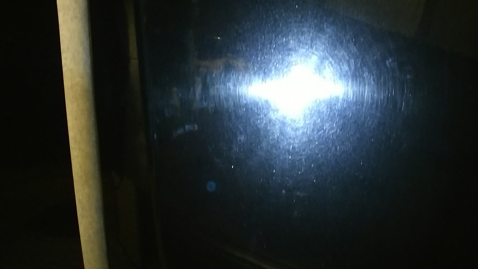

I'm new on here and just picked up my first ever skoda on Friday. A black 2010 octavia 2.0 tdi vrs dsg. Loving it by the way. :biggrin:
Unfortunately it is covered in swirls. I have a fairly large range of products for cleaning my car including a da.
My question is how hard is the paint?  I used my da on my Bmw 118d which was hard paint so only currently have an orange chemical guys hex pad and a black chemical guys hex pad for finishing. I also have a 3'' backing plate with small pads for smaller areas.
Will these pads be OK or do you think I should possibly get a less aggressive pad?

Might be best going from orange pad to white pad, then black. Going from orange straight to black is too big a jump IMO.

Definitely worth doing. Your lucky to have In2detailing to hand aswell. By the way, it would be worth trying the white pad first to see if that's all that's needed to correct your paint. You can always move up to the more aggressive orange pad if need be.

I found green hex logic was good for my paint but that wasn't too bad when i last machined it
Is green a grade down from orange?
Yes I tried white and green and found both did really well but green cut slightly more but still finished just as good for me

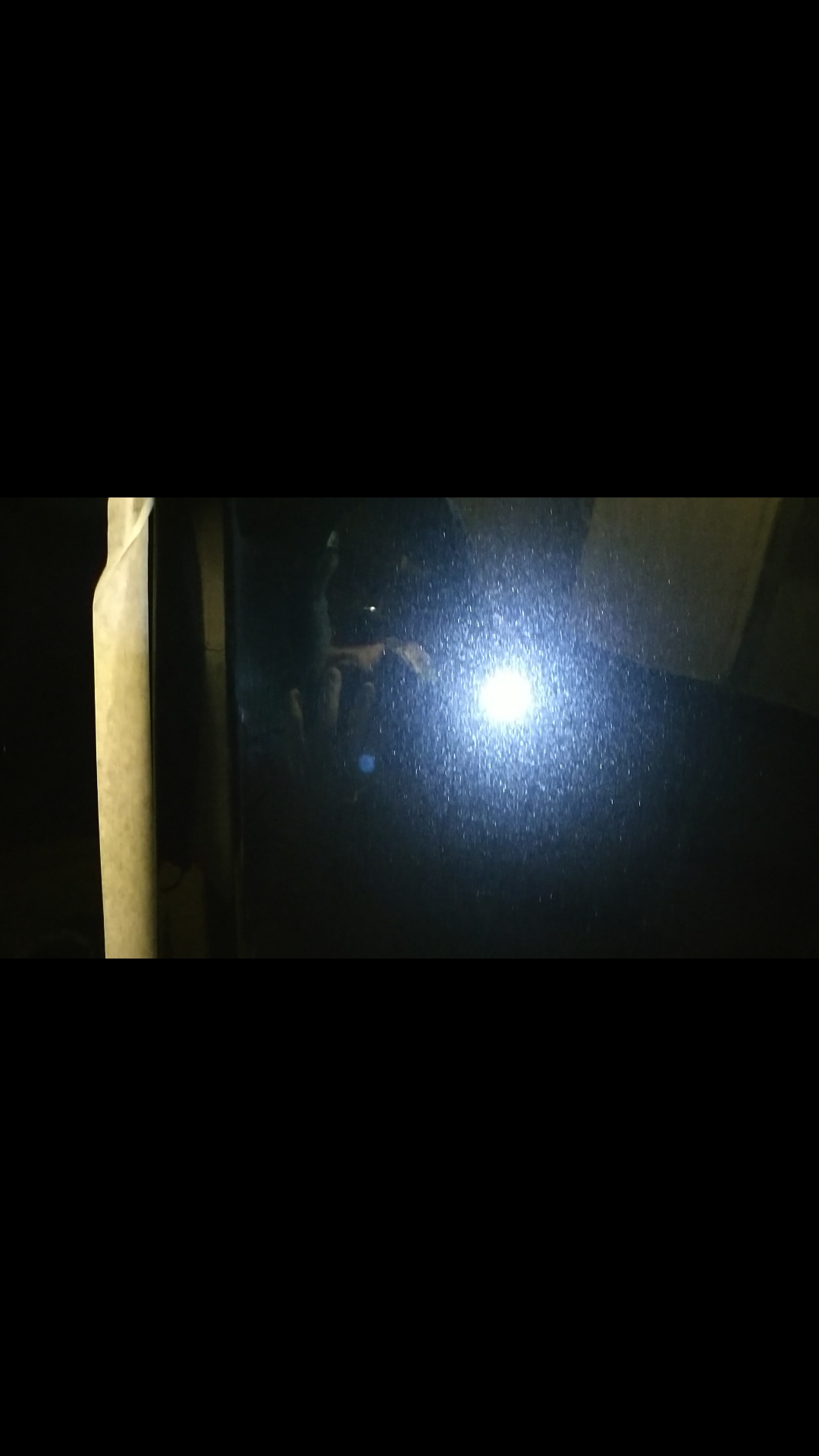

I have had a go at the bonnet today. Went for the orange hex pad and madcow heavy cut. This is it yet to be refined....
A massive improvement from what I can see in the pics. Nice work.
