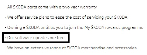

I see this on the Skoda Irish website. Seems fairly clear to me, though the dealer waffled about "doesn't include the stereo" - I paid around €500 for the Canton upgrade and sw updates not included??

Now you have proof that it should be free and it doesnt state the stereo is excluded I would kick off!
