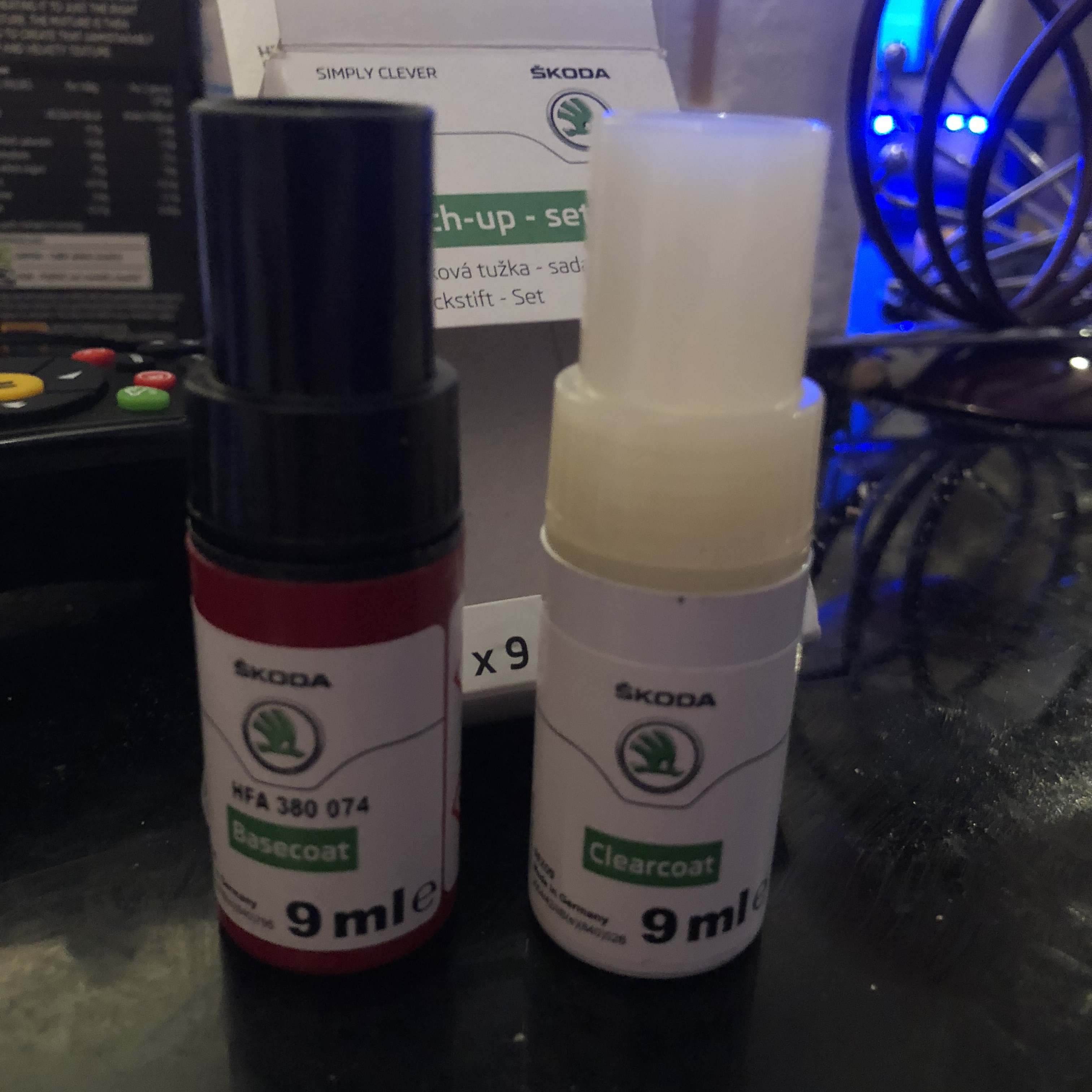

 Can anyone tell me the best way to use the touch up paint have two chips in the door and bonnet that are fairly deep  I would like to try and make less obvious

If they're deep, might be an idea to try and fill them a little with a bit of Cataloy knifing putty. Halfords probably have small tubes of it. Let that harden, give it a day or two. Then just put a small drop of your new touch up paint on and let it dry. See how that looks. Don't try and put too much paint on the chips - I always do that and make a mess of it :-)
I gave up this the touch up kits, use chipex now.
For easier to get a good result. Takes a little effort and practice but works.
I you stick with the Skoda kit, use small amounts and layer it if it’s deep.
