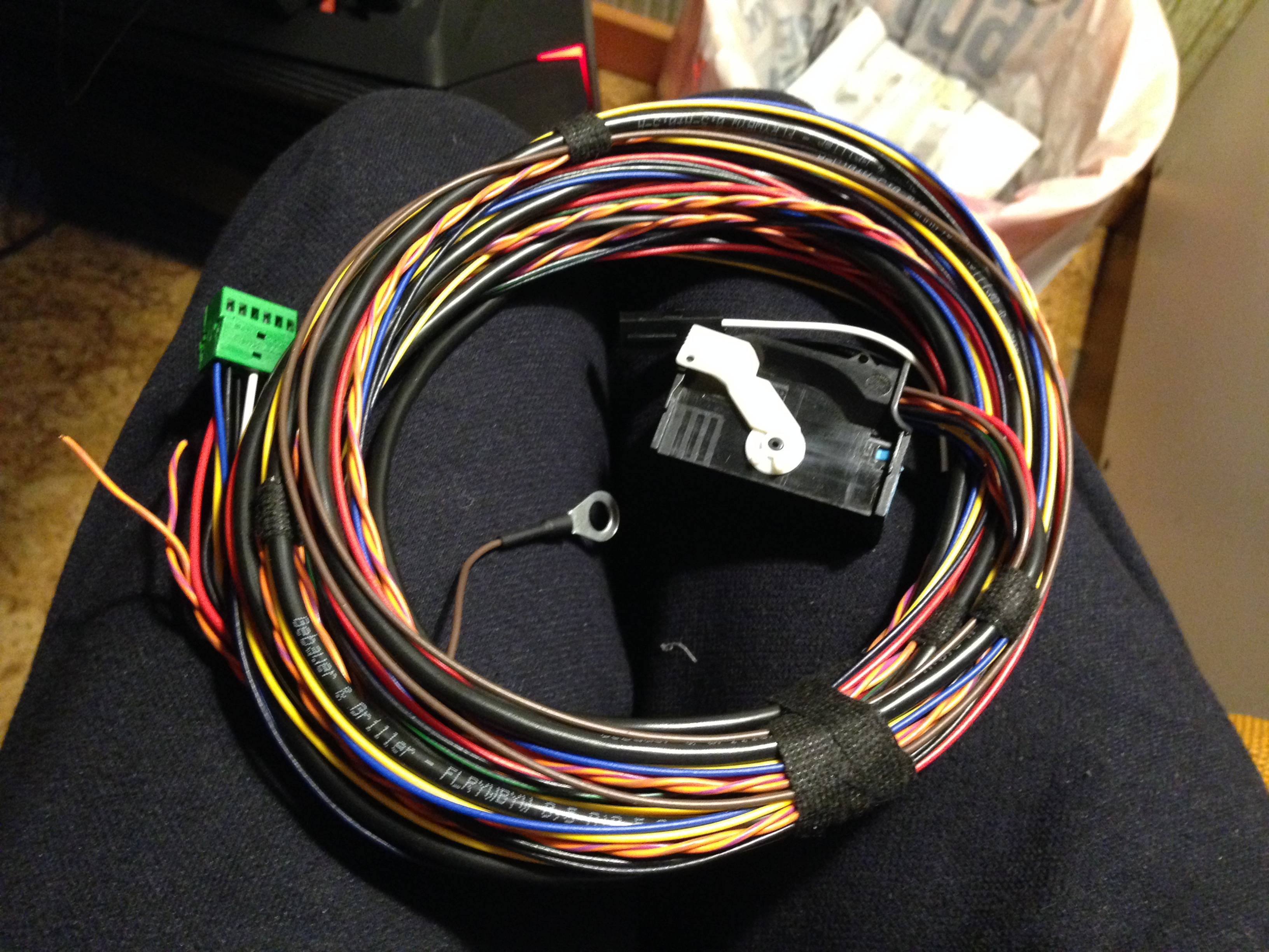

I have installed handsfree in my Superb and bought a plug & play cables. After i installed this my right front speaker and sound system dont work as they should.

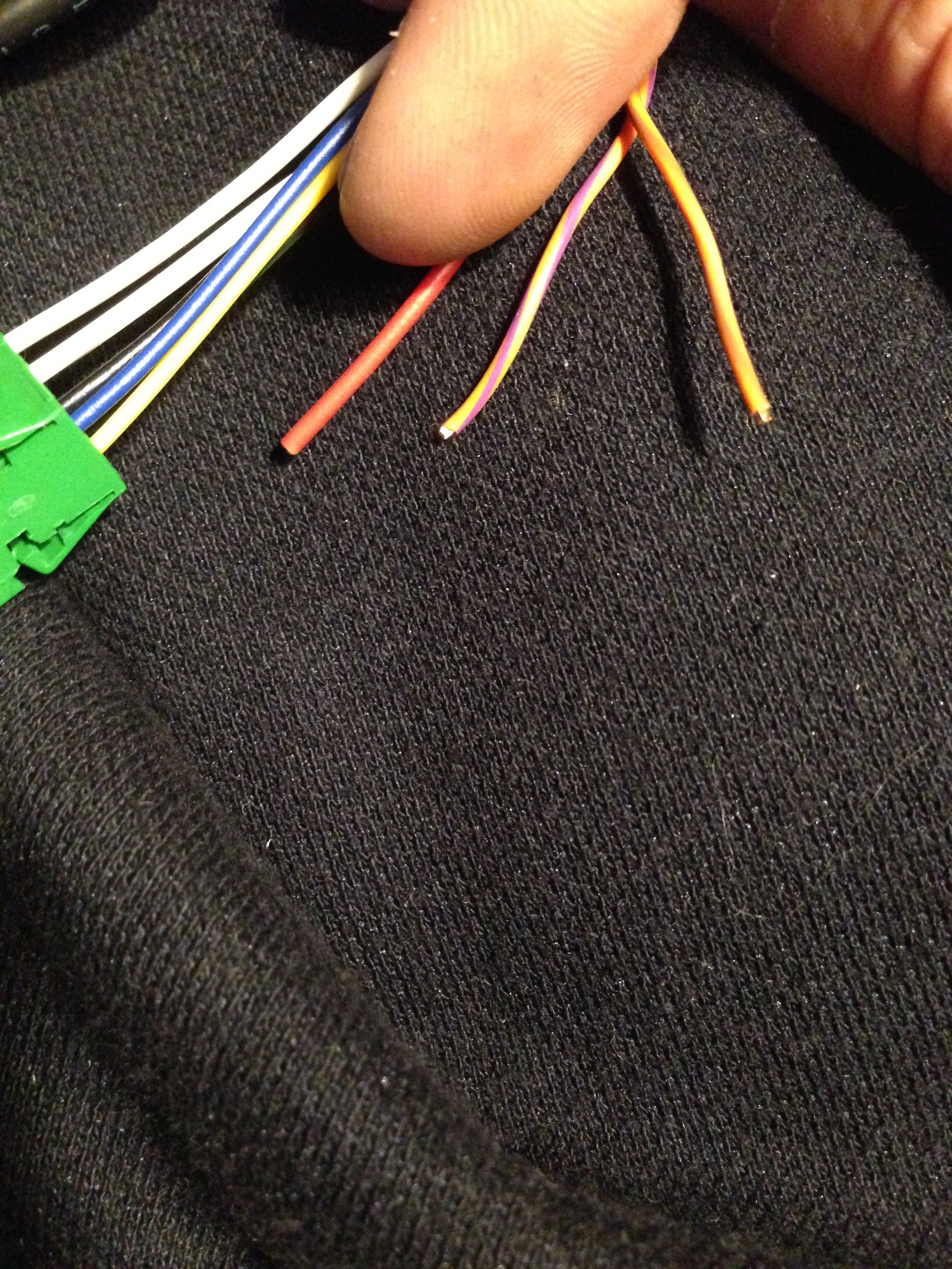

I bought a OEM wiring harness. And i ask if someone here have installed this before? i am not 100% sure how to do it and if i have to connect the orange cables to the can gateway or not.

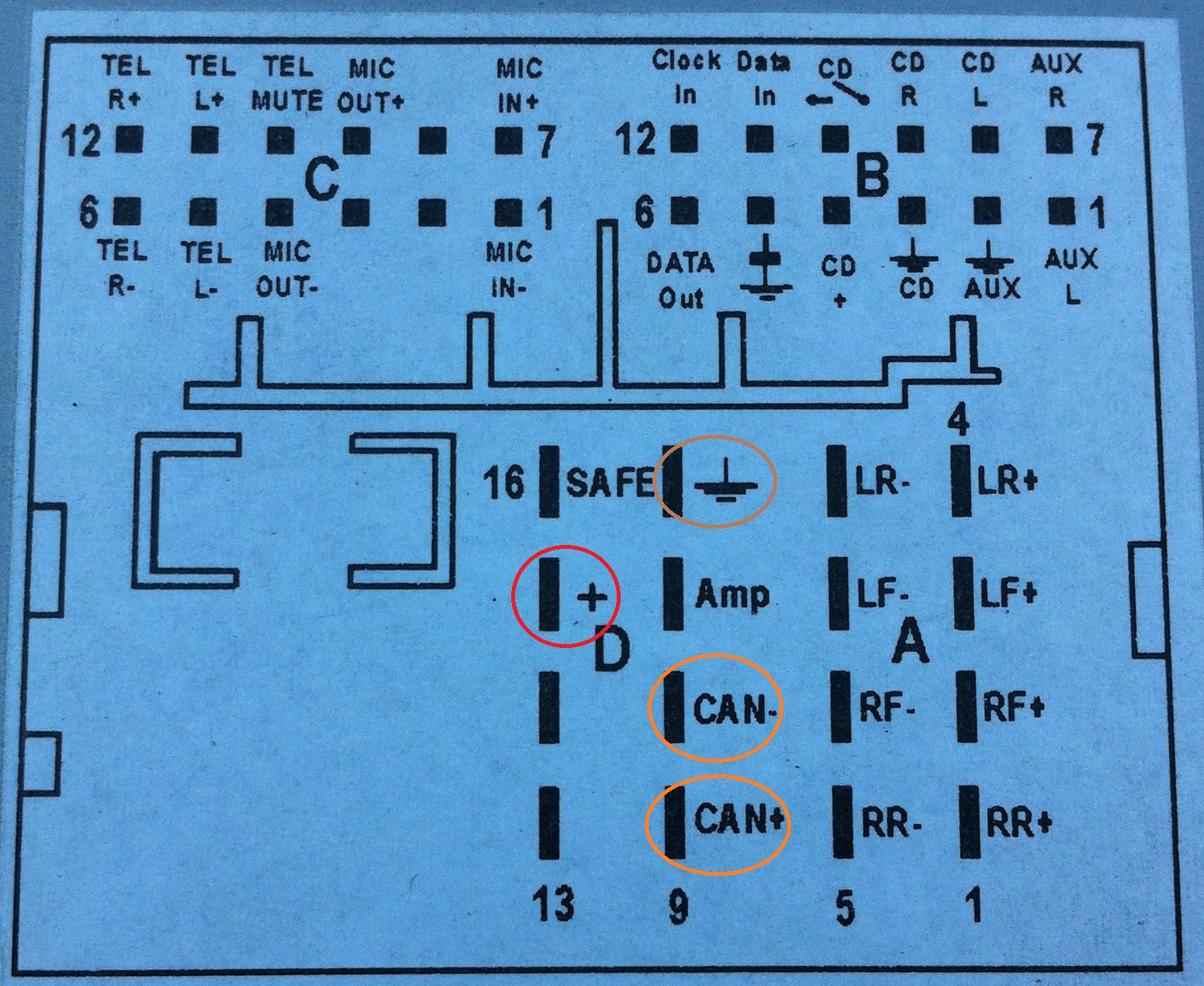

i know that the brown cable is (GND), red (+12V), and orange is (CAN signal high and low)
Is it possible to put the cables in here? :wondering:
That's what I'd do :-)
I think i gonna try that, instead connecting them to the CAN gateway ;)
