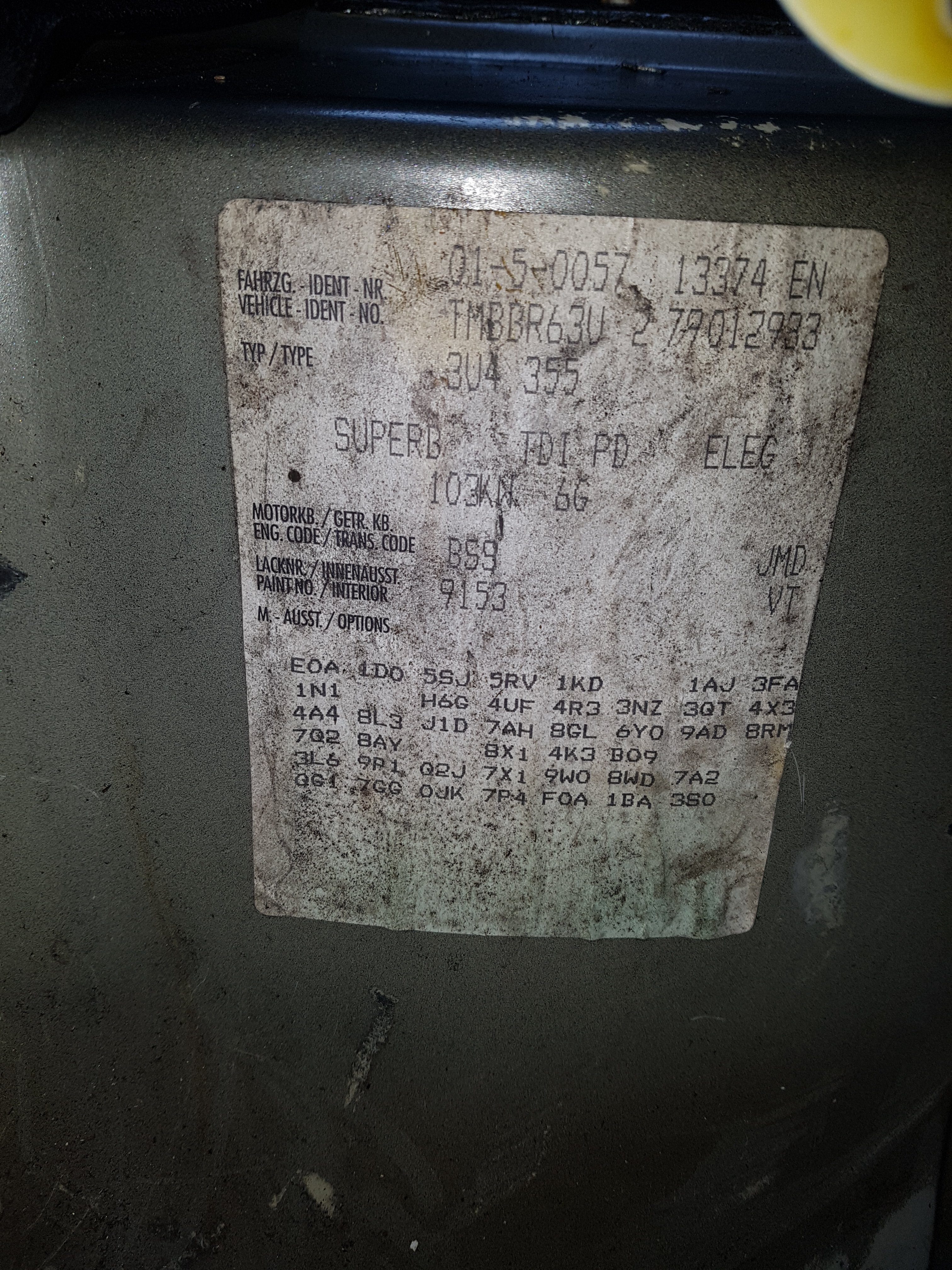

Thanks. Yes, i do have that sticker, i had a look, but it is a bit unclear regarding engine code. Ill attach picture with it, i cannot figure out that code from sticker.
The first generations of VW 2.0 TDI were PD which are 8V.

Yes, initially thats BSS engine.
