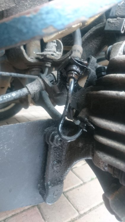

My Octavia has been drinking brake fluid & a suspicious puddle has appeared on my driveway under the rear left? (passenger side) wheel.

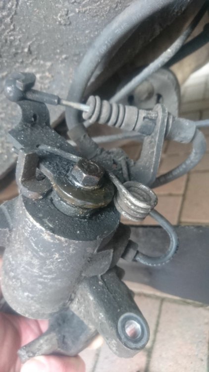

After the required blood sacrifice I've been able to get the rear caliper carrier off and it seems like it's leaking from the rear of the caliper under the handbrake lever, shown in the hopefully attached image. I assume there is no user serviceable parts in there that I can get at & that a new carrier is the way to go.
In that case whats the best method for removing the hydraulic brake lines from the caliper carrier, I've given the bolts a dousing in wd40 (other attachment), but they still quite stubborn & i'm reluctant to go much further without shearing something!

You can buy a seal kit for the calliper, however when it leaks from the rear at the handbrake actuator it usually means the actuator rod is rusted and pitted so new seals won't help and I've never seen the actuator rod sold separately.
I bought a new TRW pattern calliper for £40 delivered, no problems.
If you can't get a crowsfoot type tool on the brake line bolt use a good fitting spanner and use a pair of self locking pliers to pinch the jaws tight and lessen the likelihood of them splaying and rounding off the bolt.
Sometimes you just have to cut the pipe and use a socket to get them off and buy a new piece or make your own.

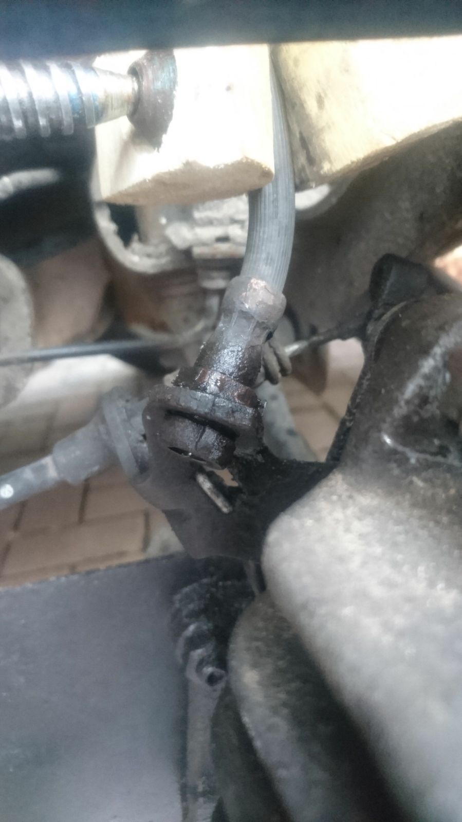

With liberal dosing of wd40 I've managed to get the metal pipe out, but now stuck at removing the hose from the bracket. Looking at the lower nut I assume I need a specialised spanner to get on it, I've tried rotating it to see if its just keyed but didn't get anywhere. I'm tempted to take a careful hacksaw to the bracket to get it out, but still need to undo it (I assume) to get it onto the new caliper.
Also how do you get the handbrake cable out of the same bracket (unhooking it from the lever was the easy bit it seems!), it looks like clips you need to press in and then push it back but didn't get anywhere. Maybe i need some beefier pliers.

To remove the hose, you need to turn it slightly so the raised bit goes through the special cut out slot
Ah, ok I've tried rotating it around but didn't have any joy - obviously wasn't trying to rotate it far enough!

To remove the hose there is a forked locking tab you need to pull straight out from the lower side then rotate/wiggle the hose end fitting free.  It'll probably be a tight rusted fit.
To remove the handbrake cable from the bracket use a flat screwdriver or similar and prise up the tabs on the locking collar and rotate it until you find the split then prise the collar open enough to be able to slide it off the end of the cable.
Replace the clip on the cable ensuring the tabs are slightly bent outwards and face away from the end so they will lock the cable in place again.

Thanks for the assistance all, the clamp I had in place was restricting the room I had to manoeuvre the pipe. Once I knew there was a slot there I could kinda see it through the corrosion, so liberal amounts of wd40 and some gentle percussive maintenance had it free.
