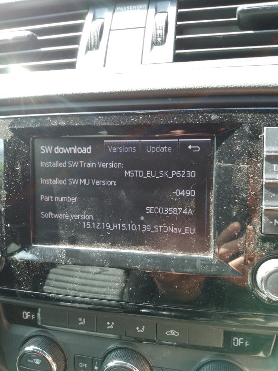

Amundsen MIB1 Firmware update finally completed - MSTD_EU_SK_P6230 MU0490
I used a copy of this MSTD_EU_SK_P6230 MU0490 if anyone else needs, the site I think I had it from was mibsolution.one is currently down though.
I was wary of the copy I had and passage of time, but it worked fine installed, I just have to clear the fault code ( have odbeleven but pro ran out and doesn't cover the adaption by looks of it)

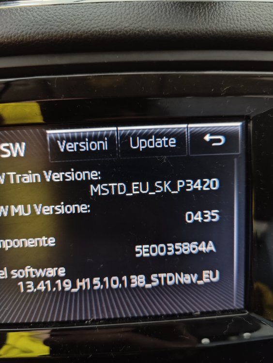

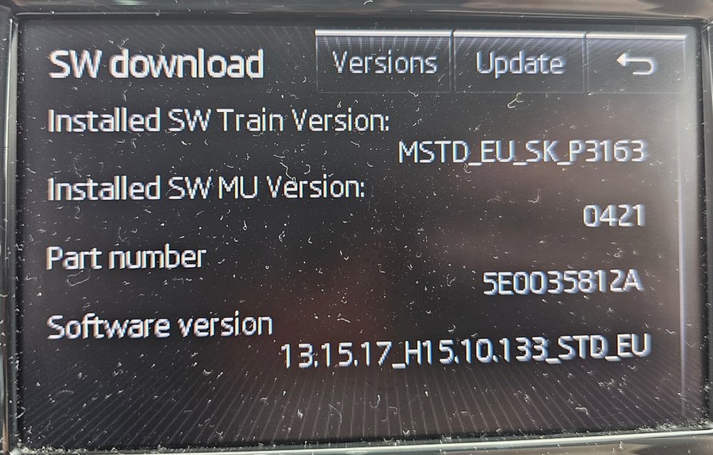

Would you be able to send to me? I have the same infotainment part number, currently on MSTD_EU_SK_P3420. Out of interest, which fault code are you getting?

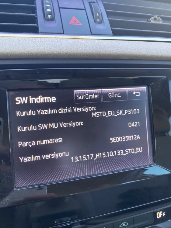

Hi! I want to update a MIB1 Amundsen in a Yeti built 2013. The hardware is H72 and the current software is 0407.
Could someone send me the update files from MSTD_EU_SK_P6230 MU0490, please?

MIB1 units have NEVER been used in yeti - only MIB STD2 PQ. You must be wrong.

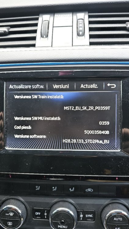

Hello guys! I have a skoda octavia mk3 2014 is my unit compatible with MSTD_EU_SK_P6230 (MU0490) firmware update?

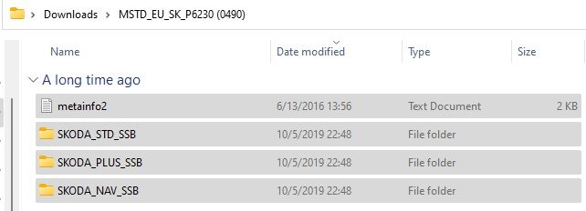

another question, how should I install it on the SD card? unzip the archive and copy the contents to the memory card or do I need to go to the root folders one by one and copy the contents from there and put it on the SD card?

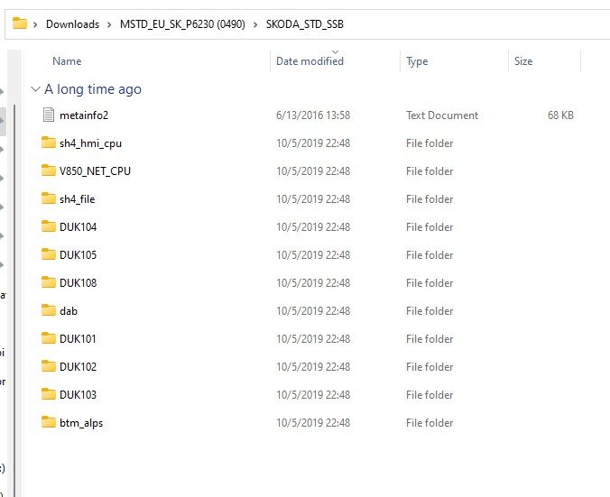

1. format SD (best max 32GB) under FAT32
2. unpack to root (metainfo2.txt and all the folders must be placed directly on SD, not in any folder)
3. insert SD card into the slot
4. enter Service Menu (long press MENU button)

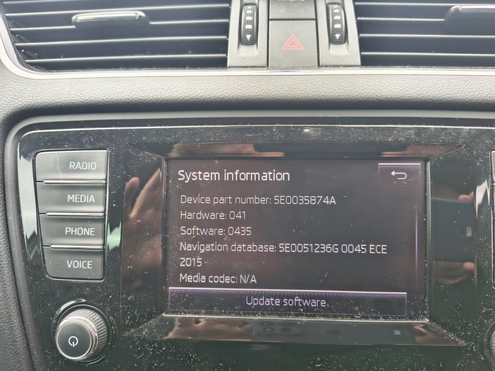

Hallo, suche auch die aktuelle Firmware für den Skoda Octavia Combi III 5E mit MIB1 (siehe Bild).
Auf /mibsolution.one kann ich leider nichts mehr finden. Kann jemand bitte helfen?
