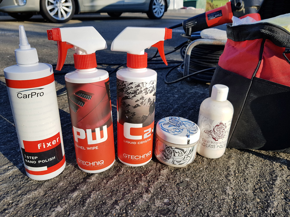

prepped the paint by snow foaming with polar frost, clayed with a clay mitt then polished with Carpro fixer, its a 1500 grit compound that breaks down at 600-1200 rpm on the DA by just polishing it out. It does leave a dust but this is the indicator that's its working.
I only had time to do the bonnet (i took about 60 mins on it) and used the roof as a comparison. I would say the compound removed 90% of the swirl. If i had more time i could have had it like glass.
i used Gtechnic panel wipe then C2V3 to seal after polishing and then two coats of dodo juice supernatural wax to finish off.
products.jpg.3ba14b1ec99d02ec8e2b2ca89bbadb5b.jpgmeteorgreyvRS.jpg.3908f1a9bf7e4ee273475745ce68f888.jpg

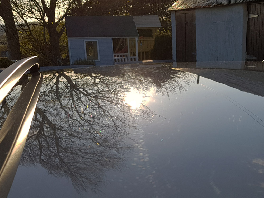

you can clearly see the paint swirl in bright light

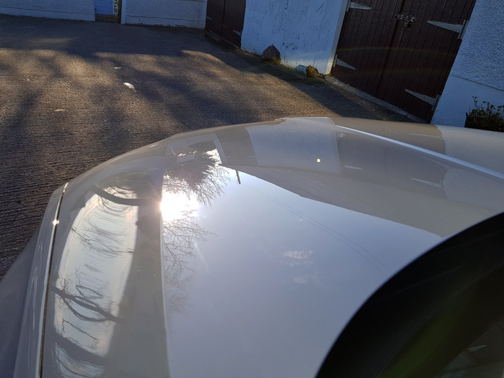

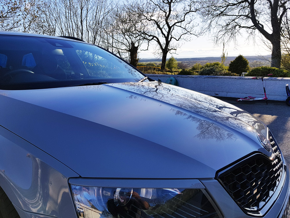

the bonnet after Carpro fixer > GTechnic PW > GTechnic C2V3 > dodo Juice supernatural wax x 2
very few visible swirls

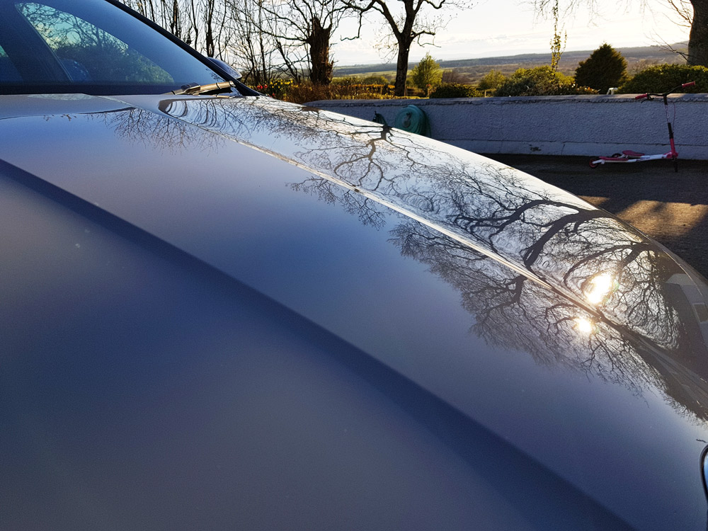

again all you can see is reflection and no swirls
In summary i'm impressed as i found it hard to find a polish that wasn't too harsh on the paint and easy to apply and could remove the swirl. I will do the whole car with the Fixer eventually as its at least a day to do it right, Carpro  good value and application is easy, just a few drops on a pad and polish it out with the DA until a light dust appears from the breakdown.
