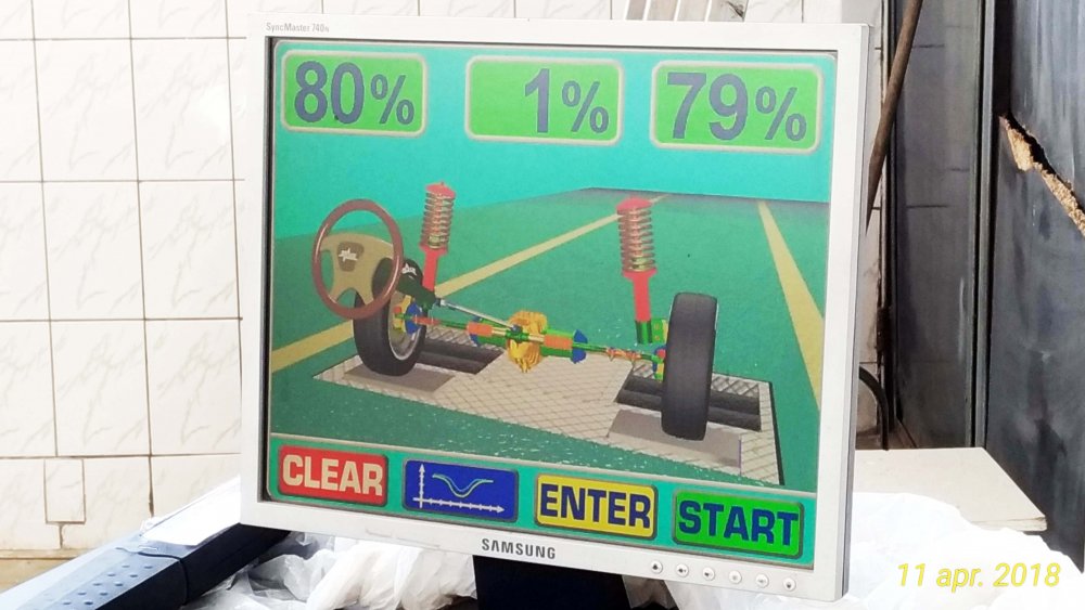

(1/3) the standard size for your car is 205/55/16 you know that and choosing a larger size will affect the stability, especially for your Superb. When I bought the new car I installed 205/55/16 Continental TS 830. Comparing with the summer 225/45/17 the behavior on highway was obvious just a little bit unstable especially over 100 km/h. Next set of tires installed were Continental TS 850, same size but tires had the XL feature (reinforced side wall). Now the car feel more stable, steering more precise and it is not a problem of suspension as you may think as my shocks (Sachs) were custom made for my car with 82 % efficiency.
I believe that choosing  larger size you will sacrifice the vehicle dynamic stability related  with over steering as the tire flexibility increase with size ratio.  However larger sizes might absorb better the winter road road icy condition  with less noise inside the vehicle and you can add stability choosing XL characteristic.
