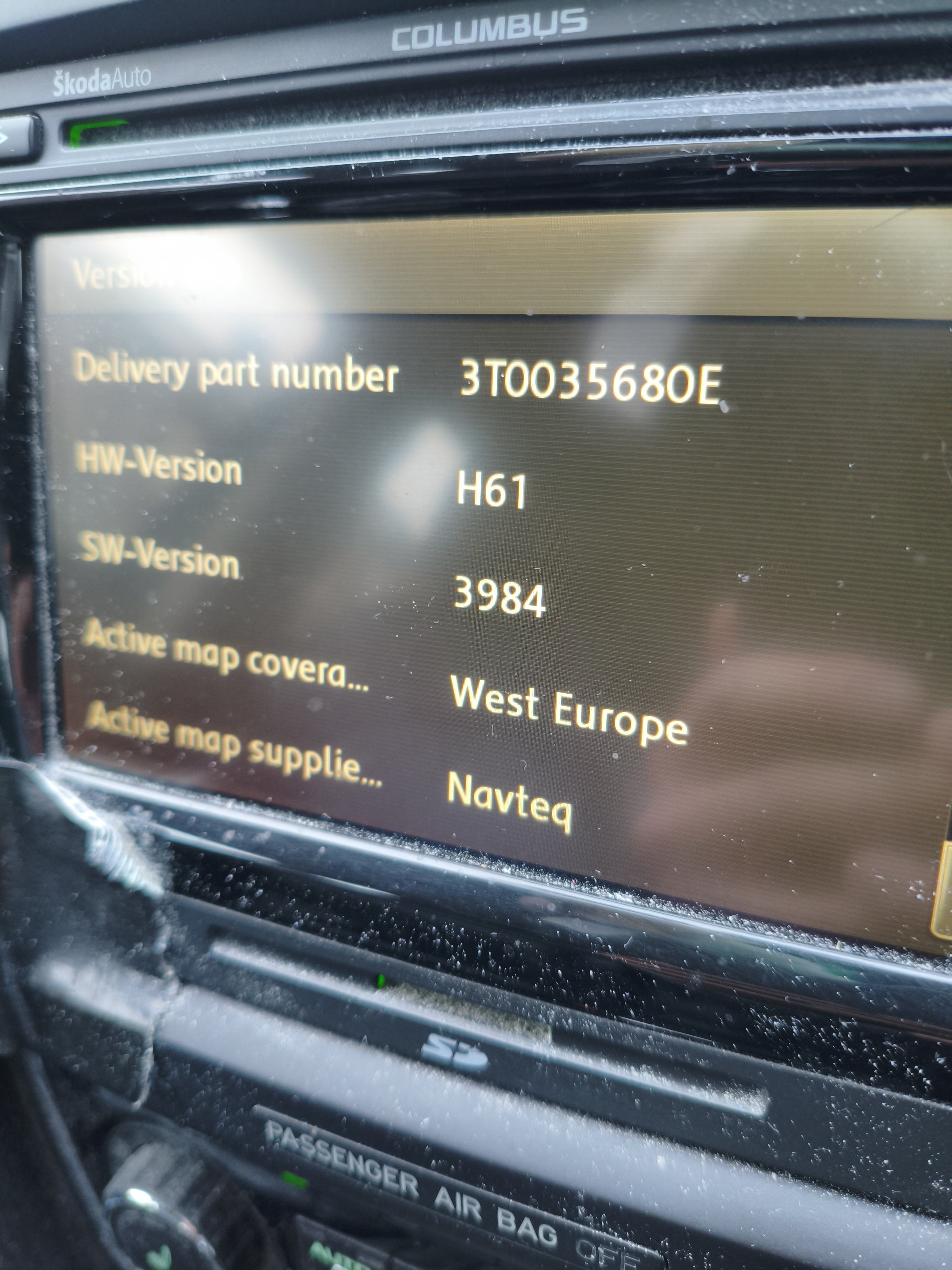

Does this help? From the SETUP button menu pressed 15 seconds. From my description, what do you think is the issue with my unit and is the only fix a replacement unit? Thanks

Why don't you think that's the correct part number? That's what the garage said. I could also try and take out the unit just enough without unplugging to see the side according to this video https://youtube.com/shorts/7R1JN-fh4Bo I've just spent half an hour trying to find a print out of every single component of my car that was given to me 10 years ago by a skoda master tech at the dealership, that would also settle it, but I haven't found it yet. I'm sure I'll find the correct box eventually

I don't know what my columbus model is, however, my garage tells me that the part number for my registration is 3T0035680BWHS (elegance trim). Basically, it is constantly resetting itself. For the first 60 seconds after it resets, everything is fine, but as time goes on, it gets steadily more laggy and unresponsive until it resets itself again. And sometimes it randomly turns on by itself. Music from my phone on bluetooth will play for a while, until it stops, at which point I can soft reset, or wait for the system to do it itself in a couple of minutes. Or when I first start the car, it is so slow the parking sensors throw a fault because the columbus is unresponsive. Or weirdly after taking a phone call, whatever music was playing before suddenly goes to max volume, but only on the driver side speakers. It's just bizzare, and unwelcome. I can also soft reset it myself by pressing 3 buttons, which I do repeatedly. It has been playing up 13 out of the past 14 days. On one day only, it was completely fine for the day. There is no fault code that is consistently showing for the radio / telephone on a scanner (carista), and some fault codes for the telephone precedes this issue, so I don't think that's it. Yes, the car is from 2012 and has done 369000 miles, so it has been used extensively. Still, any chance of a fix on the original unit? Or should I try and source a part from a breakers yard or something. Obviously, I'm unsure what's wrong.
