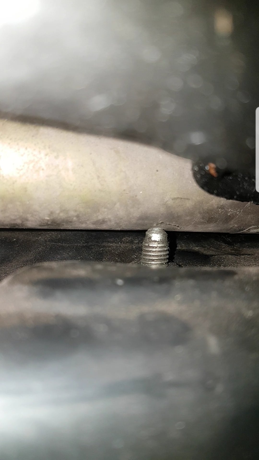

I've attatched a photo. Is this enough of an impact to cause the steering to be literally non existent one way and half and half the other way?

I'd say that's enough to cause it. Only takes a tiny dent in the outer rack tube to knack it up.
There is usually a label on the rack with a part number on it. I can see mine from the engine bay. And yes, the subframe would need dropping.

Yes, the moron mechanic has ****ed your rack.
Yes, dropping the subframe is the easiest way to do the job.
Fabias all share the same power racks as long as it matches the pump.

Bought a complete front subframe for £40 complete with pump, rack, wishbones etc. Changed the rack over which only took an hour with two fag breaks. Now it works perfectly. You can see there is a couple of mm indent on the old rack where the longer bolt fouled. Steering is effortless and spot on now. Would just like to say thank you for the help as otherwise i would of ended up changing all the steering components before the rack.

Now I know for certain it's the rack and have corrected the fault I'll change the trackrodends for new items and get all the geometry set up correctly. It became obvious that with the correct bolt in one hand and the wrong one in the other it was about 8mm too long. It also didn't have the chamfered body on it either.
