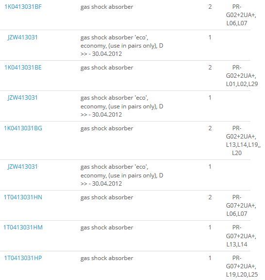

recently had my 2012 Skoda Octavia 1.6 TDI Elegance estate MOTed and passed all fine, but had an advisory on the front passenger side shock absorber slight leaking/misting on the shock.
So so was wondering if anybody could help with the part no as I would like to get a pair of new front shock absorbers fitted before long.
Thanks in advance for any help. Cheers Lee
The strut will have a part number sticker on the lower body.
Else search this forum for my post on finding OEM VAG part numbers.
Should be one of these:
Screenshot_2018-08-16 Skoda Octavia spare parts catalogue, Europe market, 2012 model year front axle, steering group[...].png
