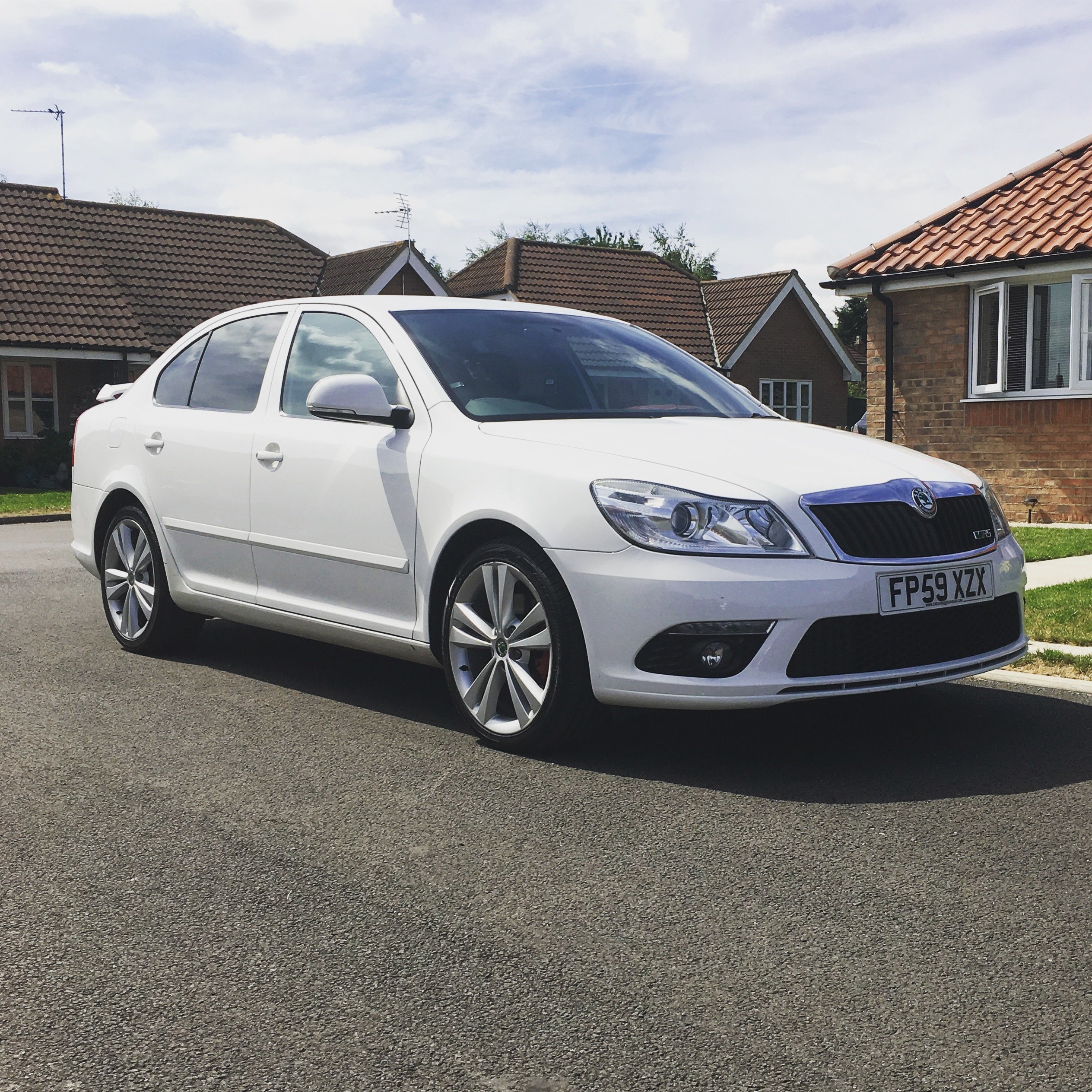

but a couple of weekends ago I bought a face lift mk2 Octavia vrs.

P.s. here is a pic of my car in case you’ve never seen a standard, high mile Octavia vrs in pretend police car white.

Pics ??
None I’m afraid. I didn’t take any as I was doing it and I had to go straight out to get me kids when I finished.
It looks just like the top pic just a bit shinier.
