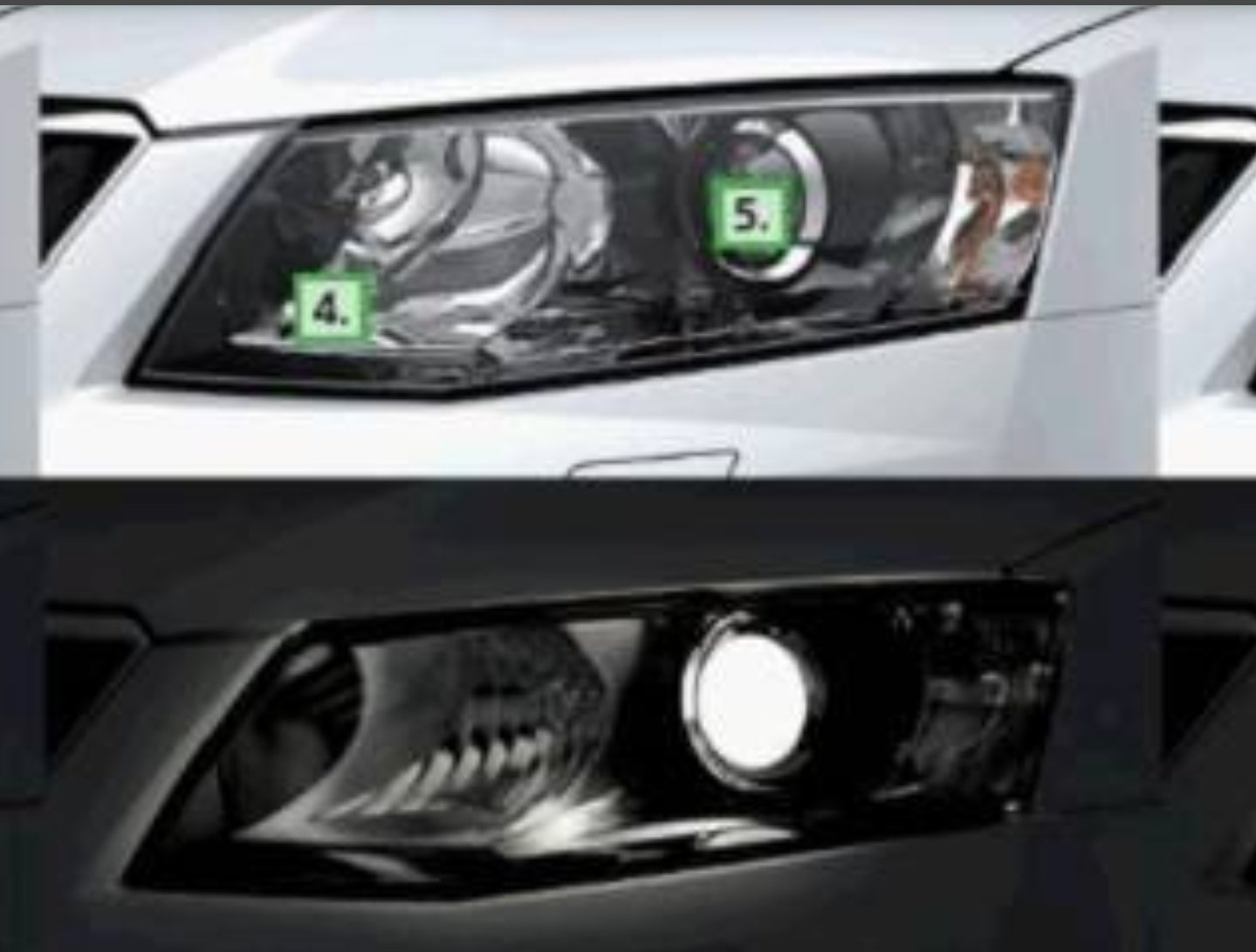

Post a picture of your'e headlights so we can see what you mean.
He basically has Bi xenon but with a halogen DRL instead of LED DRL. Middle option in image below - not sure they were offered in UK:
OctaviaIIIfrontlights.jpg&key=1d8cdc93c7
I'd assume the units should be an easy swap, plus coding of the correct Leuchte channels for the LED functions for DRL, plus the w5w sidelight but I haven't seen anyone do this swap. Functionally the rest of the headlight appears the same.

Dear Ahenners/Batvanvrs,
I have headlights version 2 (picture attached), xenon with halogen daylight.
It will be very helpfull if someone have made mention swap so i would know 100% that is working before i buy a new headlights.
