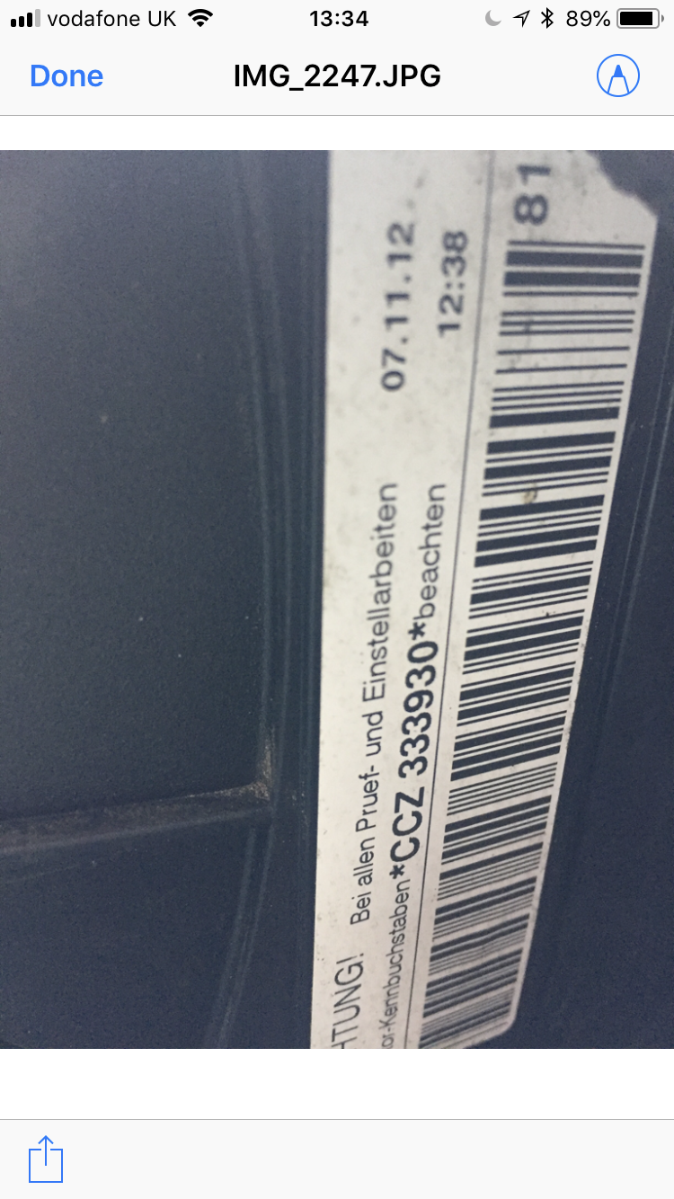

As my newly acquired 1.8 tsi elegance appears to be burning oil I’m looking for a possible replacement.
will this 2012 vrs have the latest tensioner? Are there any other problems I should be aware of?
i like driving the tsi but not keen to take on a money pit
That should have the latest revision of the chain tensioner as that was fitted from mid 2012 onwards, the revised tensioner can also be fitted to earlier TSI's along with a new chain set (3 Chains in all) and kits all available at good prices.
