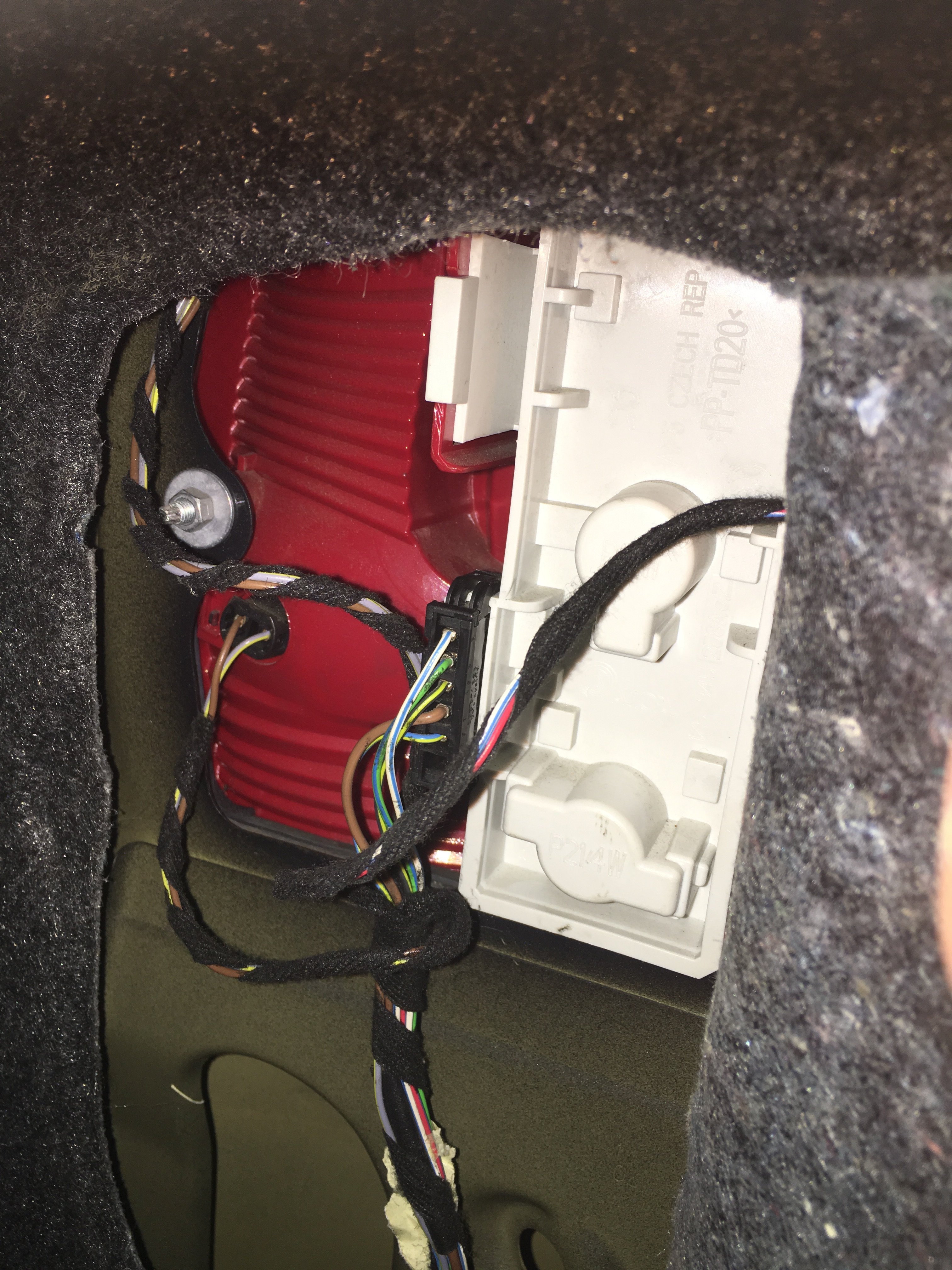

ITs not so clear for me, but from the picture where i should attach the positive cable of the camera? Anyone can help?
The white bit unclips. You should be able to see which wire connects to the reverse bulb.
Failing that, use a multimeter.
 Removing it doesn't help so much because actually the cable doesn't  go inside the white light bulb holder. I will try to see again
