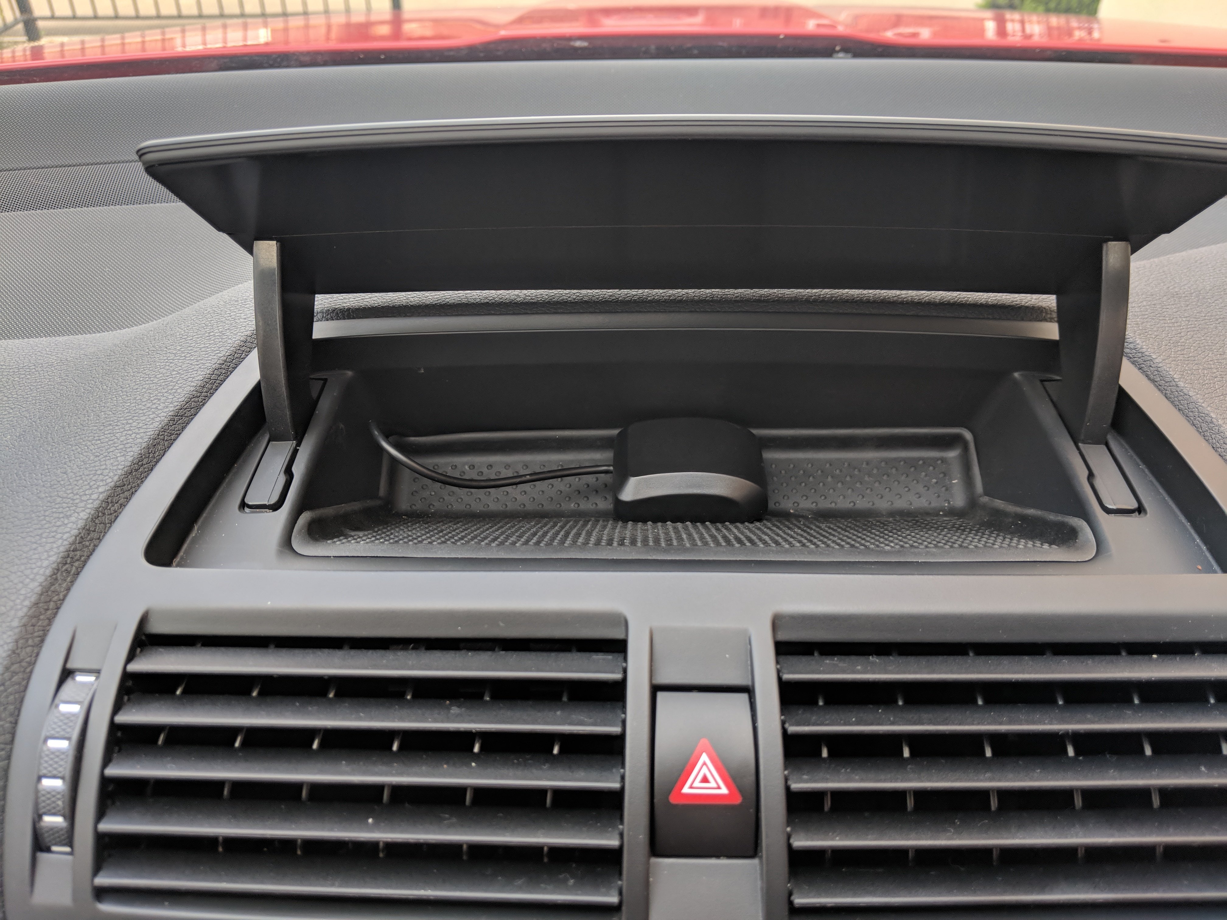

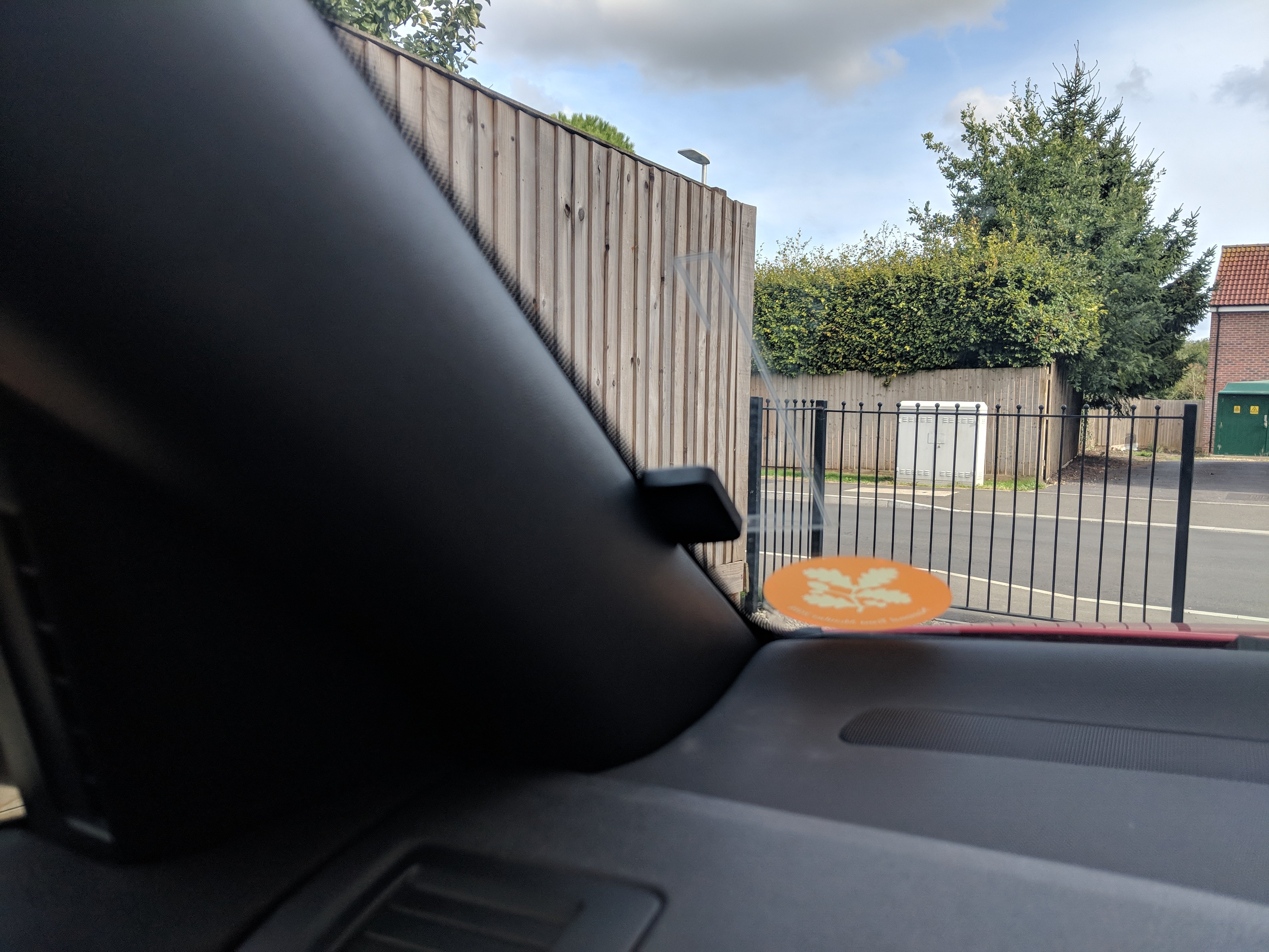

I have put the dab antenna on the n/s a-pillar but towards the bottom. The dab+ box is double sided taped to the inside bottom of the hole in the dash where the head unit goes. GPS antenna has been put in the top cubby.
