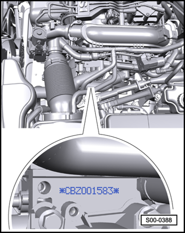

 Ok guys please can you help me out a bit. I am trying to check if the engine code is one of the affected ones but  all i can get is the code CBZA MFX  . There are no numbers on the side. The  vehicle number is  5J C3054116
 The guy from the dealership told me that this car is not affected but I have some reasons to not trust him
 Is there a way to check this by myself?
 Thanks in advance
Mfx is the gearbox code.
You need an engine number not a chassis number.

 Ok thanks by the way for the reply i just saw the picture. Tomorrow I will be there, so i will ask them to give me the engine number or check it in front of me
