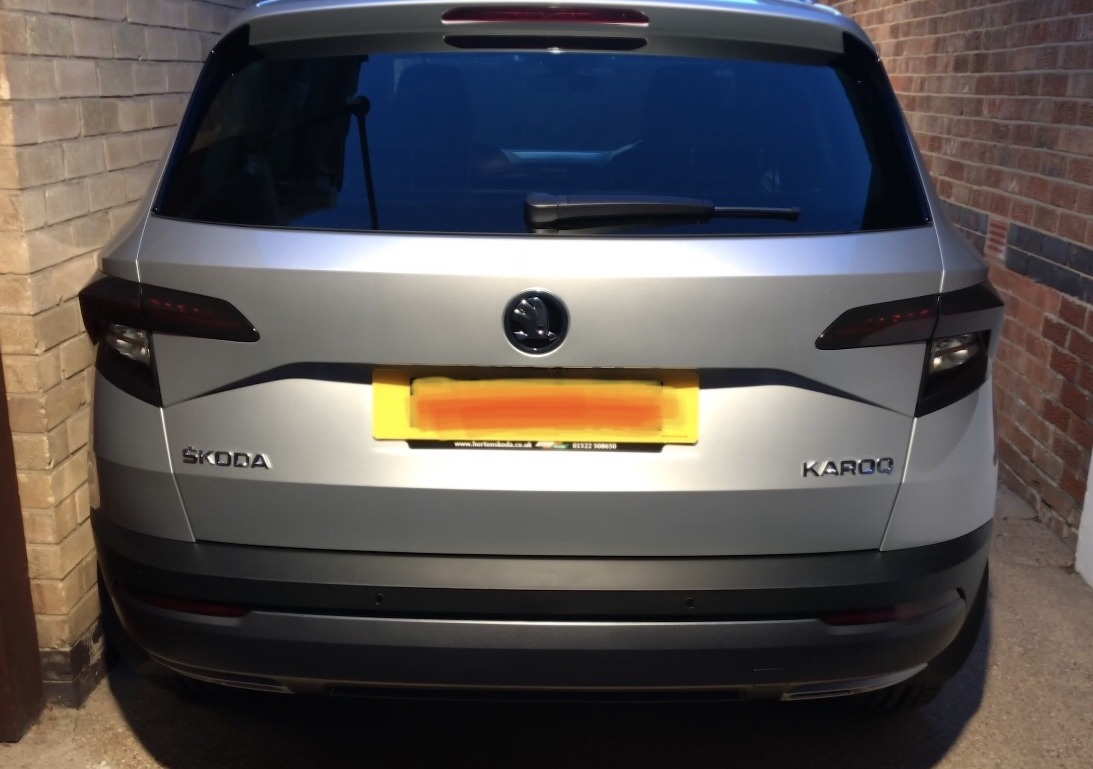

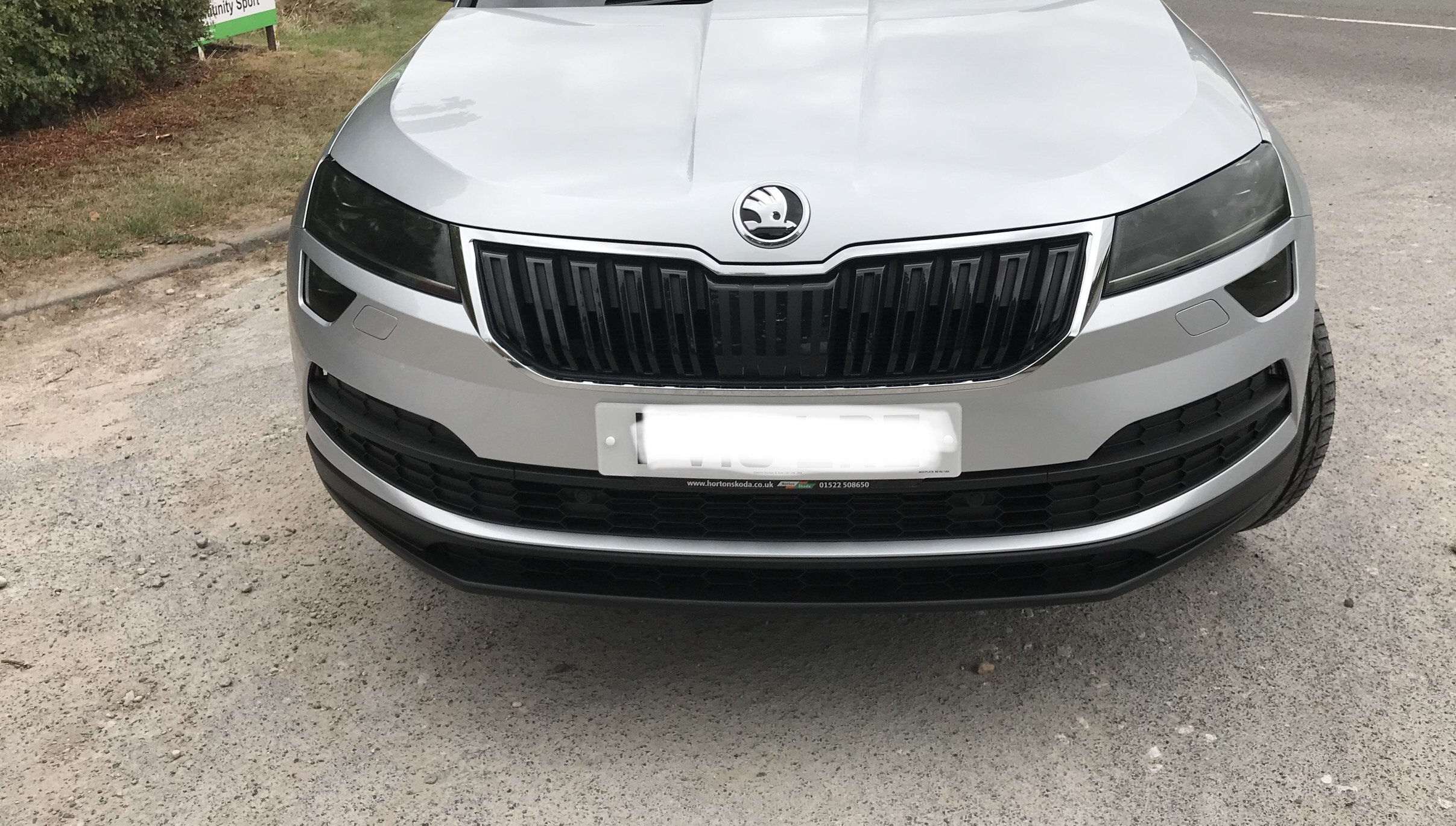

I think this looks cool, I’ve replaced the wing mirrors to black on mine with blacked out rear and front lights, also changed the rear letter badges to black
Do you have a photo of yours?
That looks really good, how was the tint done and how much was it if don't mind me asking?
Thank you, the tint on all front lights were the lightest shade to keep legal and dark tint on rear with the indicators Ann reverse lights left clear. It cost £120.
