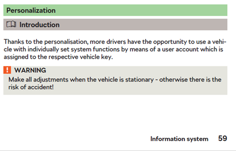

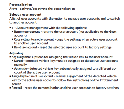

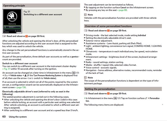

One way of dealing with it is to set up personalisation. The extracts below are from my MY17 manual, but it will be very similar.
When you make the changes next time, you need to save them via the seat memory. Then each time you start the car it will remember your selection.

Personalisation via the infotainment is as per the manual extract above. You need to create a profile (which will appear in the maxi-dot when you get in the car) and assign it to a key-fob. Pressing "set + 1" or "set + 2" at the side of the seat is part of the process for the profile you have created, but the most important step is to assign the profile to the key-fob once you are happy. From memory there is an option "assign key to profile manually" (or something like that). Press it, and it will ask you to press the unlock button on the key-fob. That is what allows the car to recognise you from the fob. Then create a new profile and do the same things, using a different profile name and key-fob, for your lady. You can copy your profile to hers as a start point if you want. Remember to save her profile to her key-fob manually at the end.
Once this is done, when you choose your profile from the maxi-dot (by pressing the right hand scroll wheel) it will, if you weren't the last driver, ask you if you want the seats etc moved to your settings. Hold down the right hand scroll wheel and it will do so. It should also remember the other personalised things you want (ACC distance, Lane Assist etc), but sometimes it doesn't until you've re-activated them a few times.
If you don't have personalisation set up, setting your seat etc is done by putting everything where you want it, then pressing "set + 1". Your lady would then set it up how she wants it, and press "set + 2". But (and this is the big difference) doing it this way will not automatically update the other personalised things you might want.
If you do have personalisation set up, pressing "set +1" will make it remember any changes you have made against that profile. In this case you and your lady each have three possible seat settings, not 3 between you.
