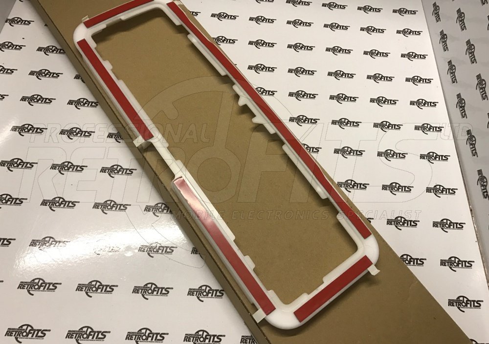

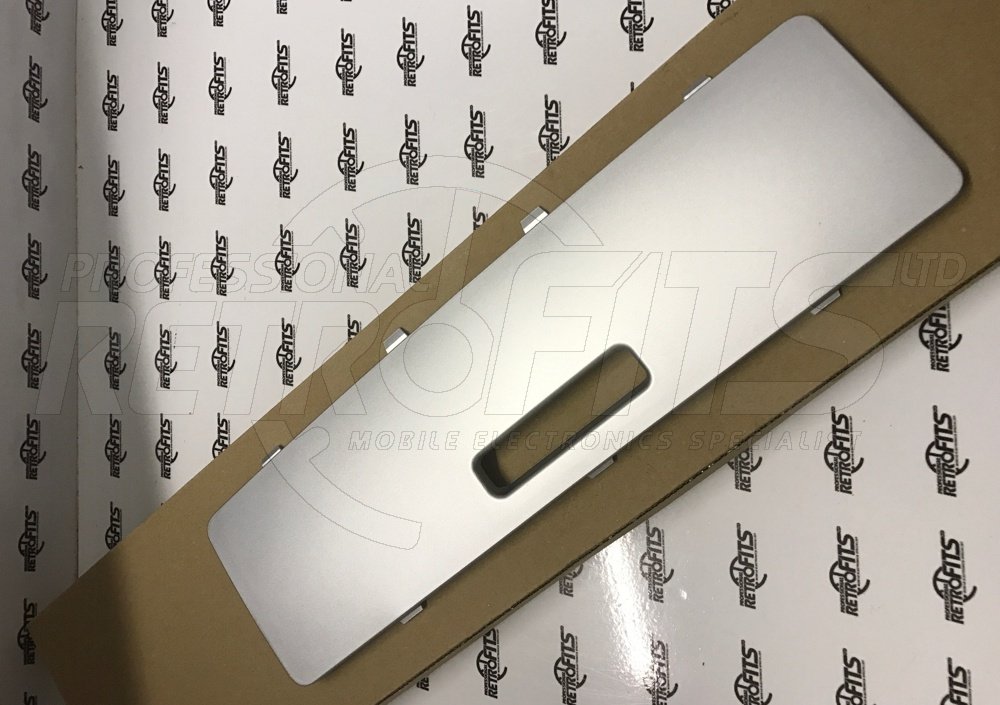

Measure the existing hole, if it's smaller than the one on the Yeti then buy one of these, get the tow bar fitter to increase the size of the hole, and paint the cover...
http://www.vag-shop.co.uk/skoda-yeti-removable-towbar-bumper-cover.html
It has a frame that fits to the bumper, which the cover then clicks into...

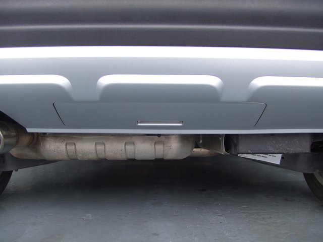

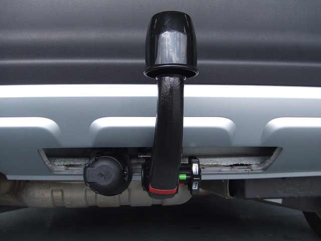

just get a Rieger diffuser and job done, heres mine with the Westfalia removable tow-bar fitted...
three little screws to hold it on invisible when on the ground.
you can barely even see the hatch
