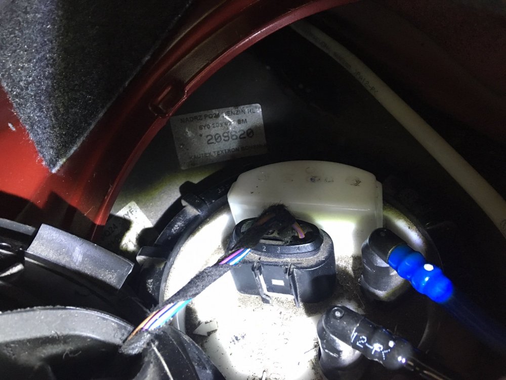

Fabia 1.4 fuel pump connector removal
I want to replace suspect fuel pump, and need advice on removing the electrical connector.
Looks to me as if someone has been in here before — I can't see the usual tab to press to release the connector, and I think I can see where original plastic has broken away.
What's the correct way to remove this without damaging integrity of the locking mechanism?
Thanks a lot.
Edited by Stratfordade
All ok, used a little hook to move clip over tab without stressing it.
