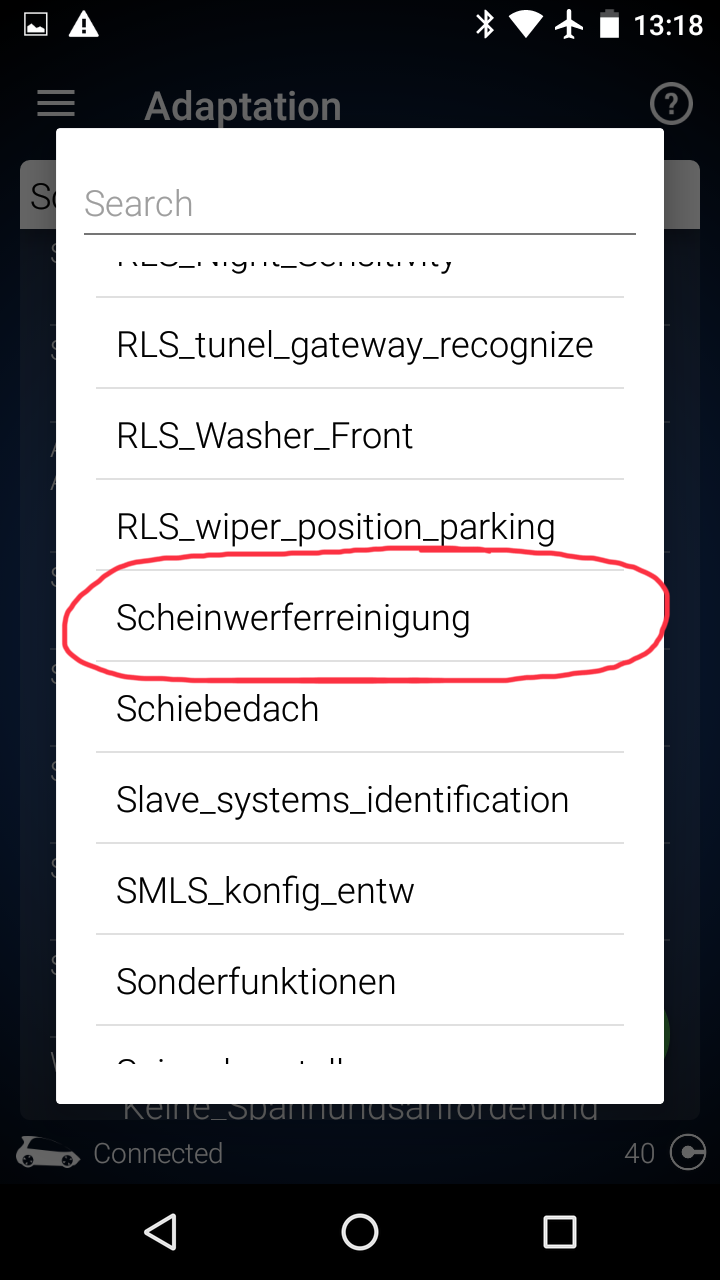

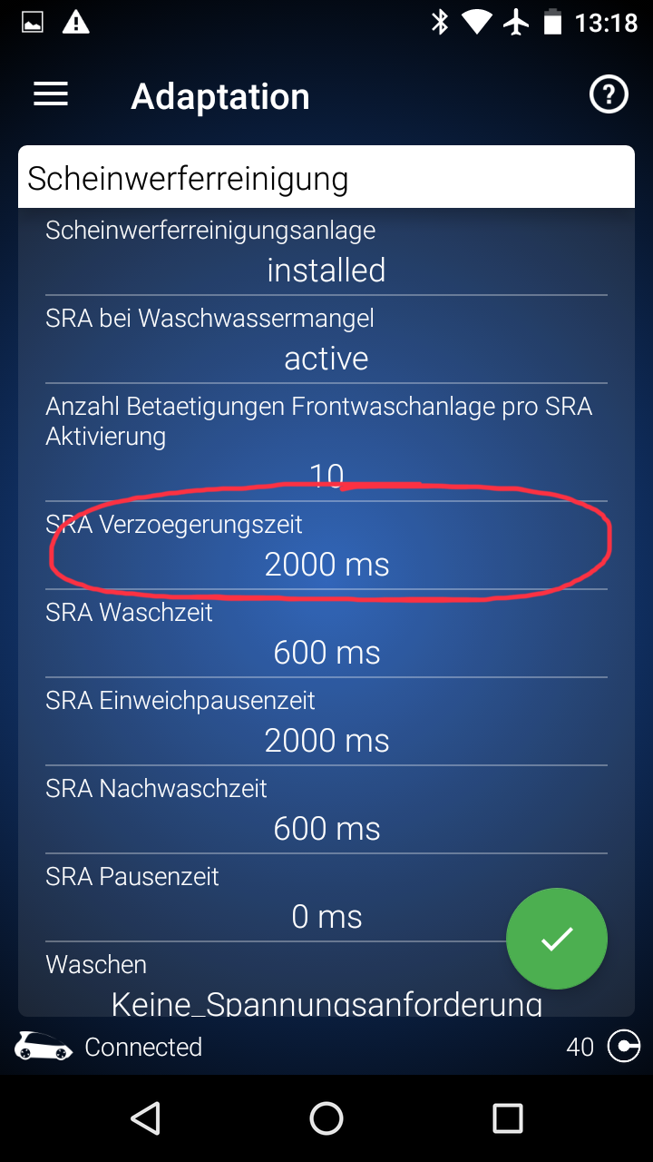

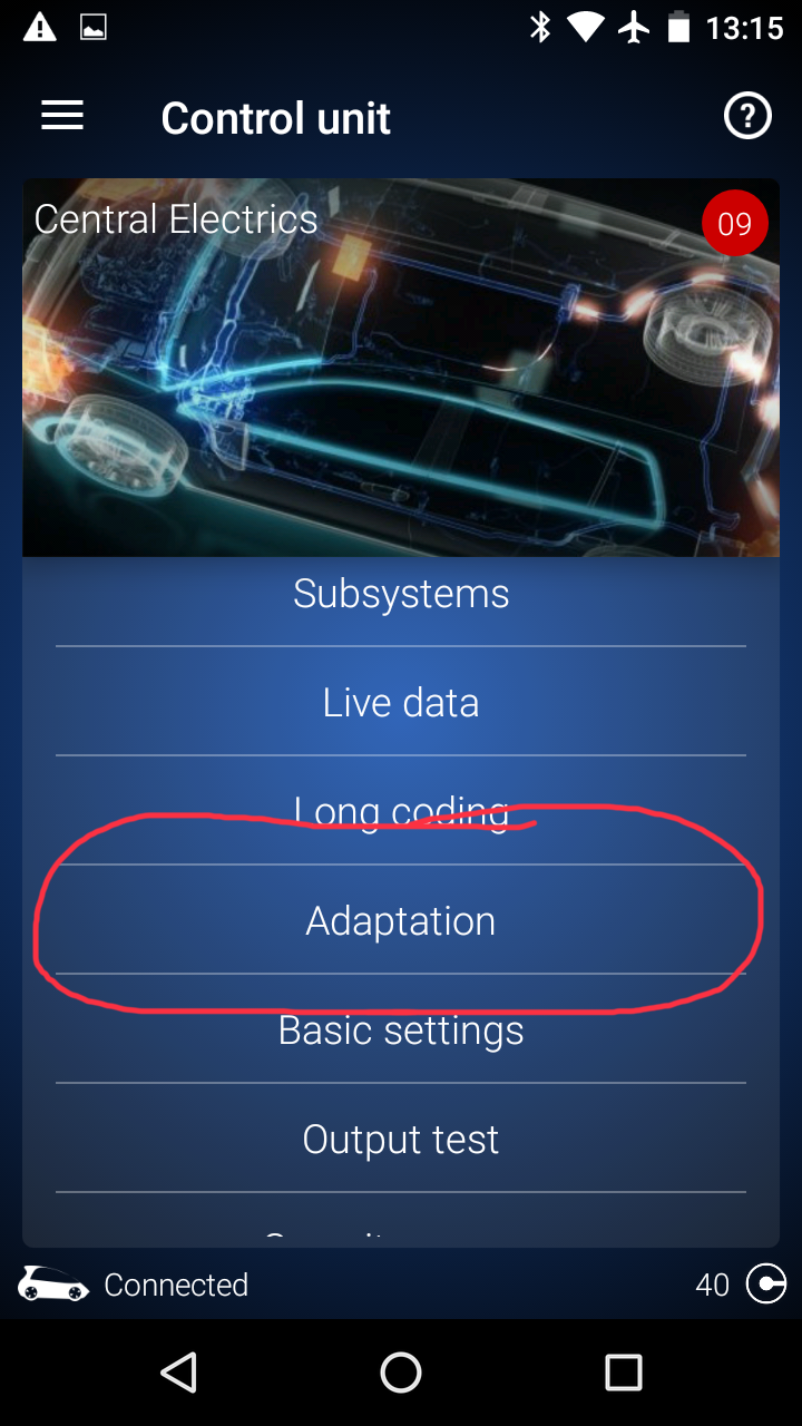

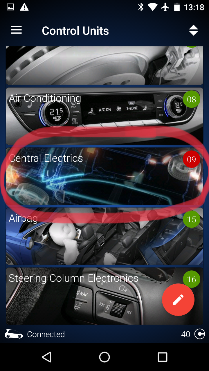

Here is a guide to changing the headlight washer delay.
  1. Select ‘09’ Central Electrics
  2. Select ‘Adaptation’
  3. Scroll to ‘Scheinwerferreinigung’.
  4. Change the value under ‘SRA Verzoegerungszeit’ from ‘0 ms’ to ‘2000 ms’.
  5. Green tick to Confirm
Hi thank you it worked like charm.Thanks for doing it so quickly.
