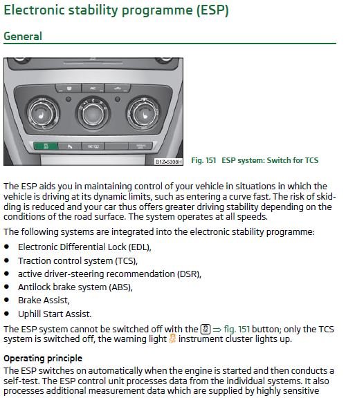

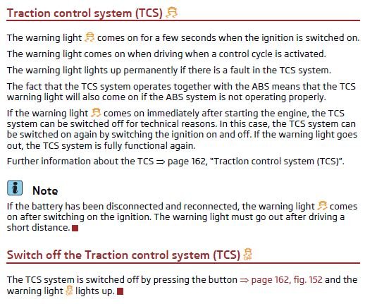

Hello guys , i have a Octavia 2 FL vRS 2010 170hp , when i press to deactivate the TCS it flashes in dashboard doesnt stay still , is there any problem or something ?
Pretty sure it's normal for your age car :)
I wasnt sure if its a problem , thanks for the help!
