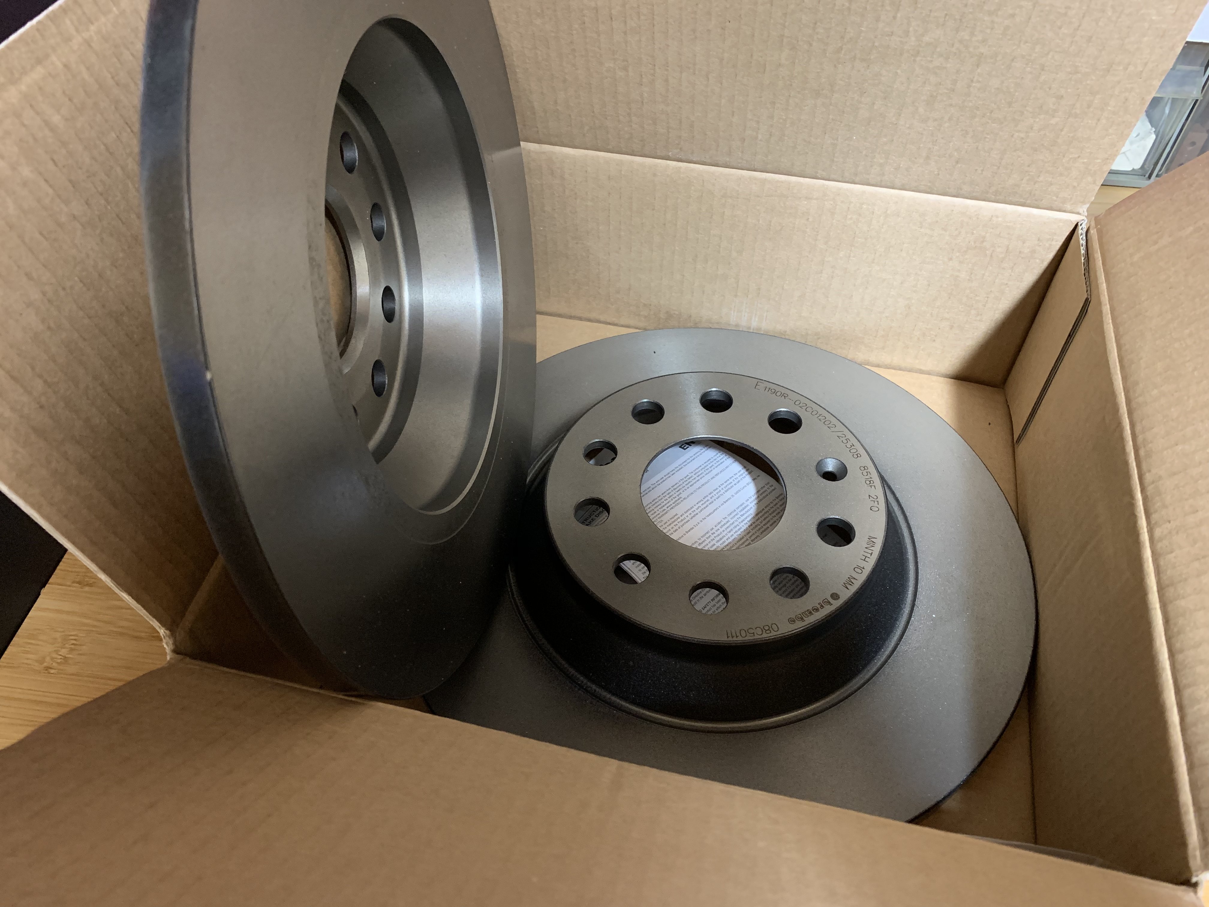

I have just bought my new rear discs and pads from ECP @ £84.13, that is for Brembo UV coated (so they shouldn’t rust) as my rear discs are in a shocking state... never been good from a couple of thousand miles) OK I have 52K miles on them, but I usually get over 100K a set of brakes due to my driving style and routes, you can usually get though one set of discs per two sets of pads, on the MK3 it seems that the discs are completely shot and the original pads are just half worn.
Cheaper ones are available but I'm hoping the Brembo’s will wear ‘normally’ and not like the OE ones do.

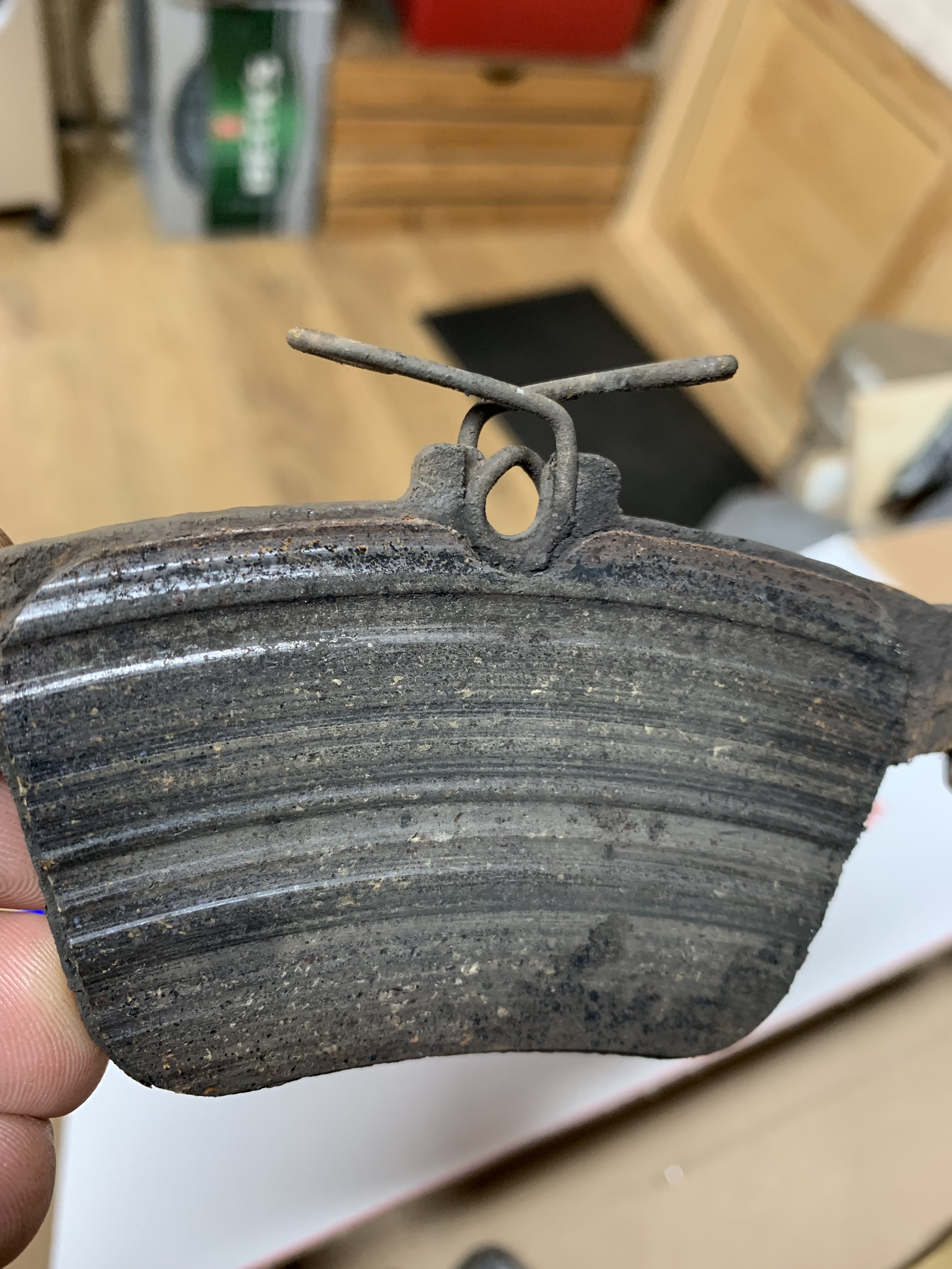

When I have an OEM (280 PS) setup, I went into Zimmermann flat discs and EBC Yellow stuff pads for both axles.
The abnormal wear disappeared, but due to overall bad performance I went to big brake kit in front from Merc ML
Since then, all the problems went away.
The rear disc looks like that after 18 months and c.a 40.000 km.

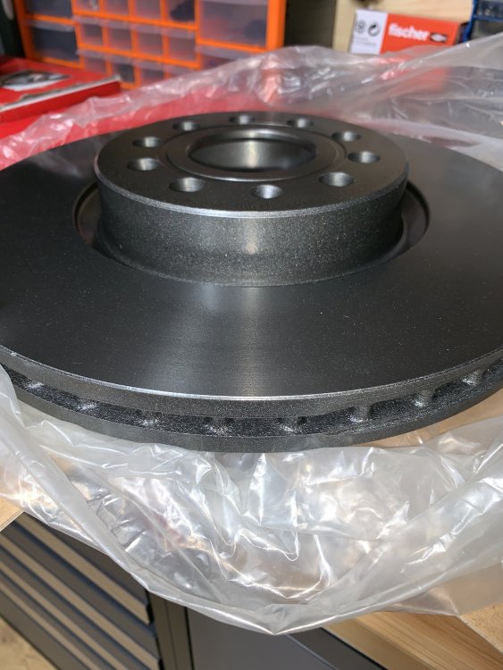

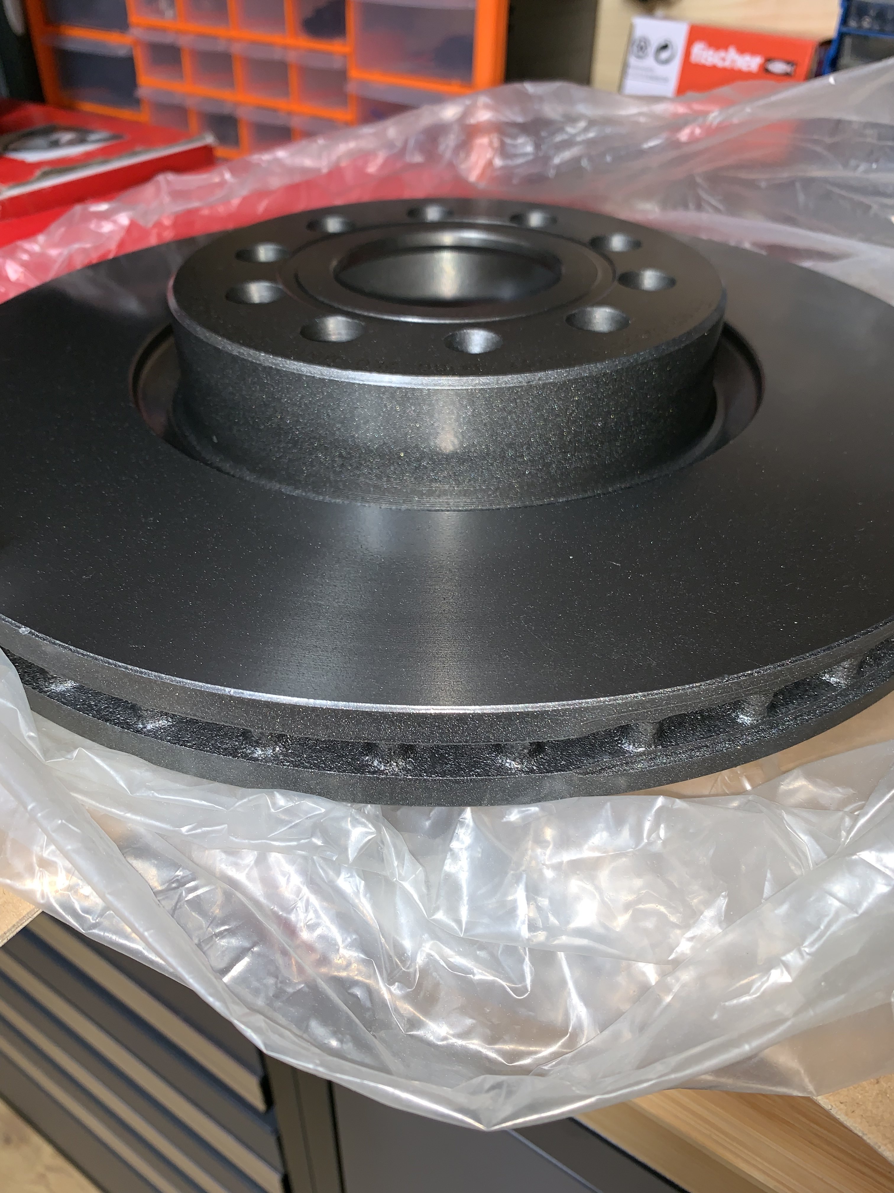

On 16/02/2019 at 12:33, Gizmo said:
This is the ‘good’ one
Picked up the Brembo’s today and you can see why the cost a little more (UV coating on the to prevent rust)
81BBF9B0-CC36-4EB5-A703-3C07486BD4A8.thumb.jpeg.98b4a04fe954addc1ad1fa326413fcbe.jpeg5A2A8C39-58A1-44F4-B18F-87FC3D03424F.thumb.jpeg.667a5c193c1417e6483ae029568e6687.jpeg

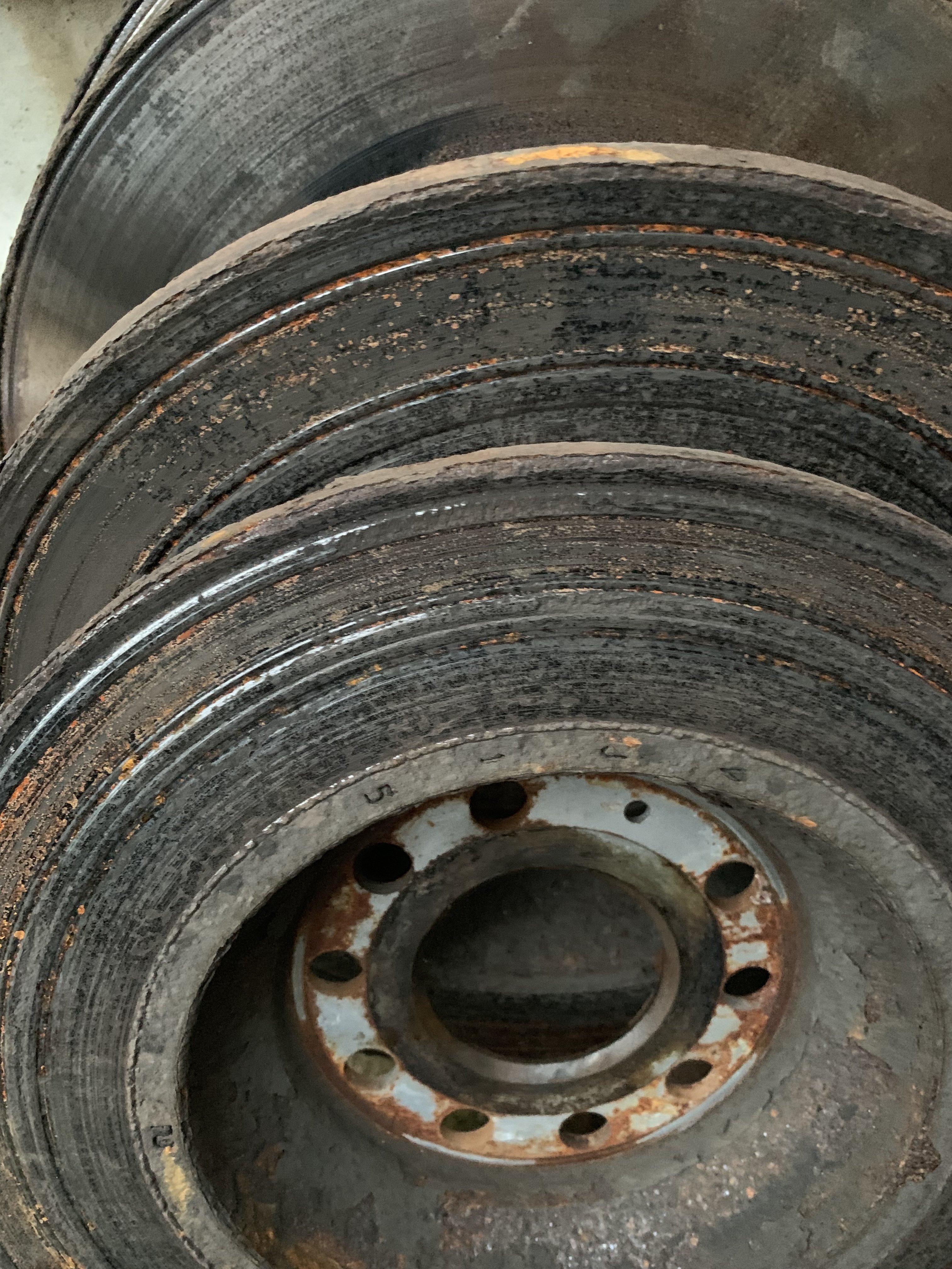

and the inside of the rear discs :o :crying:
Reassuring skoda allow this quality on their vehicles which may be transporting you and your family.
Maybe braking performance is not affected by the rust?? Which is typically the default response by the skoda techs, but the discs are clearly perishing.
Skoda dealers and techs should hang their heads in shame when they see discs like this and comment that it's normal wear and tear.
