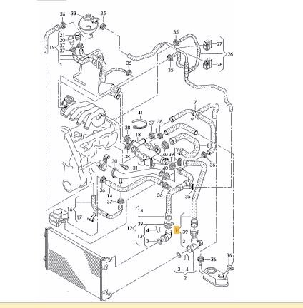

Hi Wino, thanks for that. I looked at 7zap.com and found the engine. It is a 1.6 litre AVU. I rang a few motor depots but they didn't seem to be able to help. I then rang a Skoda dealer who sent me this link which is the same as 7zap  https://www.partslink24.com/vwag/skoda_parts/illustration-mailing.action?mode=K0LWRGBGB&lang=en-GB
They said I needed assembly number 19 shown at the top left near the expansion bottle. Price £117 plus VAT. I'm going to see what I can do. The leak is coming from the connection at the thermostat end so I am looking at just cutting the hose back by about 25mm and reconnecting it with a new clamp. The other alternative is to buy a metre of 20mm hose and try and route it without kinking it.
