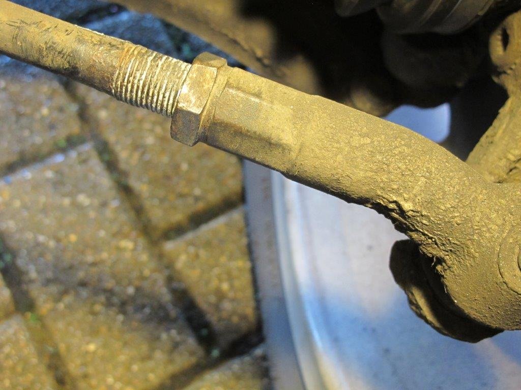

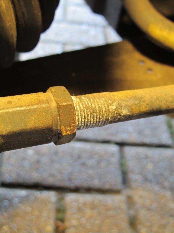

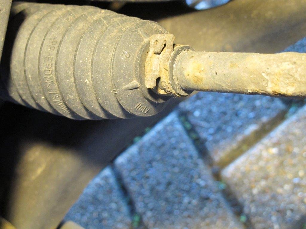

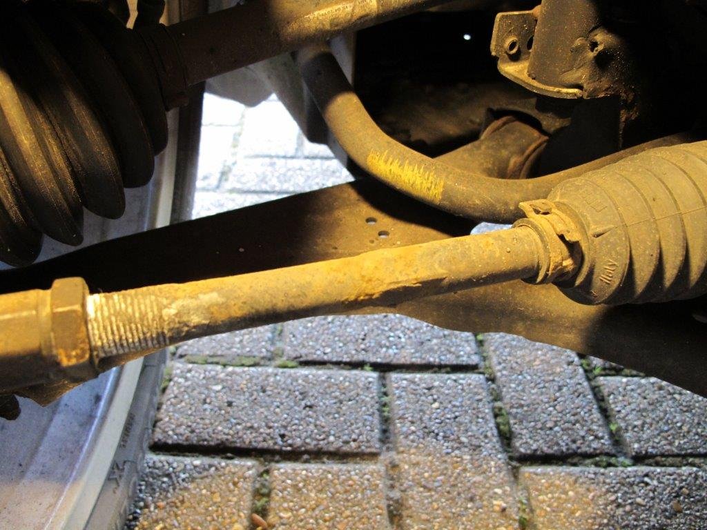

Just taken in the Mrs Yeti 110 for a pair of new tyres for the rear having moved the old rear ones to the front. After waiting a long time the chappy came out and told me that the tyres were badly scrubbed on the edges of the old tyres and that the tracking was out. Pointed out to him that it was equal wear to both tyres and our main dealer had not commented on the problem having had new front discs fitted and they had covered some 55,000 miles. Told well you could be wrecking your tyres leaving the problem there. Eventually buckled to his hard sell and waited around 15 min s for the job to be done. Charged £47 and told they had been adjusted. Once I was home I put on full lock and noticed a quick spray of white grease had been applied to both tracking rod threads. Being rather a negative chap I rubbed off the white grease to have a look at the rods on both sides. I cannot see any spanners applied or grit and corrosion of moving a nut around on either side. Phoned them up on the same day to complain and was told they use special tools not to damage the rods and I could bring it back for a check having taken my money.
 Now if the tracking is very close to spec of course they will not need to change anything and the wear on both tyres could be the actual position to vertical over the years on the ball joints and not toe in or out.
As this company has other braches in East Anglia I would like any useful comments on what to do next as I suspect it will end in a stalemate with the company over work done. Can you adjust the tracking without showing any evidence?

I know of NO way those nuts can be undone without marks being present, and there are no adjustment marks on the threads either.
I would be threatening to show those pictures to Trading Standards first thing on Monday morning and insisting on my money back.
They've done nothing!
Looks like a wire brush has been swept over the flats!

Rear tyres were ok with decent tread all round after 55,000 miles and that is why I placed them on the front with 5mm on them. It was the front ones that had worn badly on both inside edges that were thrown away for new Michelin Cross Climate tyres. Was worried about the camber on the front as the offside front suspension spring had cracked near the bottom but I was told the camber was in spec. You are correct a brass brush had been used after all the winter salt/grit by myself plus a rub down with WD40 on the rods eight weeks ago while I was checking the rubber boots on the drive shaft pre MOT checks.
