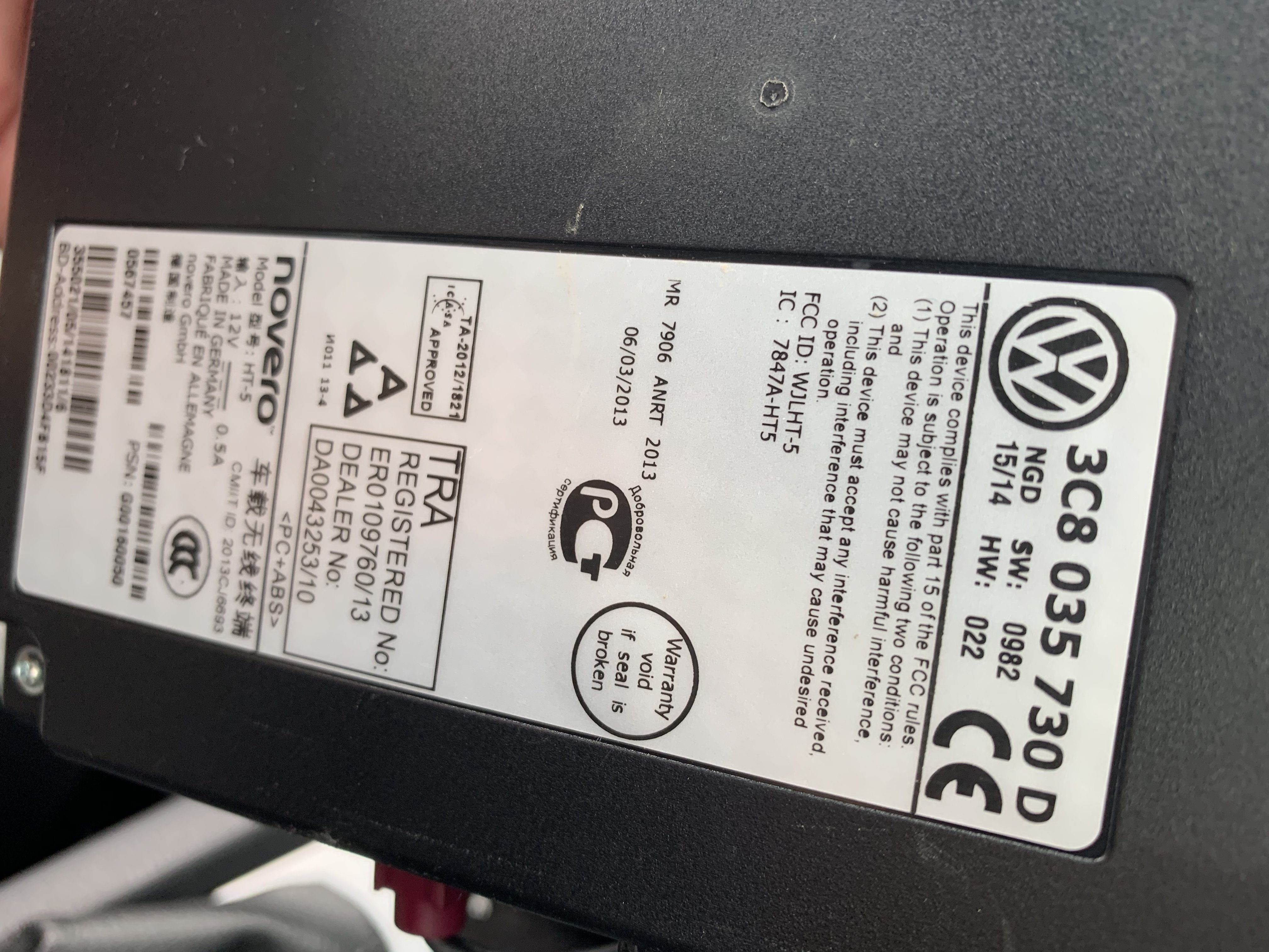

Ok so took out the head unit and heating controls and found this black box see photo. I have unplugged the big plug and put back in and also unplugged 2 plastic see through connectors too and put back together still no Bluetooth.. could the black box be dead?
That's definitely the BT module. It could be dead but I don't think I've come across one failing before.
Might be worth finding someone with VCDS to take a look and see if there are any clues.
Other than that, it's worth finding the pinout for the BT module to check it's getting power, ground and can-bus.
