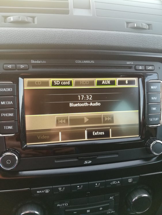

Hello, i own a 11 fl octy. With original Columbus unit. I can connect to it via bluetooth. But I cannot skip the song, not on the steering wheel, not on the headunit itself. I got spofify premium so thats no issue. How can i fix so im able to skip songs?

i checked with Deezer. nothing. shows this only. can control volume, but thats it
At a guess, the BT module might not support it as it's not showing track info either.

The BT module is the telephone module on VCDS, so in your case it's 5N0 035 730 A. That's quite old, possibly from 2008/2009, I don't believe it supports play/pause/skip or track info and track info.
I'm not 100% on this, but I believe you need a BT module from around 2012 onwards to get those extra features.
I know it track info/skip for me with 3C8 035 730 D and 3C8 035 730 E modules. Not sure if any other 'premium BT' modules support it.
